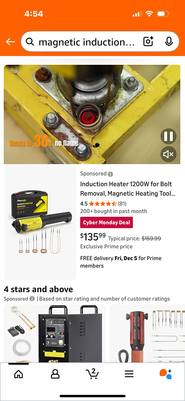

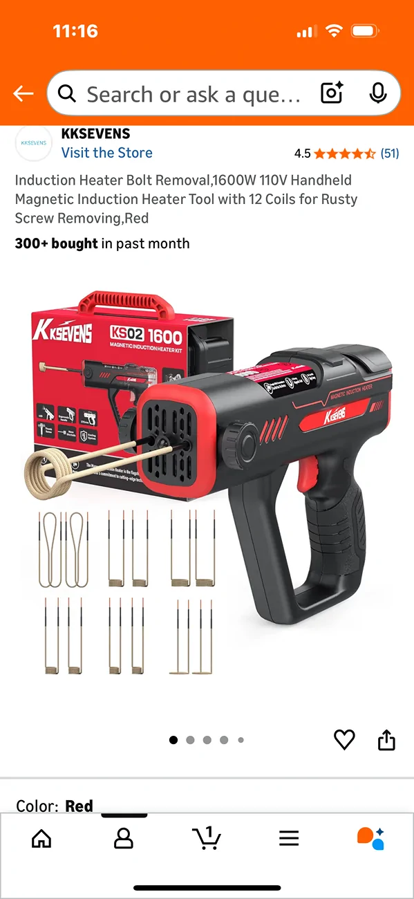

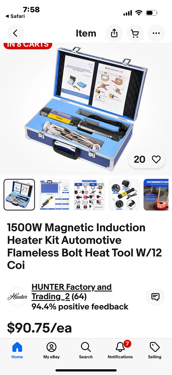

The cheapest I saw on Amazon for one of these was about $135.
cheapst I could find Canadian on amazon was 300 bucks. 135 usd is not 300cad. lol

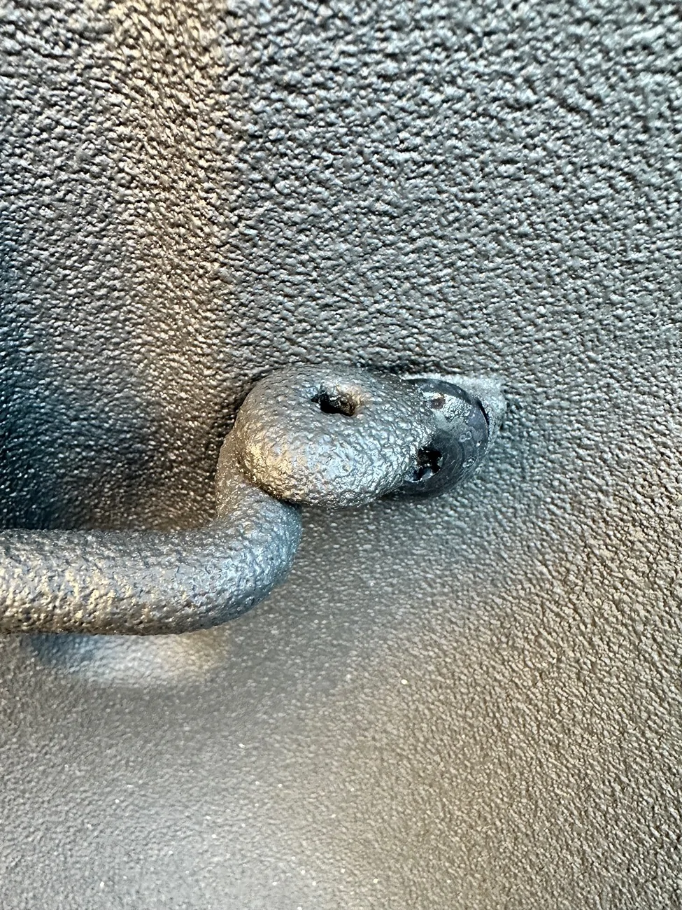

I have seen multiple pictures of torched bedliners, heat bubbled paint, various scratch marks from vise grips and pliers. Broken screws drilled off-center and basically, just a waste of time and destruction of our trucks to get the thread-locked TP40 screws off our tie-downs. My truck has factory bedliner that completely cover the screw heads almost gluing them to the tie-down bracket and filling the Torx opening. I spent 30 minutes trying to get the bedliner out of the hole of one screw and did a horrible job—-NO MORE—

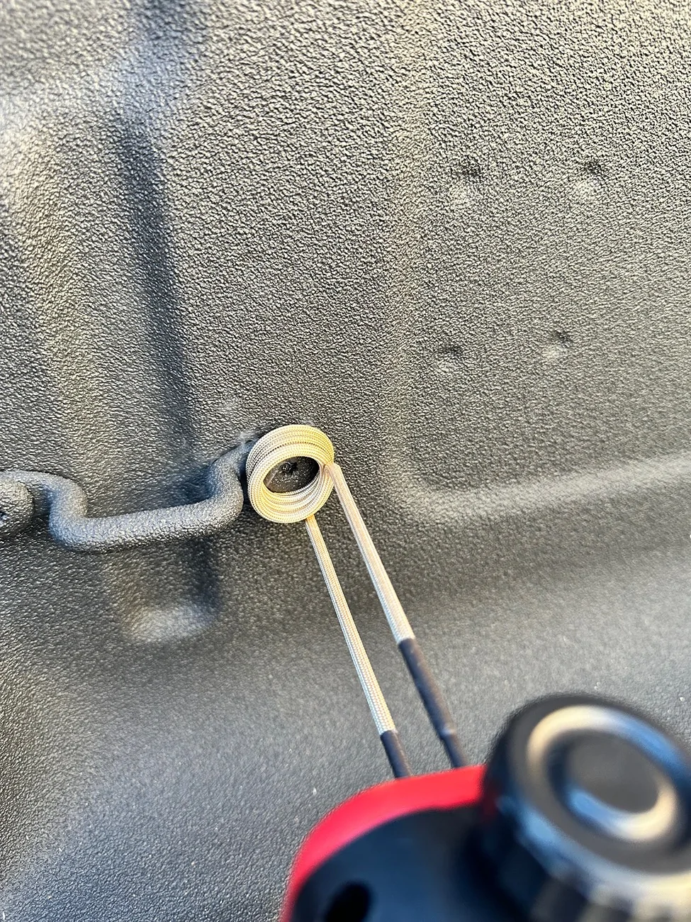

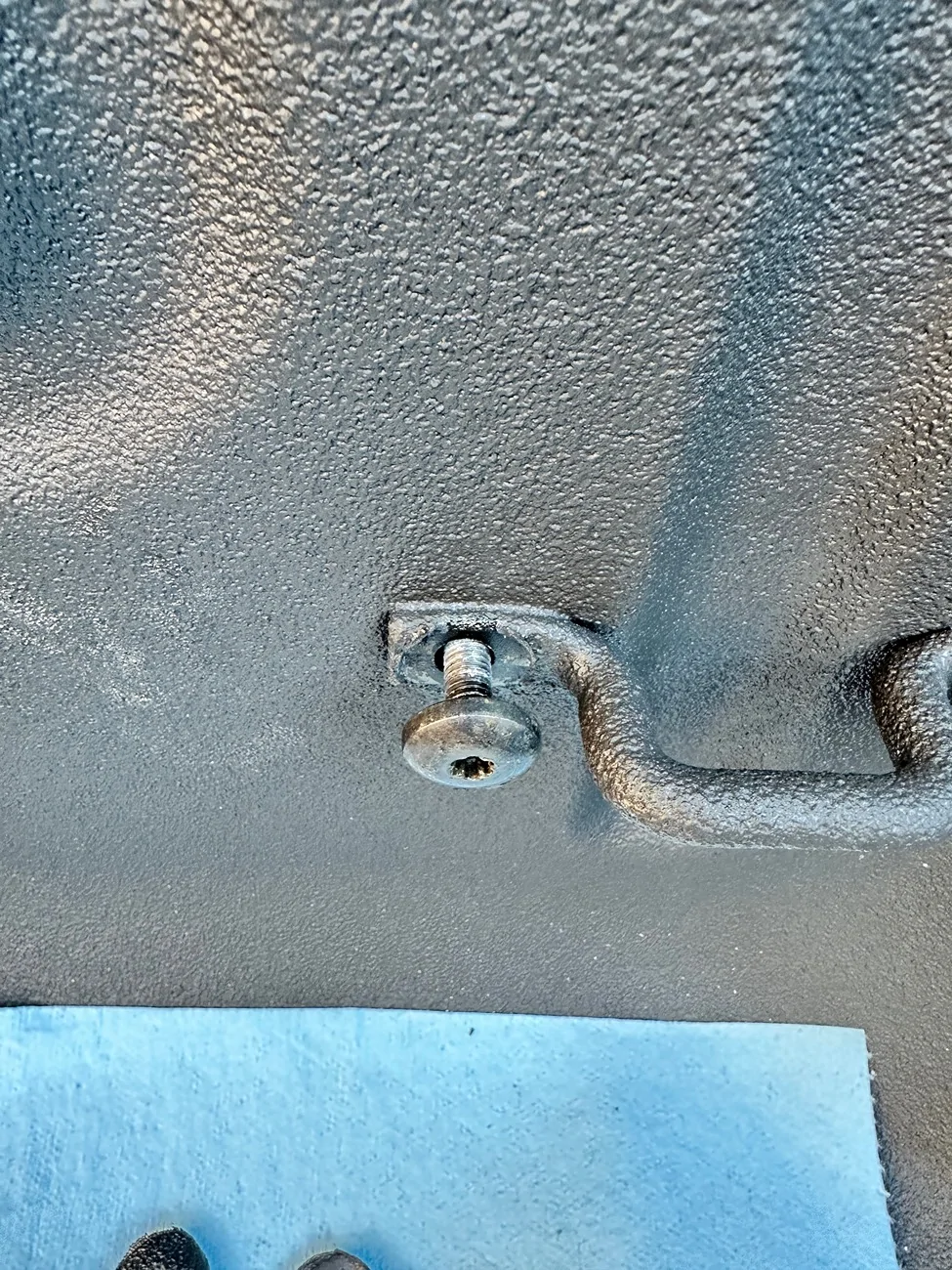

This is an easy method of removing those horrible tie-down screws. No cleaning the screw heads at all—heat the screw head, and the bedliner pops of the screw like a little mushroom head of bedliner.

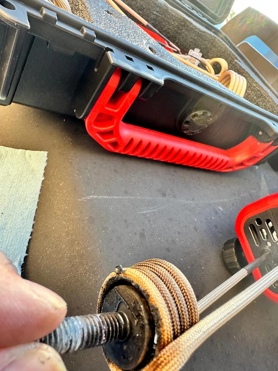

This method involves the use of a Magnetic Induction Heater Tool—which is specifically designed for removing rusty and stuck Nuts, Bolts, and Screws. These tools are on sale at Amazon from $140-$240.. The tool I used was a KKSEVEN 1600watt, pistol grip, which was delivered overnight from Amazon ($240). I think this is a bargain. If you are a DIYer and snap off a couple of screws, you are going to pay a professional twice as much as this tool costs, and probably still have a burned and heat bubbled finish if a torch or open flame is used.
Induction heating rapidly applies extremely high heat in a precise location. It doesn’t heat aluminum (what our truck beds are made out of), or paint, bedliner, etc—and only heats the steel screw head inside the heating coil—in this application, just the head of the TP40 screw is heated and the heat flows down length of the screw and softens the thread locker. Minimal heat transfers to the tie-down or the bed.
Just a note: if you watch the manufacturer’s video on how to use the tool, they show applying heat for 25 seconds on an extremely stuck rusty nut—the nut turns red hot after about 20 seconds—don’t do that. I did a trial test on a 1/4x20 brand new zinc plated bolt. It went red—and almost white hot in 25 seconds. It burned all the zinc plating off and destroyed the grade 8 hardening of the bolt turning it to junk.
This is the unit I bought
Select a slightly larger heating coil. I had to slightly unwind this one to fit.

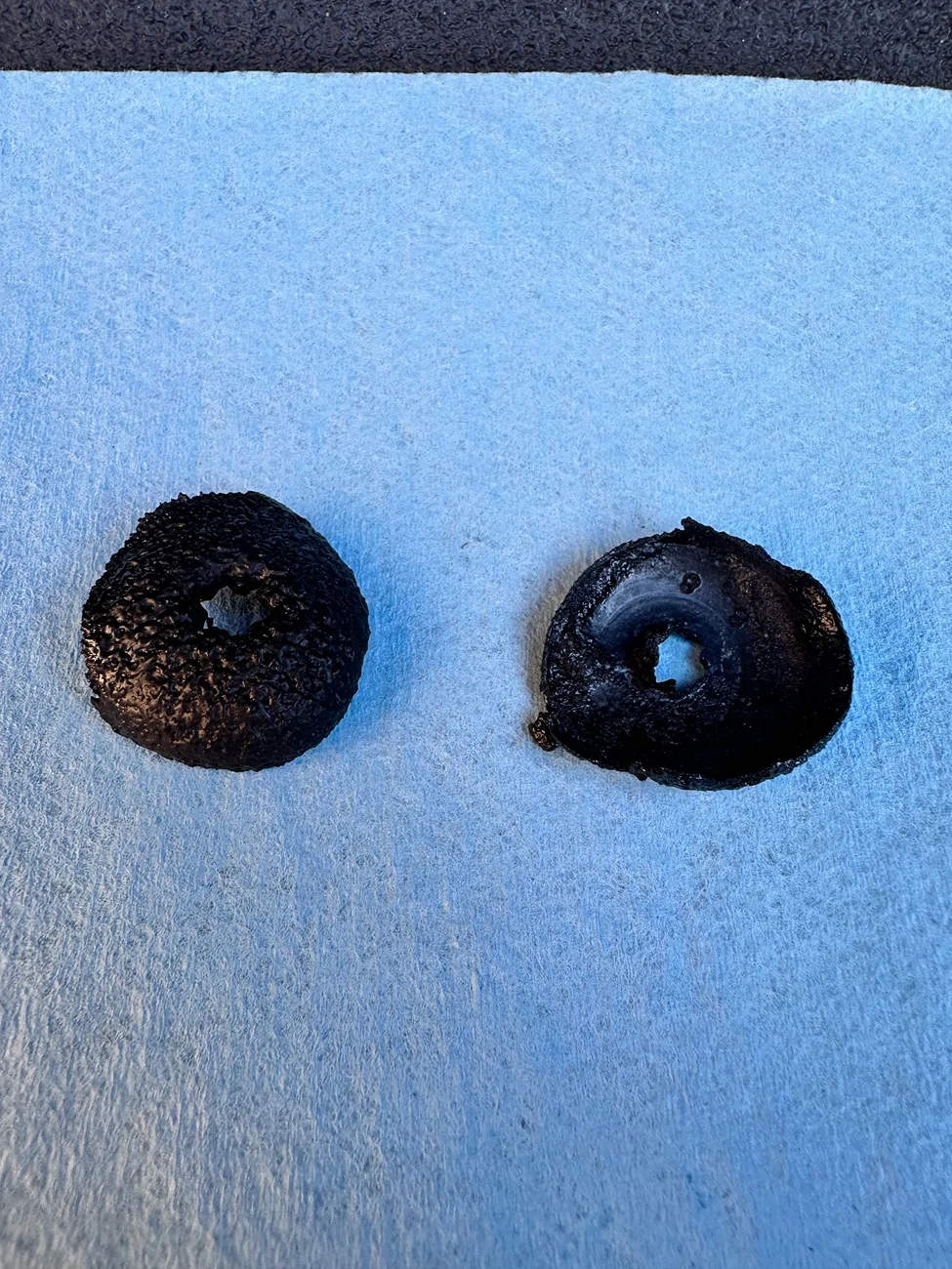

Place the heater coil over the screw head with power on for about 10 seconds, wait about 10-15 seconds for the heat to flow down the screw and soften the thread locker. Apply heat for another 10 seconds and when you remove the heat, the bedliner on the head of the screw will just pop off the head—perfectly clean little mushroom head of headliner. That is the bedliner pop-off on the tie-down below—it looks like the head of the screw—and it has the liner that was inside the Torx hole removed.

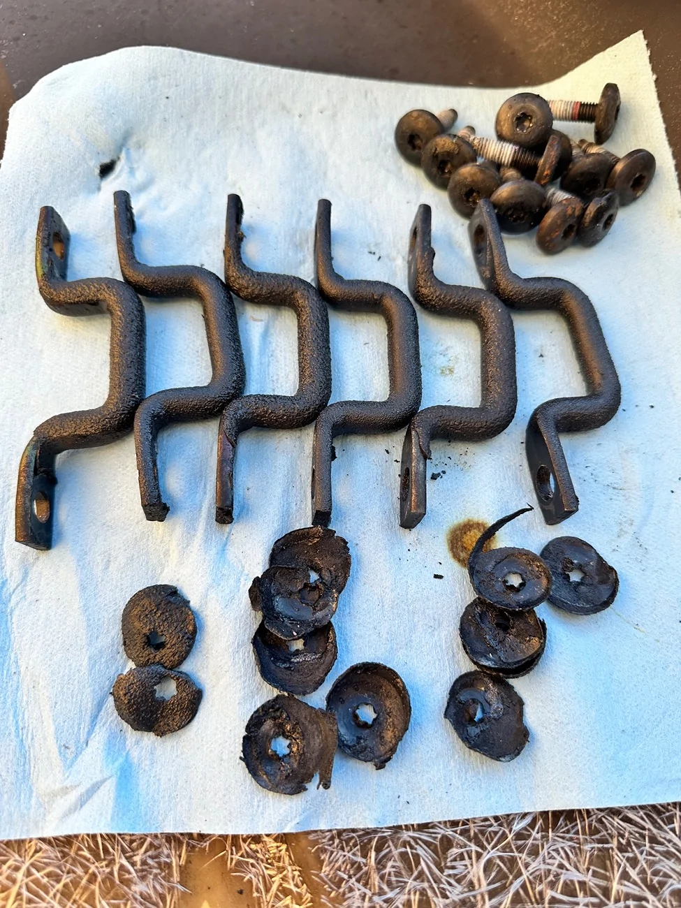

Bedliner from head of screw—when you heat it just right—it just pops off as a single piece with little to no residue.
It took less than 20 minutes to remove all of the tie-downs. I placed them in a can of lacquer thinner overnight to remove all remnants of bedliner. Some of the black oxide heads were rusted under the bedliner. I think I will powder coat the heads before reinstallation.

I found the 10 seconds pause, 10 second to work almost perfect—but I went through about half of them before I figured it out. Once the screw starts coming out. It should be easy—if it starts to get tight again. Just apply heat for another 10 seconds. You should only have a small amount of smoke—mainly from the bedliner on the head—a whole lot of smoke indicates you did it too long.

Nice. I used a utility blade, went around the bolt head at the tie down, and used an 90° oring pick and the whole linger head popped off the same as that. for thr budget person that cant drop on one thise atm.

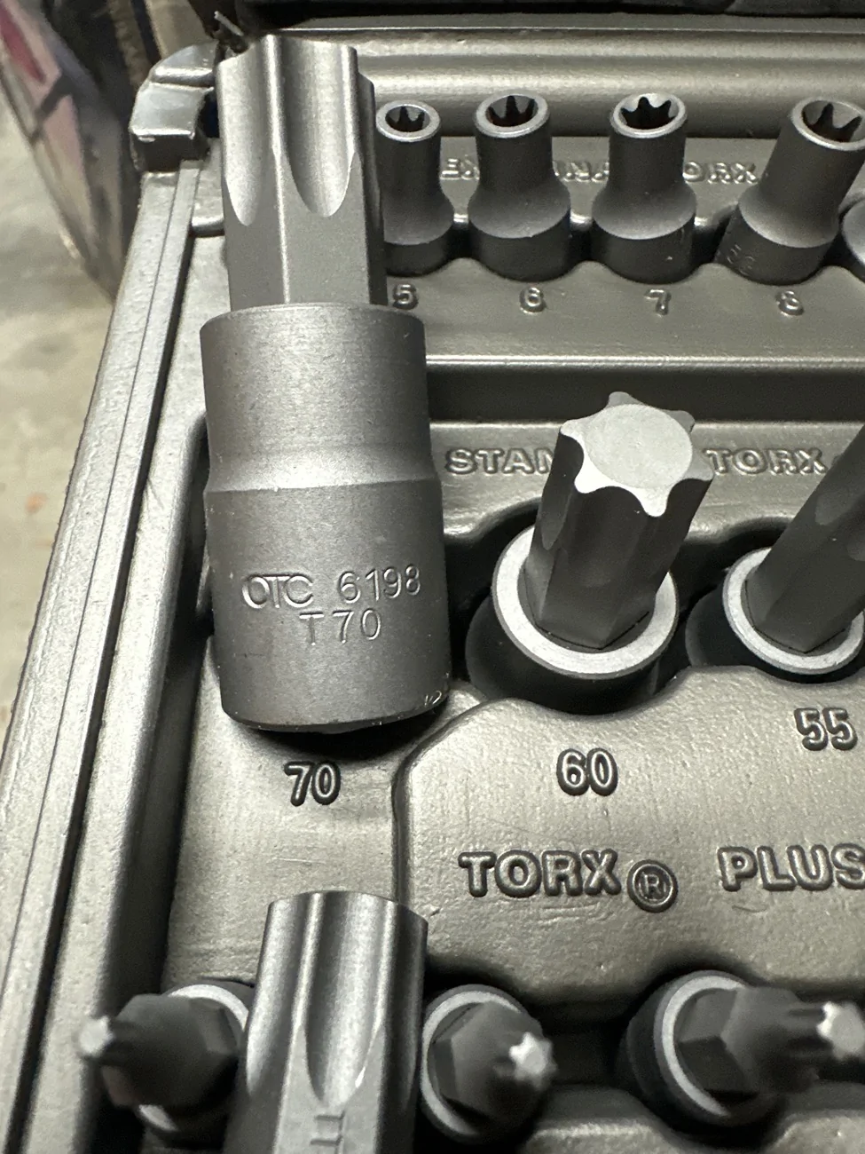

I will say for those going st this. PICK UP A TORX PLUS BIT!!!! I stripped out the torx on 4 bolts... 3 of them where reinstalling them... with a regular t40. then using the tp40 I didnt strip a one.
Did you replace the stripped ones with factory hardware? If so do you know the part number? I just stripped one of mine and am trying to find a replacement..

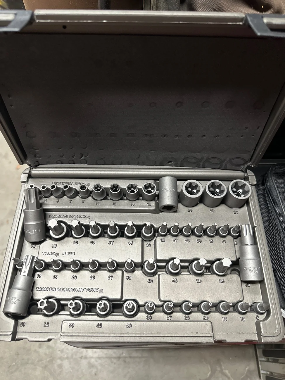

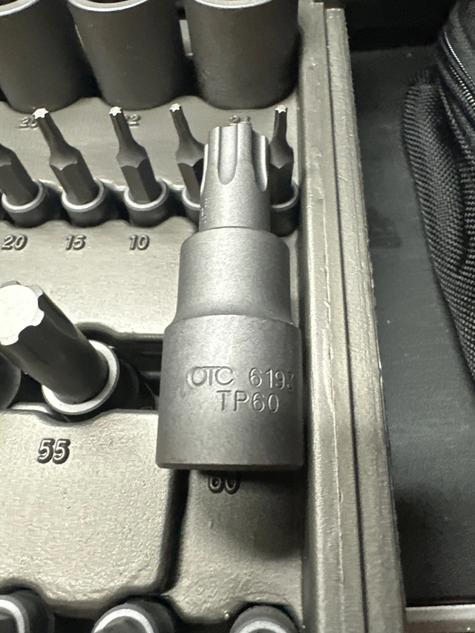

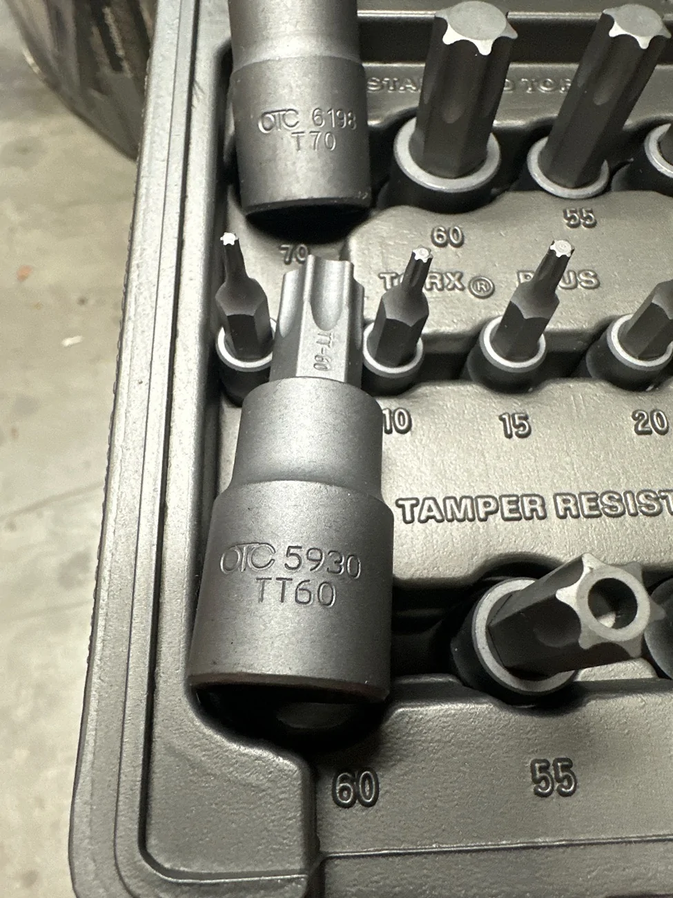

Actually, I think the proper name is IP40. (IP stands for Internal Plus)
  • Standard Torx (T-series): The points of the star are pointy. The star shape looks sharp.
  • Torx Plus (IP-series): The points of the star are flattened and squarer. The lobes are thicker. This design allows for higher torque without stripping.

You are correct on the licensed and proper name/abbreviation (IP)I have been guilty of mis-naming the fastener—but it’s not entirely our faults. Tool manufacturers that both pay and do not pay licensing fees and call the fastener TP instead of the correct name IP. These are pics from a master set I have. They are licensed. Regular Torx are (T), Torx Plus are (TP), and tamper resistant are (TT). Hope this can settle some of the confusion.
This is from google:
Trademarks and Licensing: Torx® and Torx Plus® are registered trademarks of Acument Global Technologies. To use these specific names and manufacture tools to their precise specifications, a company must obtain a license and adhere to strict quality control. Unlicensed manufacturers generally use generic, descriptive names like "star bits" or "six-lobe wrenches" to avoid legal action.
Official Naming: The official, industry-standard designation for an internal Torx Plus driver is IP (Internal Plus).
Ambiguous "TP" Usage: The "TP" abbreviation is informal and ambiguous:
Some users and manufacturers use "TP" as a simple, informal shorthand for "Torx Plus".
In other contexts, "TP" can informally refer to Tamper Proof (or Tamper Resistant) Torx bits (which feature a center hole), a different bit style entirely. The formal abbreviation for Tamper Resistant Torx is typically TR or TT.
"Knockoff" Products: The primary way manufacturers avoid royalties is by producing non-standard, generic bits that do not meet the precise geometric specifications of the genuine product. These generic bits often lead to poor fit, cam-out, and damage to fasteners, and are usually branded with non-trademarked names.
In summary, a tool marked "IP" is made to the official Torx Plus standard by a licensed manufacturer. A tool marked "TP" is likely using an informal abbreviation, but its compliance with the genuine Torx Plus specification (0-degree drive angle, etc.) depends entirely on whether the manufacturer is licensed, which you usually have to verify independently.

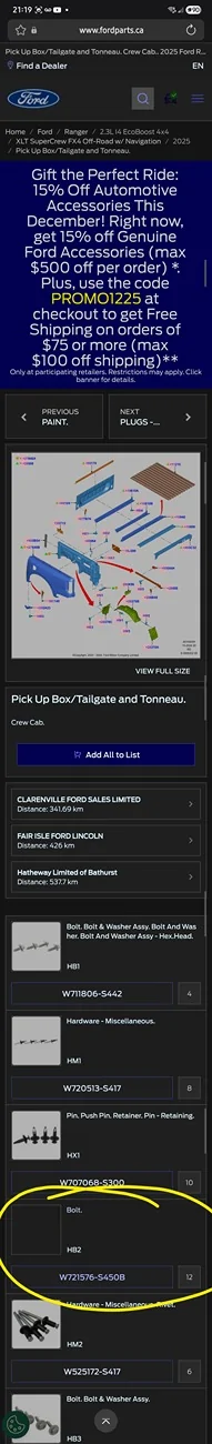

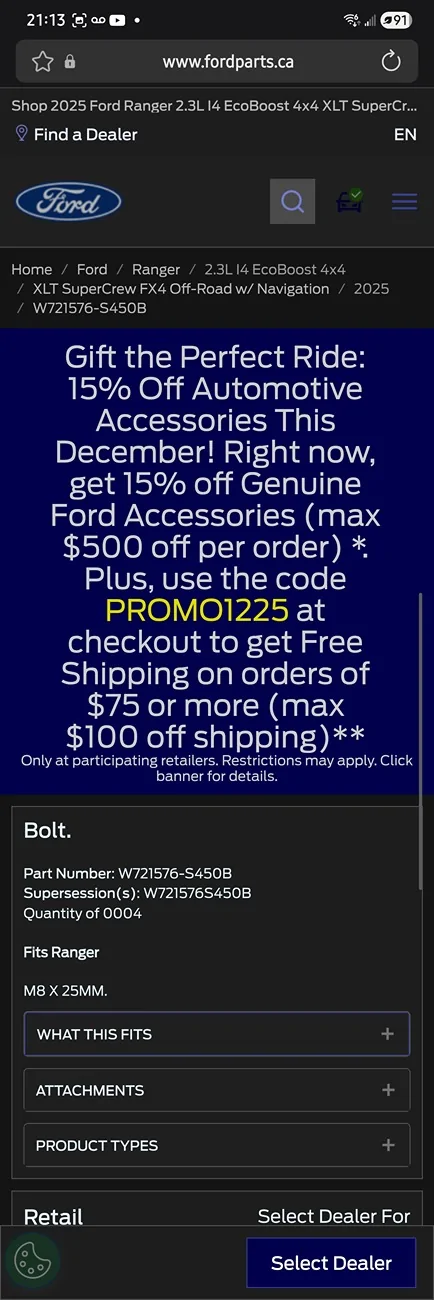

I did use OEM. called my cousin in the parts dept at my dealer, and told him I needed the bed tie down anchor bolts. They were like a buck or 2 each or so. and they had like 300 in stock as the f150 use them too.
The part # I just got off www.fordparts.ca is listed as a ranger only part, and the website says this part # is for a pack of 4. the 12 next to it is how many is needed for full replacement. but here it is off the website, and the site only lists it as ranger. but like I said my cousin in the parts dept said all the trucks use the one bolt.

How did you get the actual handle removed? Did they come off when the T40 was heated up? Anything else special you need to do?

Did the handles come off from heating up the T40? Anything special to do for them?
Scott
Raptor Family
Raptor Family
Apr 2, 2025
175
281
Dallas, Texas
‘25 Ranger Raptor, ‘97 Jeep Cherokee, ‘24 Lexus NX450h+
Scott
Yes, they were barely stuck from the bed liner. Just a little twist and they popped off.
