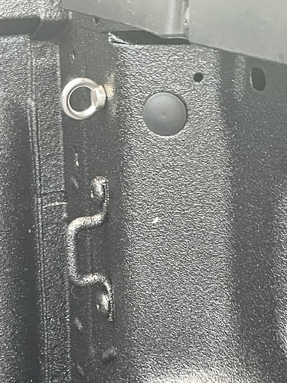

I used some lock washers on mine. You can also shim with some flat washers, if you are fussy about the orientation of the eye.

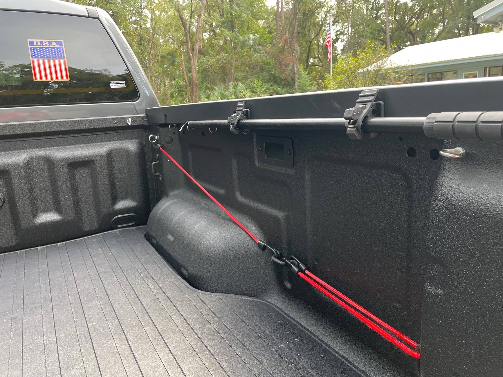

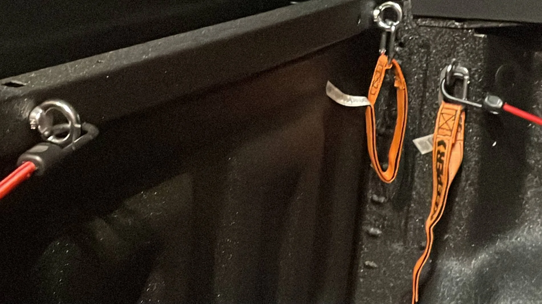

Mine have stayed in with just the eye bolts and no washers for months now.

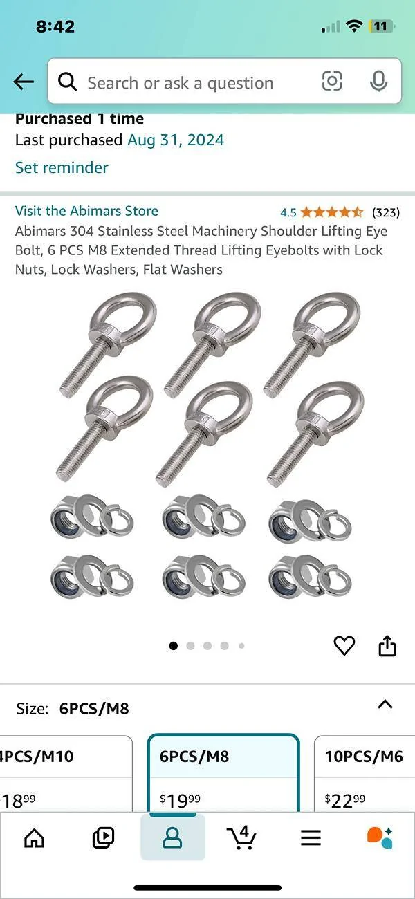

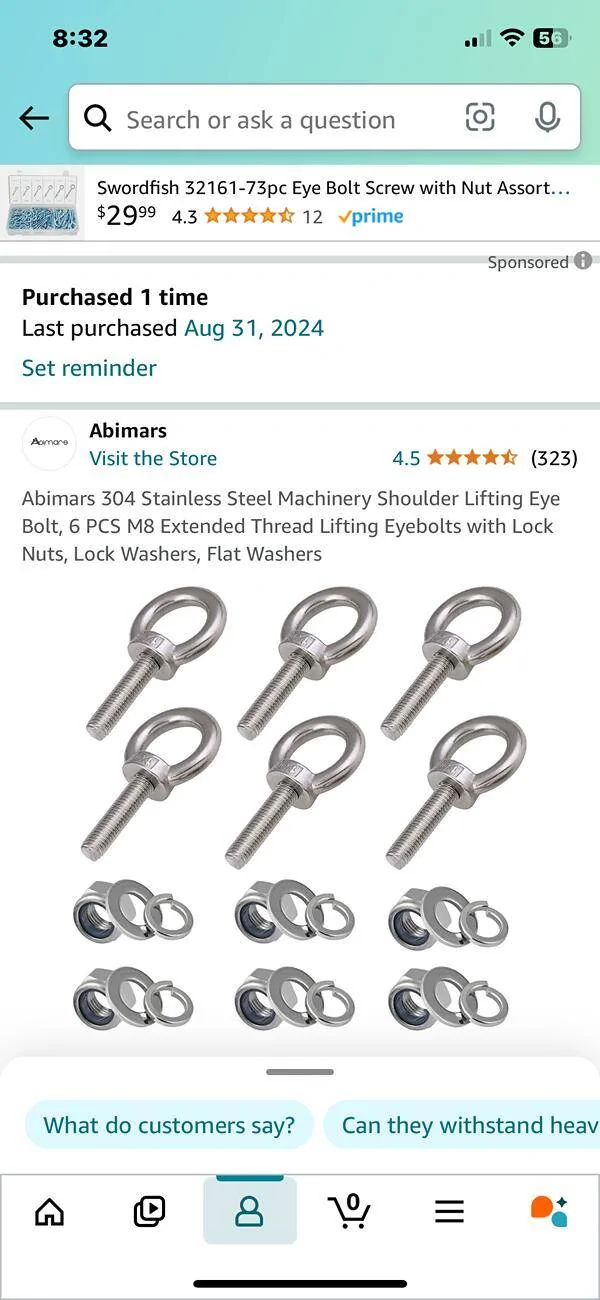

Not that it matters which exact ones I bought, but these are what I used in the various holes (AFTER chasing the holes proper to clean them out)
https://www.amazon.com/dp/B087JWL4P5?ref_=ppx_hzsearch_conn_dt_b_fed_asin_title_1
https://www.amazon.com/dp/B09BKT8SW9?ref_=ppx_hzsearch_conn_dt_b_fed_asin_title_1&th=1
