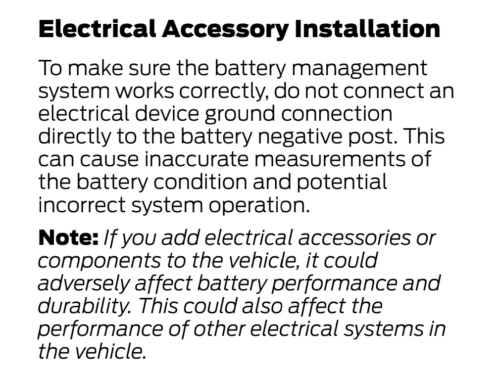

I would just run a wire to one of the terminals on the negative side of the battery. The power for switch #1 is basically next to the battery anyway so you'll have to run wires already.
Appreciate the suggestion. Unfortunately this is not recommended by ford.
Refer to 2024 Ranger Owner Manual page 411. The section on electrical accessory installation advises against this as it could mess with the battery management system.
Ford Ranger Engine Bay Ground Points 1000007913
This is just saying don't bypass the little battery monitor module on the negative terminal and go direct to the battery at the post. The "note" here is saying that accessories use power.
If you look at the battery, on the negative terminal there's a little box attached. Grounding "after" that box is fine, and you can even see where the frame is grounded directly from that same post.

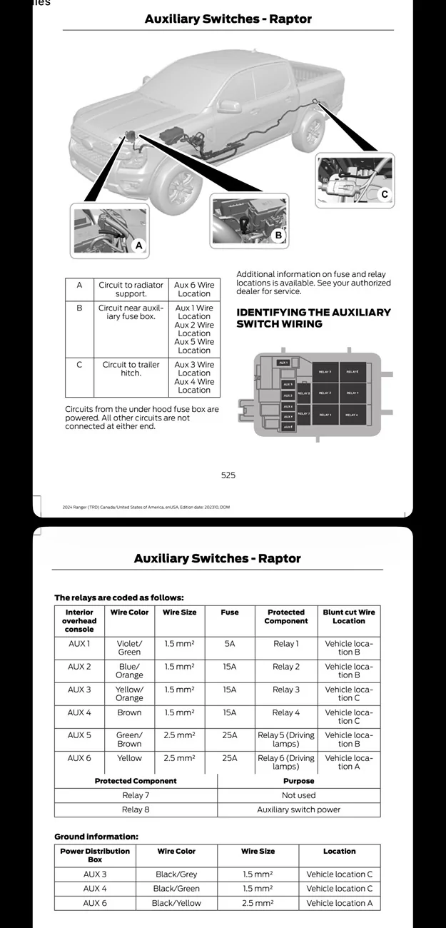

I was looking at this more (just finishing up a bumper & light bar install) and if you are using switch #6, that location has both a power and a ground. I just used this for a light bar.
Sep 15, 2025
That sounds awesome! What bumper did you go with? Been a thinking about getting one my self. As for the #6 switch, that’s good to know as I’d like to add more lights in the future.
Did some more digging too and it looks like #3 and #4 (located at the back of the truck) also have associated ground wires.

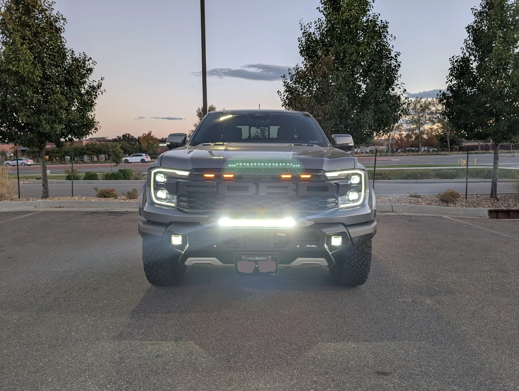

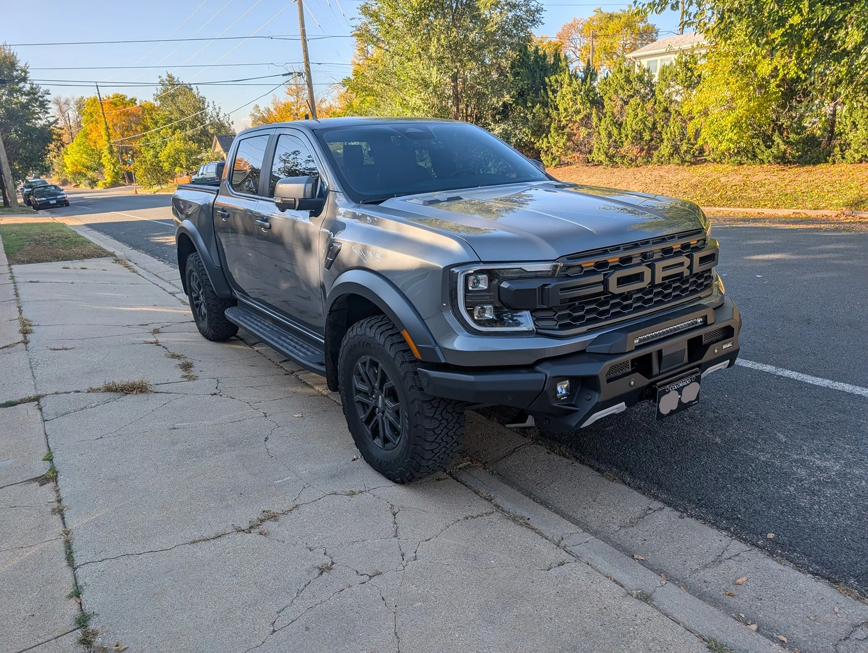

I got the Rival Bumper, I've been happy with their skid plates and I like the look (not just a bunch of round tube bends). I'll do a whole writeup once I've tweaked a couple things but:
Ford Ranger Engine Bay Ground Points PXL_20251015_151506707
This is the 20 inch "SR Series Pro" lightbar hooked to switch #6... 17,000 lumens is a lot haha.
That’s a sweet build! Love the bumper and marker lights combo.
