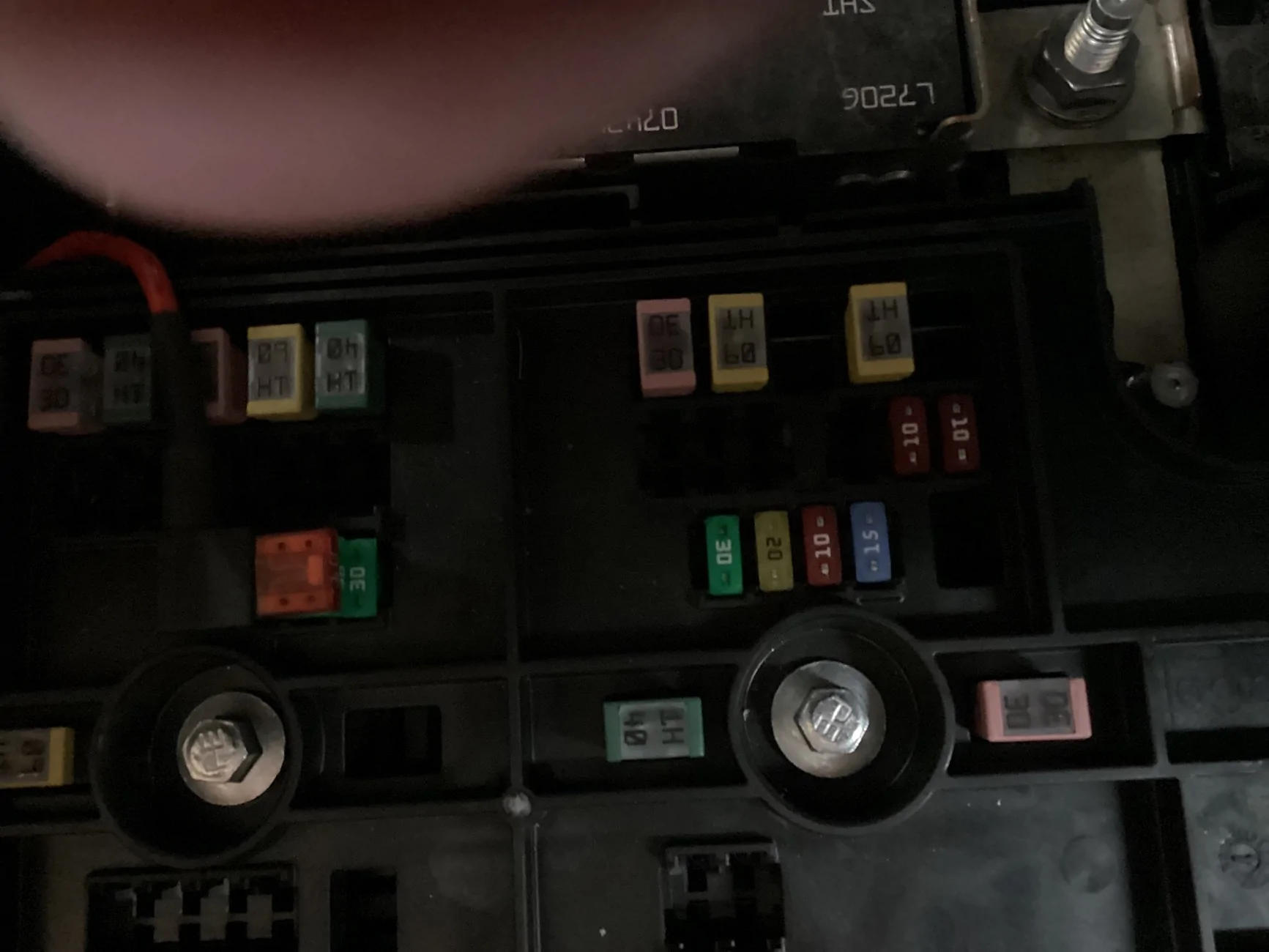

They don’t, power the DRL off fuse 30 with a micro piggy back and they will come on with lights. Here is a shitty picture of the location,

Thanks. I'd like the amber to be switched on the Aux, but also want to leave the switch on when I get out of the truck. There may be times I don't want the amber to be on.
