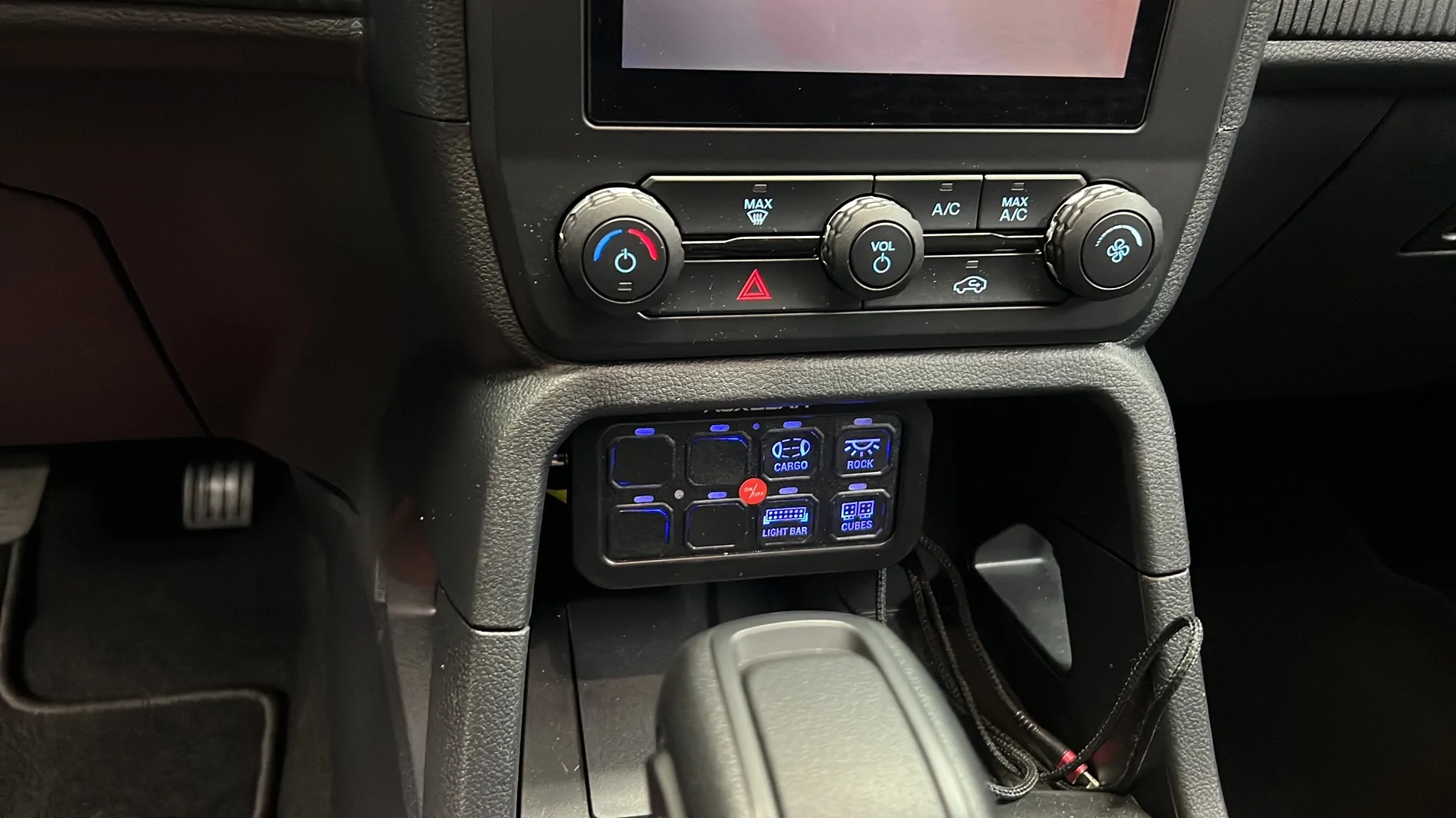

Auxbeam and a couple of others make adding accessories simple.
Love my Auxbeam switch panel.
One wire comes into the cab,every thing else is under hood.

How did you attach the control panel?
It comes with a little mounting bracket,that I screwed into the panel above the controller.
That way I still had room in the little cubby hole.

THX, so no issues with the screws hitting anything? Installing mine this weekend and debating where to mount it.
