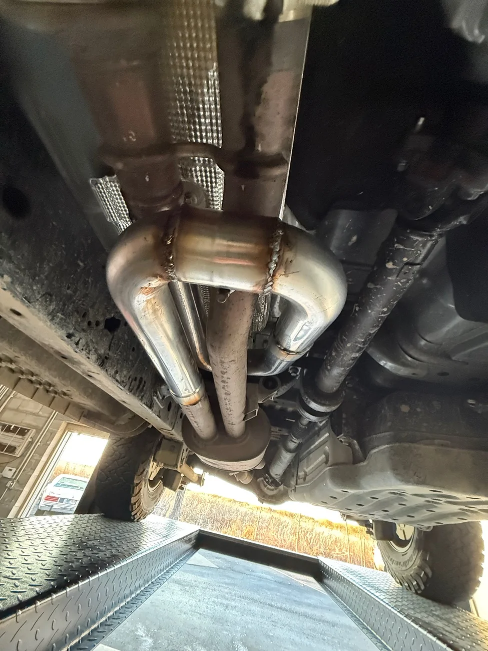

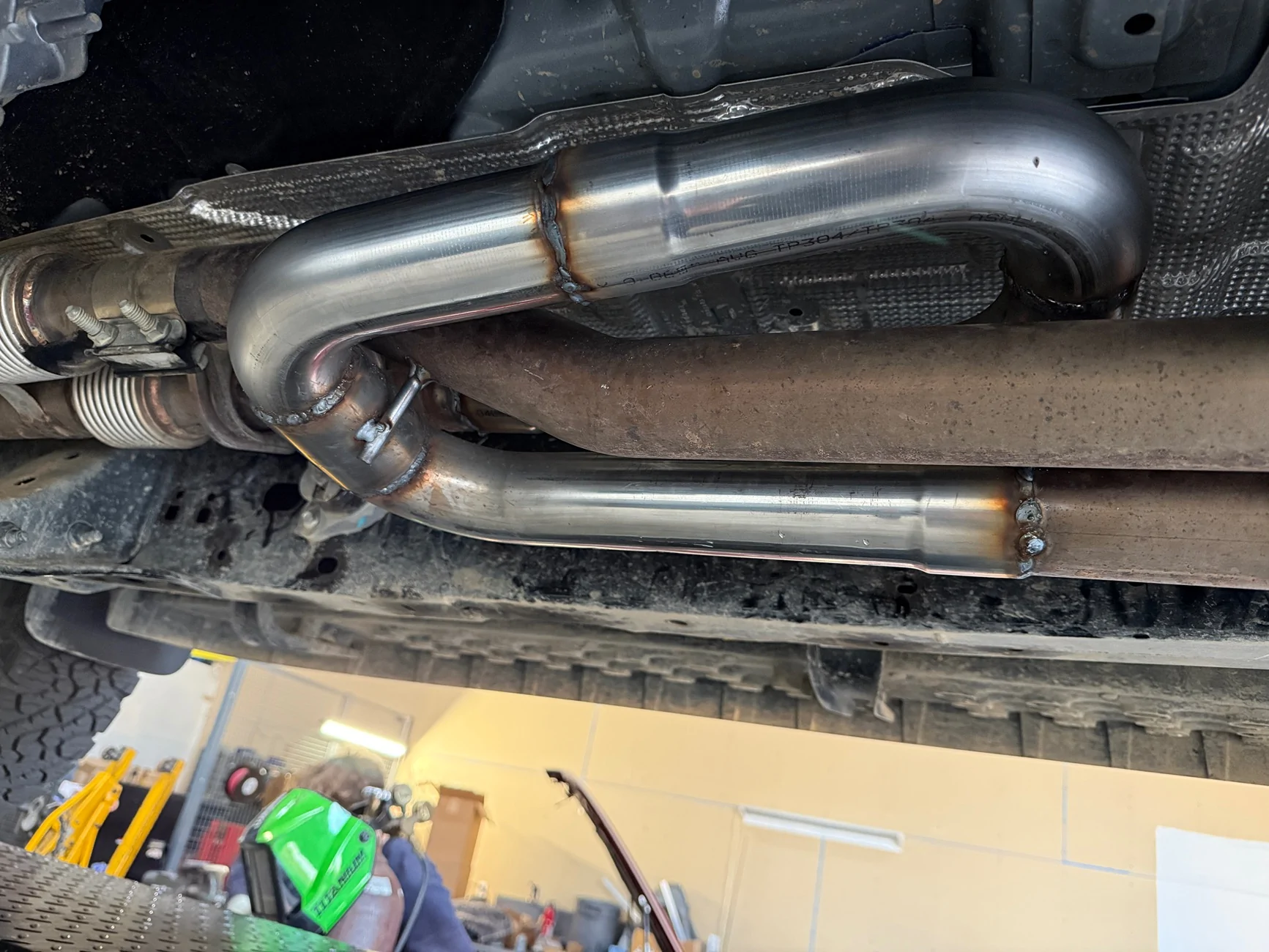

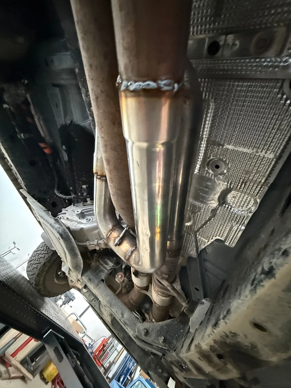

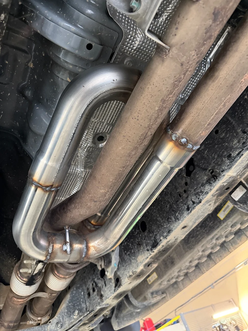

Had a shop here in Indy attempt this. Not quite what others have had done, but it def sounds different. Not sure if it’s better or worse.

Yeah, once I saw the final product I was like “well, that wasn’t it.” Basically just over compensated in the other direction, now the passenger side is longer than the drivers side. 🤦🏻‍♂️

Yeah the finished product i have didn't match my vision either, but it is equal length and it does sound good after breaking in. I'm still looking to get something more professional with smoother bends fabbed up. A z pipe could be interesting.
