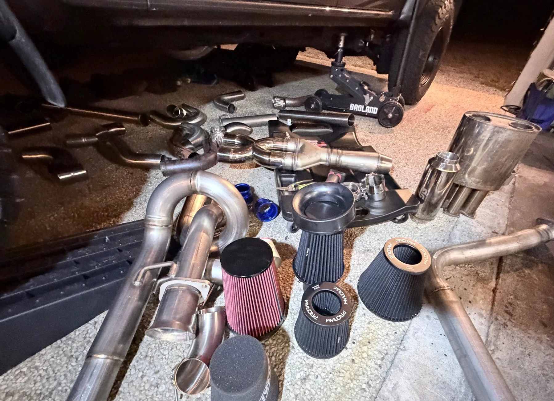

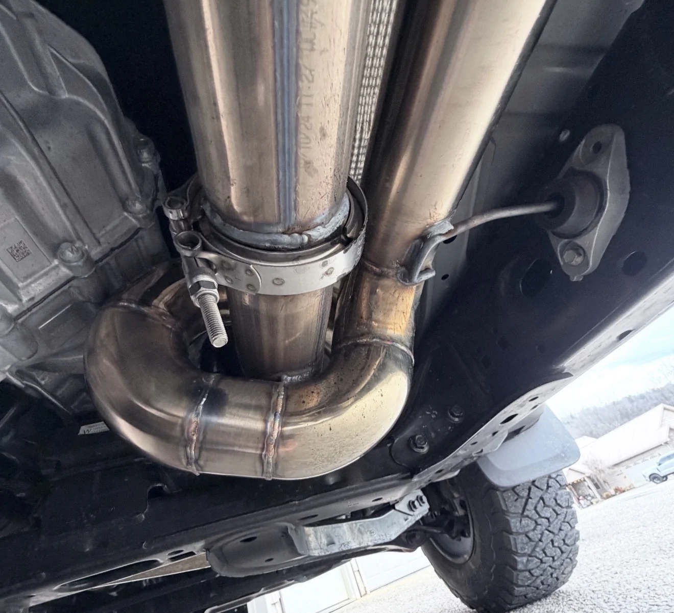

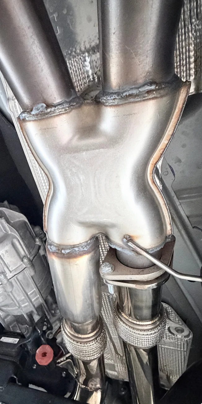

I tired the stock resonators in front of the muffler. Made it very quiet. I removed one of them, and it was better but still not there. Added an X pipe in front of muffler with 2 res, 1 res, no res, ended up taking out the resonators, X pipe, moved X pipe to the rear of muffler. Here's a sound clip. Lotta traffic noise, and was leaking around 4 of the welds, but so far it's what I've been chasing. Now just fine tuning the sound. I went with a tighter 20" loop. Will post final...when it's finished.
Sounds good. What exhaust mode are you filming in and using as a baseline for volume and tone?
I’m more shooting for an Audi 2.7T S4 smooth tone. I had an e46 m3 with an open dump pipe so I’ve had enough rasp for another decade.
