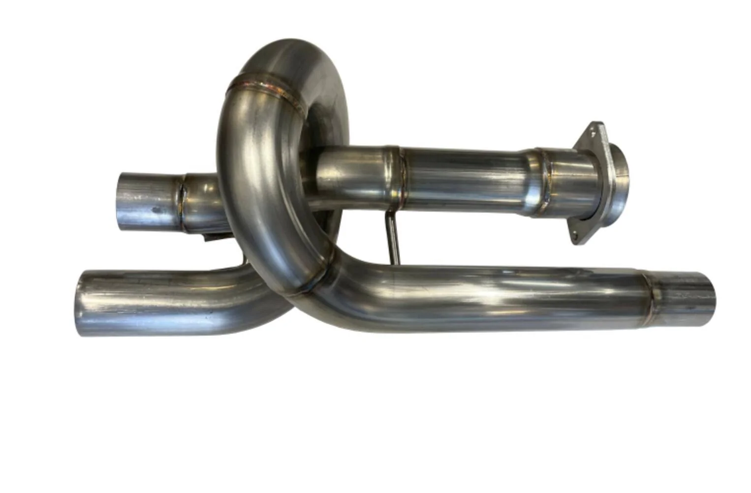

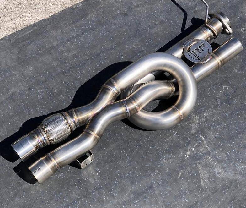

Truck sounds great! I've spent too much money working on exhaust setups. I have these on order now. One from SPD, the other from a fabricator in Australia.

Are those F150 or Ranger pipes?
The ones with the white background are made for an F150, but I already have 3" exhaust so I'll make them work if i have to zip tie them on.
The others are made for a Ranger Raptor from a shop in Australia.

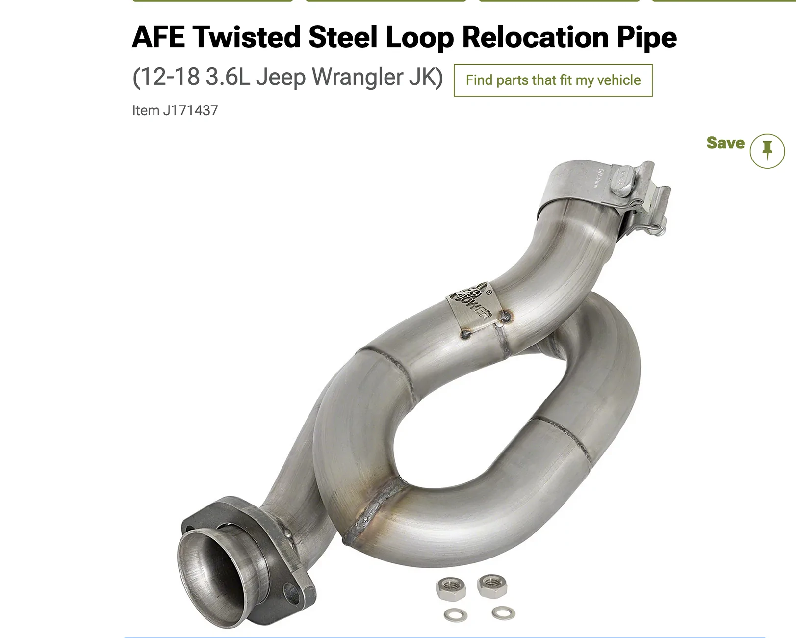

Negative. Still sitting in my garage. Tried Borla Switchfire and a pollyphonic thing. Still playing. I did find that a few of the Jeeps have a trombone that you should be able to find cheap enough to get and play with. Here's one from a quick search.

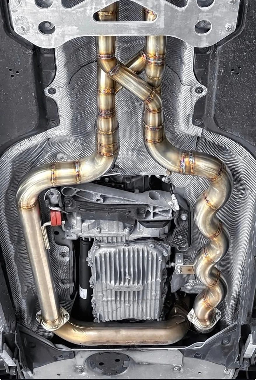

From what I gather, it doesn't have to be a trombone.
Most just use that to achieve equal length. See pic.
Ford Ranger Equal Length Trombone Exhaust Mod Installed w/ Sound Clip Video IMG_0701
Then the firing order marches in line and smooths out. Had high hopes for the Switchfire, and not given up yet, but other components I had installed, I need to remove. Lots of trial and error. Mainly error.

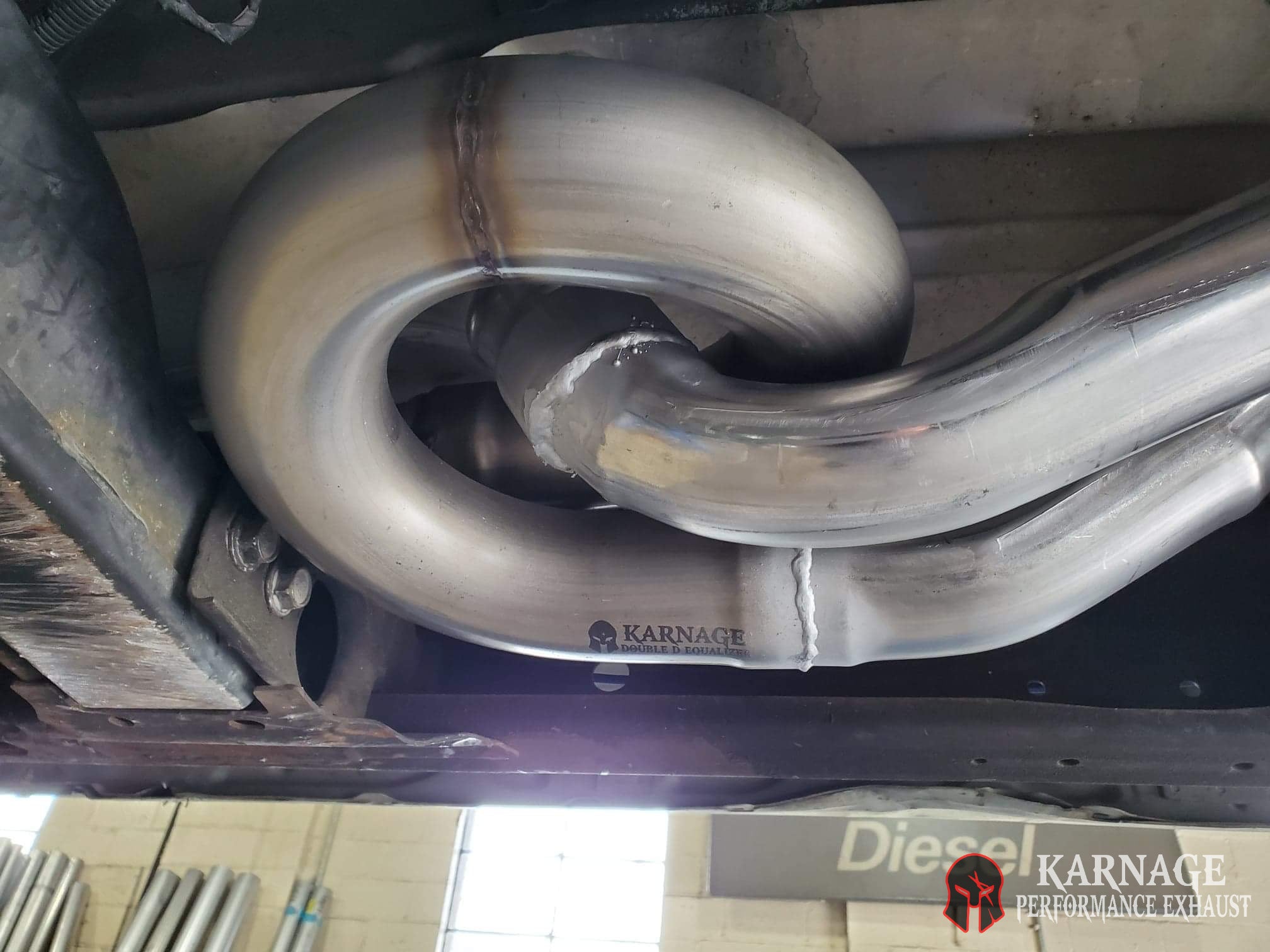

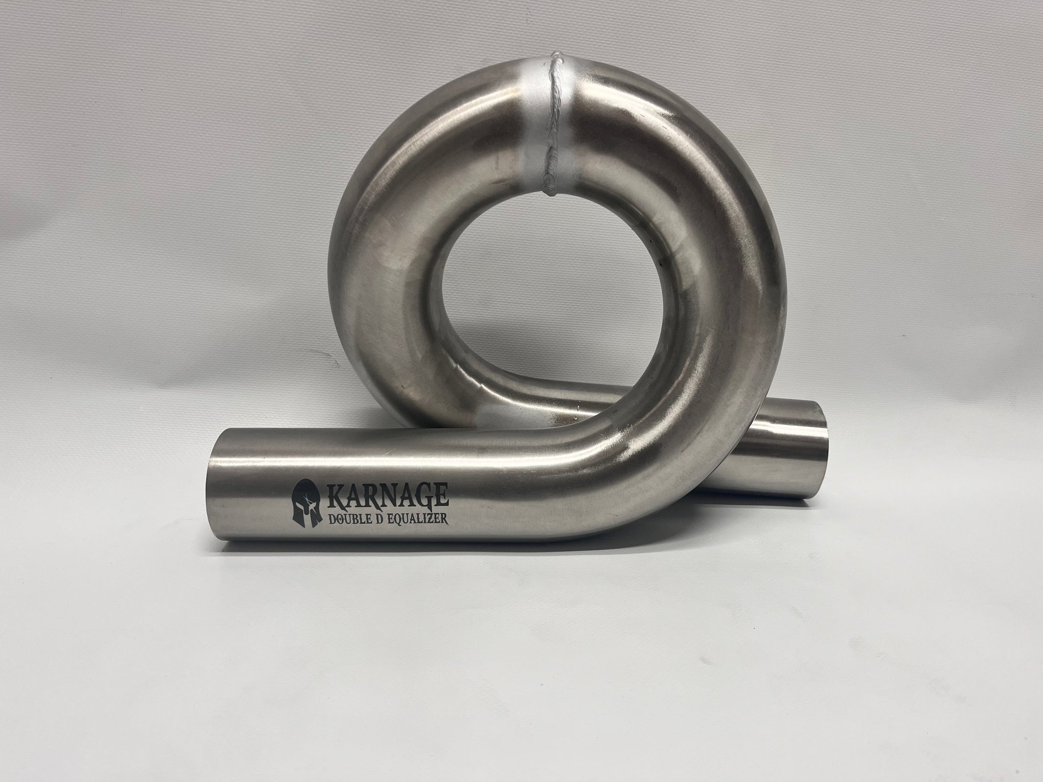

I was just looking around and found karange exhaust equalizer tube for $139. He's out of stock on the website but his facebook page post recently a day ago shows him boxing up a bunch to catch up on orders. He sells an x pipe to so could get both to copy what Reaper Performance did.
https://karnageexhaust.com/products/karnage-dd-equalizer-tube
Good find! Thank you. Just emailed them. A few hours from me. May have them do an install.
