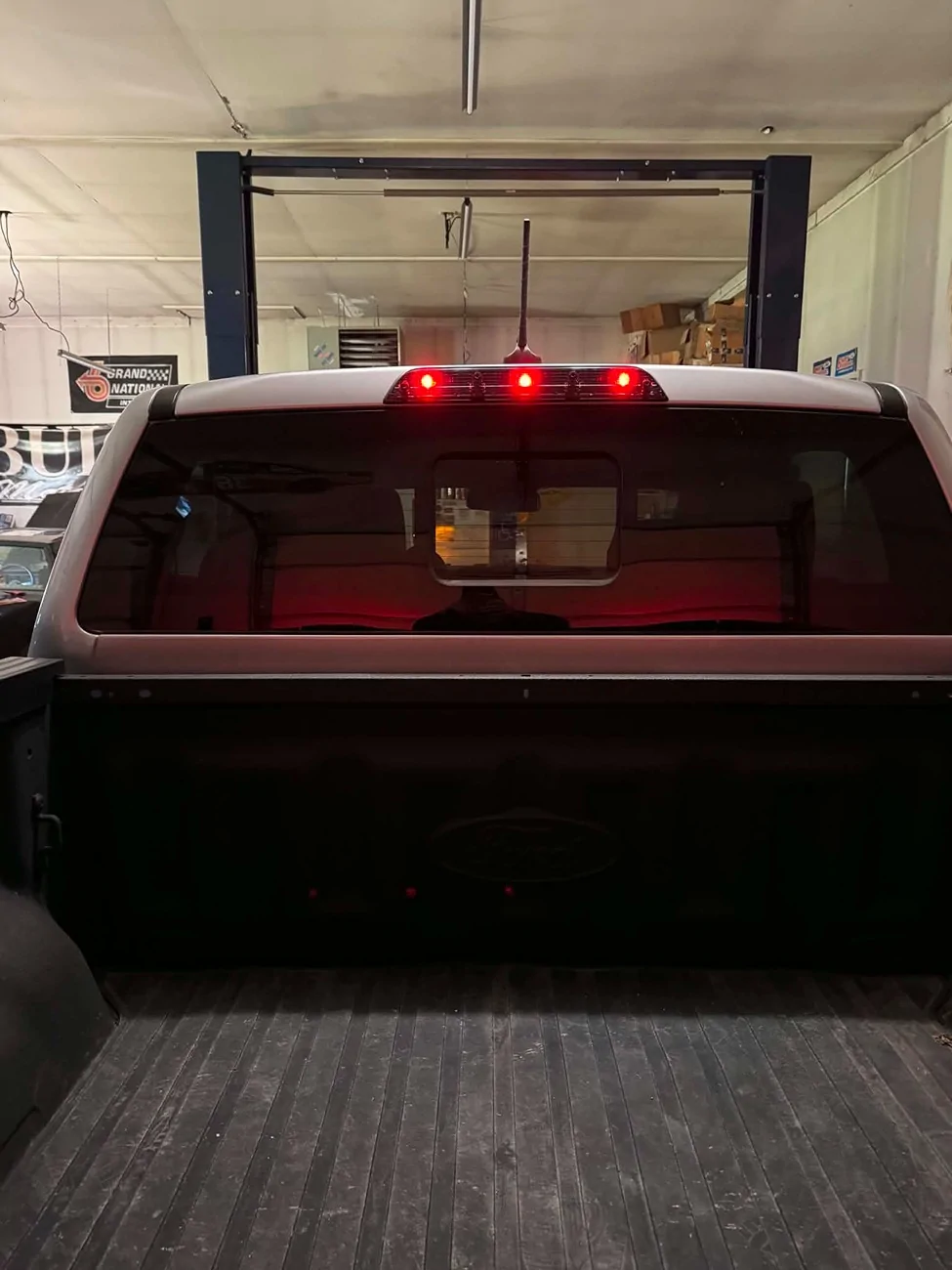

Well, this thread motivated me and I went ahead and got another one! Lol
I ordered it from IPIparts.com for $229.99.
it’s the best price I was able to find.
I put it on Friday. Ended up running the wire over to the driver side up top, down the C-pillar along with the other wiring, and down into the door sills. I tagged the parking light wire in the wiring bundle underneath the driver side door sill. It’s a white wire with a purple stripe.
