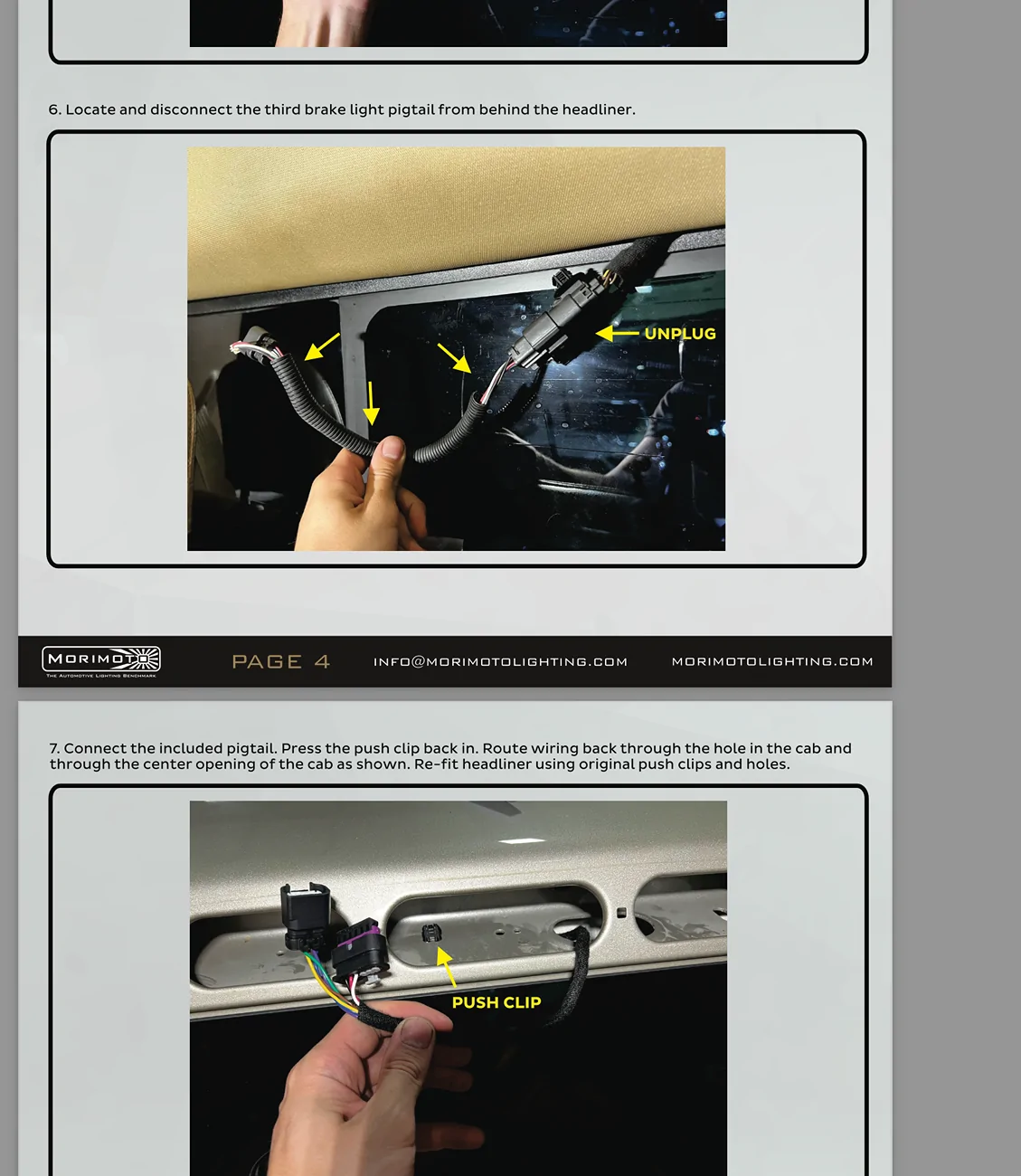

Thanks for the reply. Yeah i was looking at their instructions and was curious about this step
Ford Ranger FLASHING 3rd brake light Screenshot 2026-02-10 at 9.51.22 AM
did you add the flash module wiring or no flash?
I did add the flash and having an all black truck I’m glad I did.
The step you mention is what concerned me as well. In addition to that confusion they supplied a couple different harnesses. What the heck!?
So, I just unplugged the factory light and then plugged in the new light and lo and behold it worked. Next I unplugged the new light and then added the flashy thing and put it back together and it also worked. Stuffed it all back into the hole and let the headliner go back into place and mounted the new light. Haven’t had a single issue. Looks much nicer.

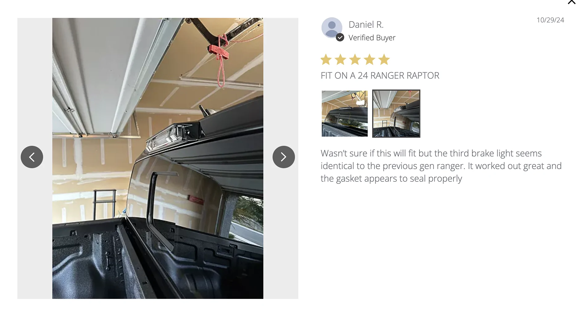

Interesting to know. Thank you! So lastly, what seals this up? The double-sided tape? My last concern was water leaking through as i think the stock one has a rubber seal around it?
GLW
May 26, 2024
477
535
Missouri
Mine had a nice rubber seal with tape. I don’t see it leaking. I didn’t like that the screws they sent were silver color. The whole thing is black. If you’re OCD like me you’ll want to address that detail.
Yeah after I posted that I checked reviews on their site and saw this one so I'll def be adding to the list of things to purchase.
Yeah, ill paint them with black paint marker before going in.. was already thinking that!
