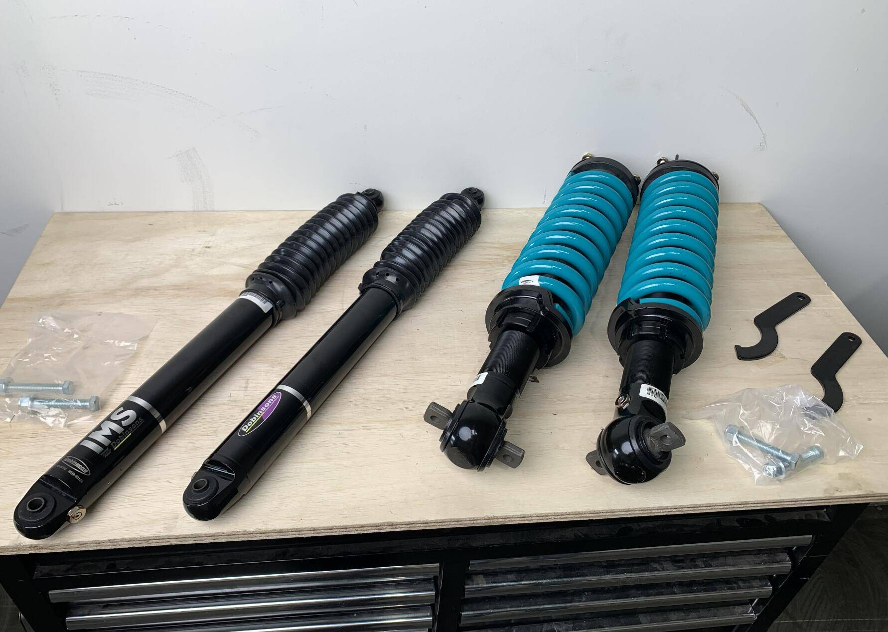

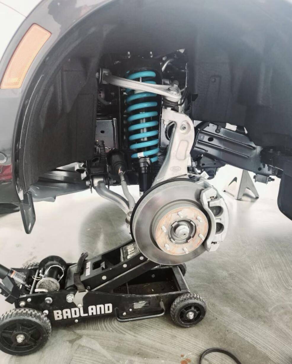

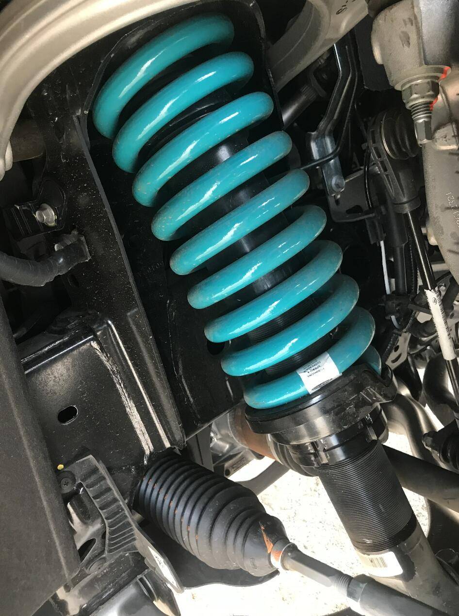

The Dobs lift is in! Netted us 1.5" of lift, though it could be adjusted up to 3". It handles amazingly ont he road, its smoother over small bumps, and according to the Shock Surplus team, is right at home doing 40 on washboard roads. Seems like it also handles good getting sideways on the dirt, and over the whoops. They will have a video on it! The team did an amazing job!

Looks awesome, looking forward to the video drop.
How is the street comfort? Do you feel any negatives from the lift?
I’m chomping at the bit now!
I too am!
Street comfort I think is actually slightly better than stock. The small imperfections I dont ffeel quite as much, and it isnt as skiddish on washboard roads. Turning feels about the same as stock. Offroad I heard it gained 2" travel in the rear, I cant remember about the front. I havent tested it much on anything but a gravel road, so offroad remains to be seen. As far as negative, the only one is wallet! Both in cost of lift and gas mileage. Mileage isnt down much, but ever so slightly. Once I put bigger tires on Ill notice the drop probably. When the video comes out the shock surplus guys will probably be able to explain it much more than me ?

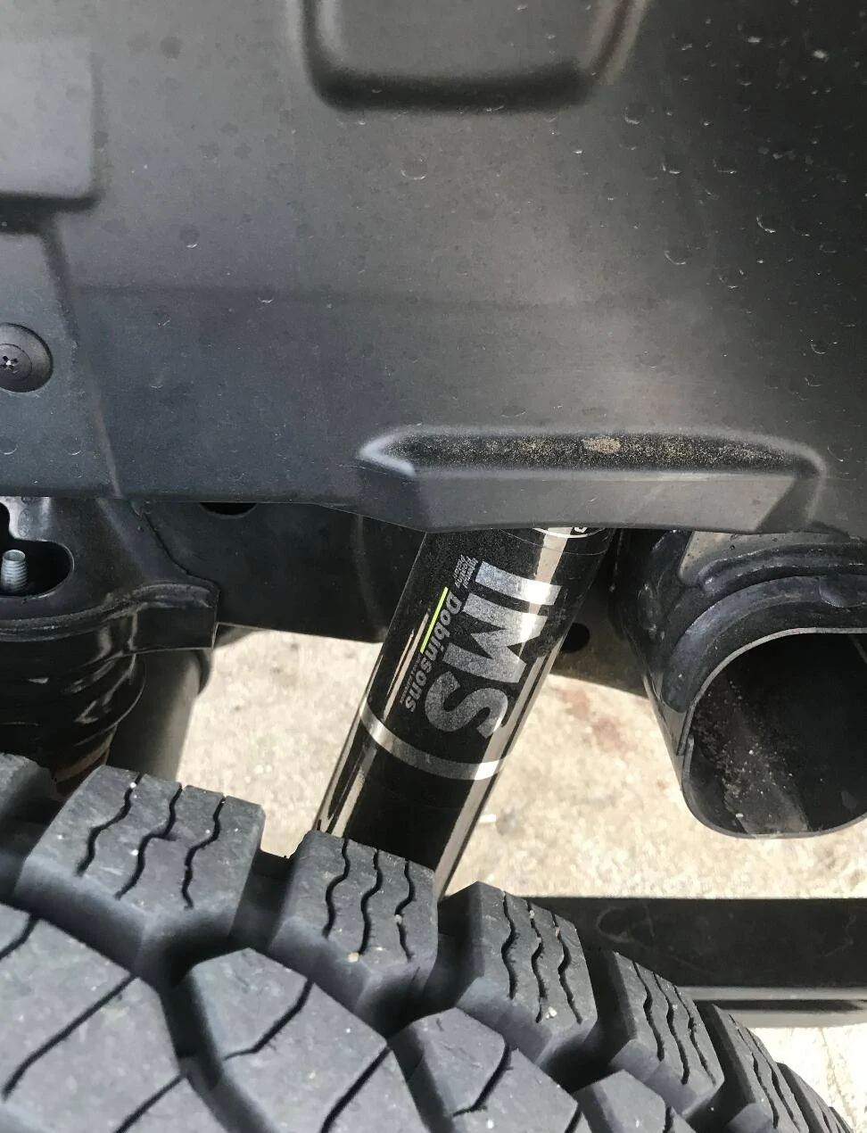

Thank you! I swear I thought I saw a reply asking about fitment- I left rake in the system when the Dobs coils were installed, so it rubs at full lock right now. But Im 99% sure if I just adjust the coil preload it will be fine- stay tuned on that one.
