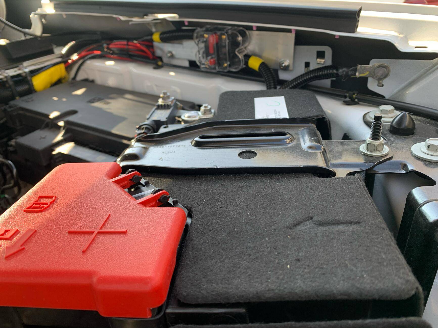

Lighting: Used Auxbeam switch panel, ran my GMRS antenna coax thru the port too.
Used 2" Alluminum plate to mount the fuse panel and breaker. Only mod to the auxbeam stuff was to crimp and solder a 90 on the positive side, since it wouldnt fir the cap.

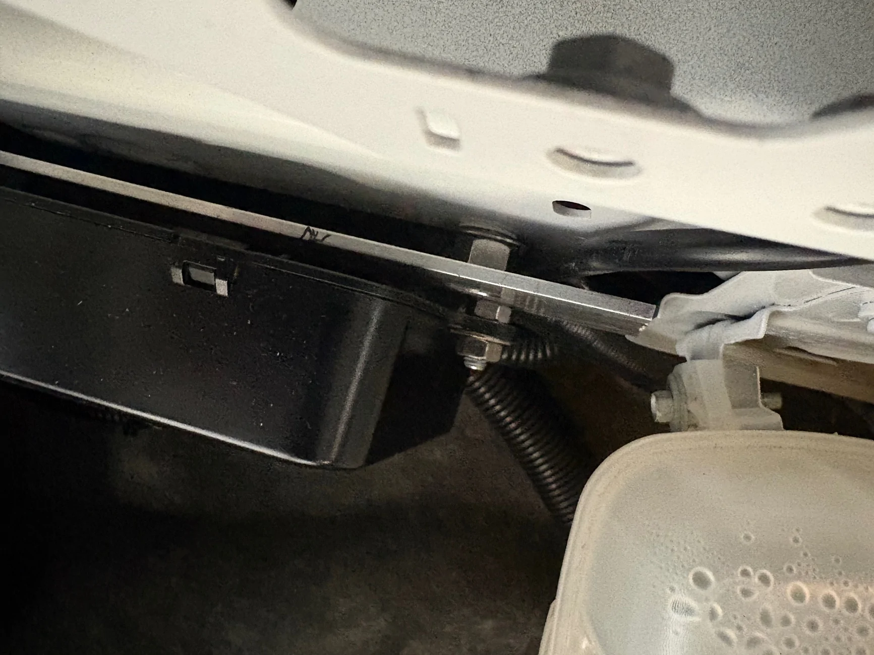

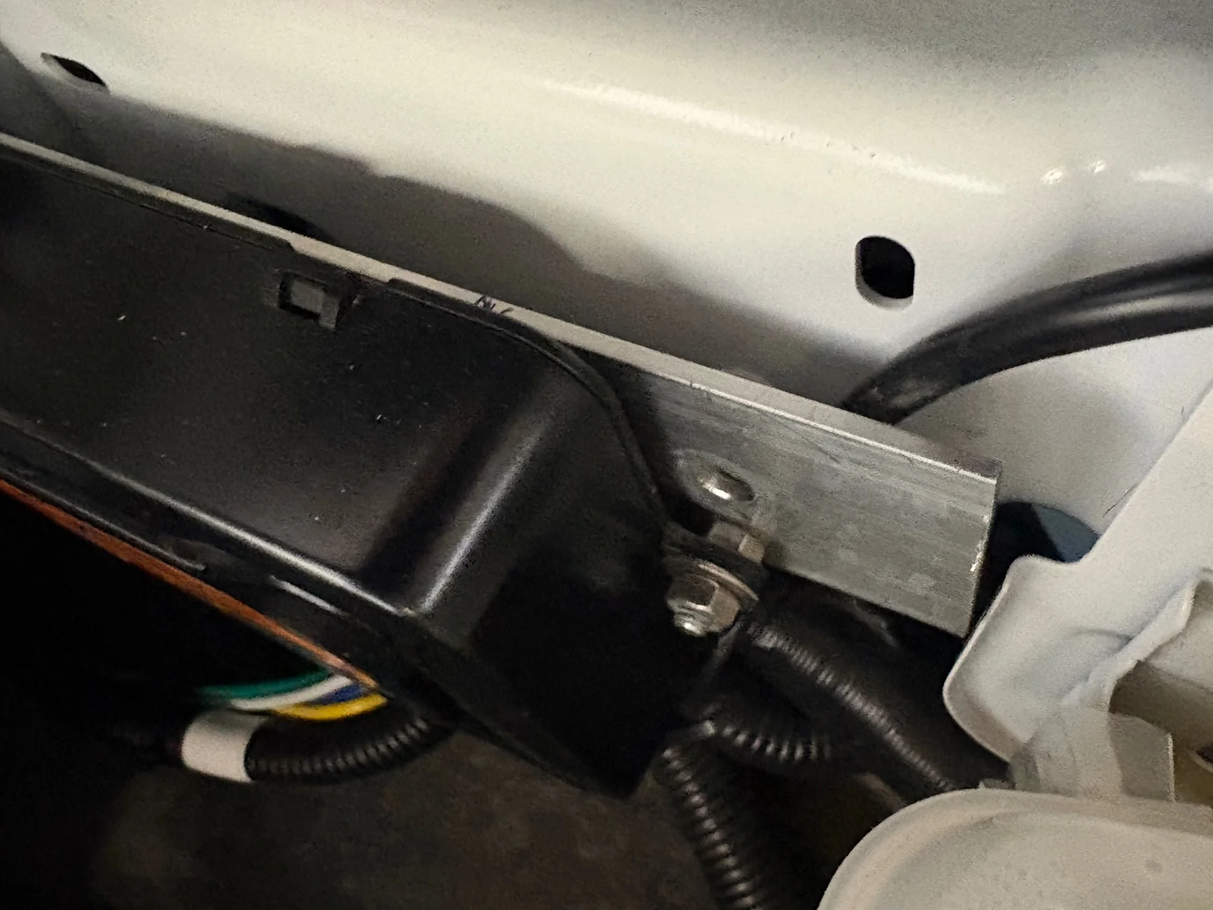

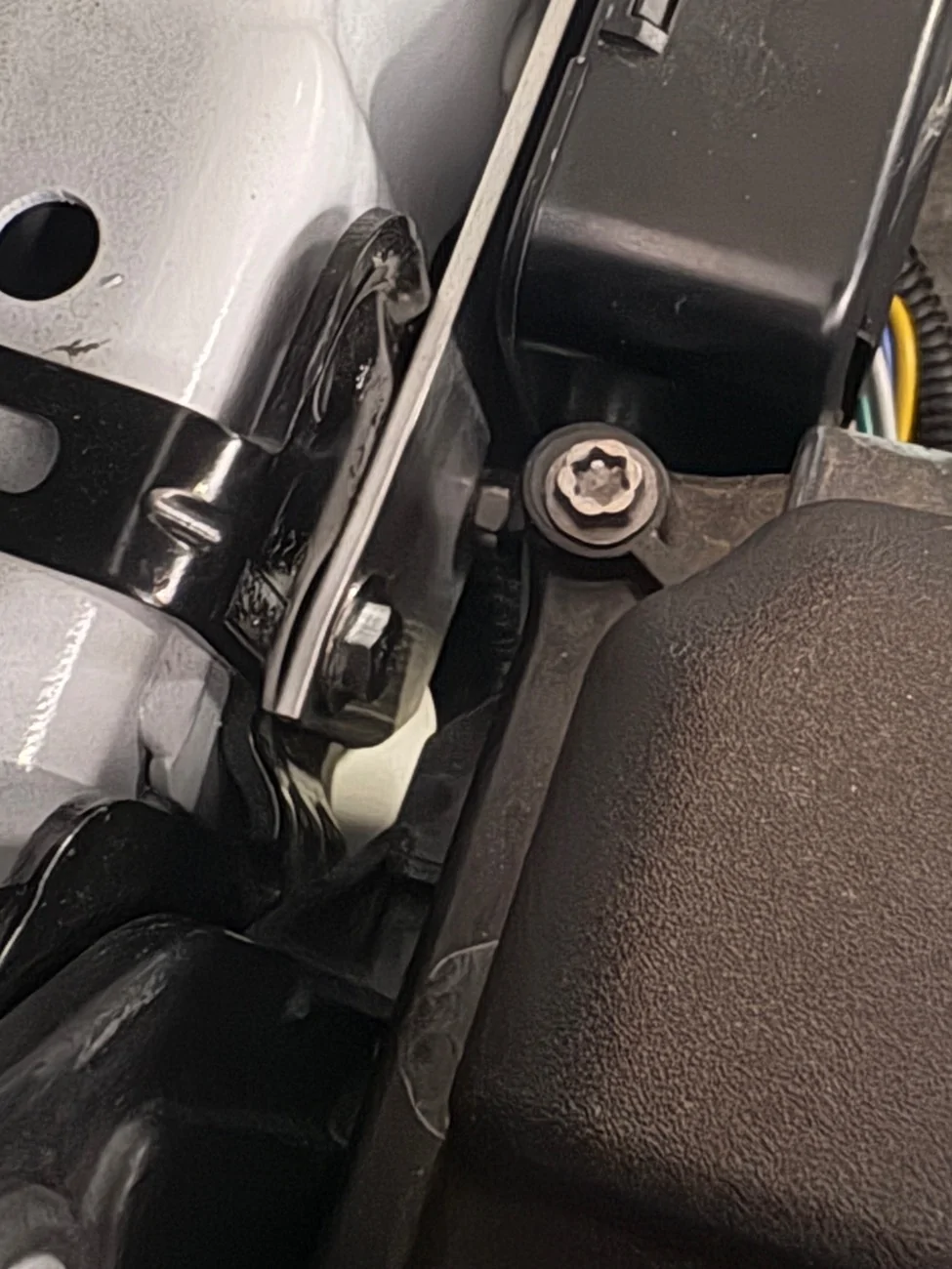

Love your auxbeam install. For the plate you have holding the auxbeam fuse box, how did you mount it to the truck? I see a factory threaded hole im guessing you used to hold the right side so was hoping you knew the thread size. what did you do on the other side?
Hey man thanks for the quesrion! I dont have the rig with me at the moemnt but Ill be sure to get back to you when Im back with it again.

As I recall I ran the bar stock far enough back that it reached another hole if memory serves me right

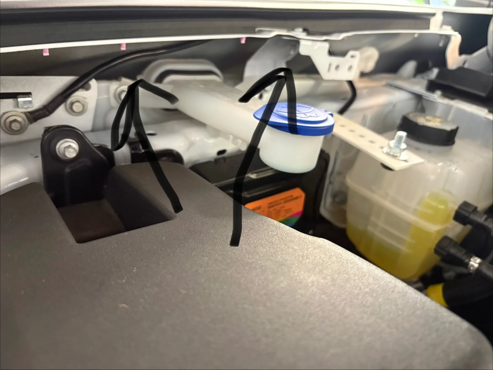

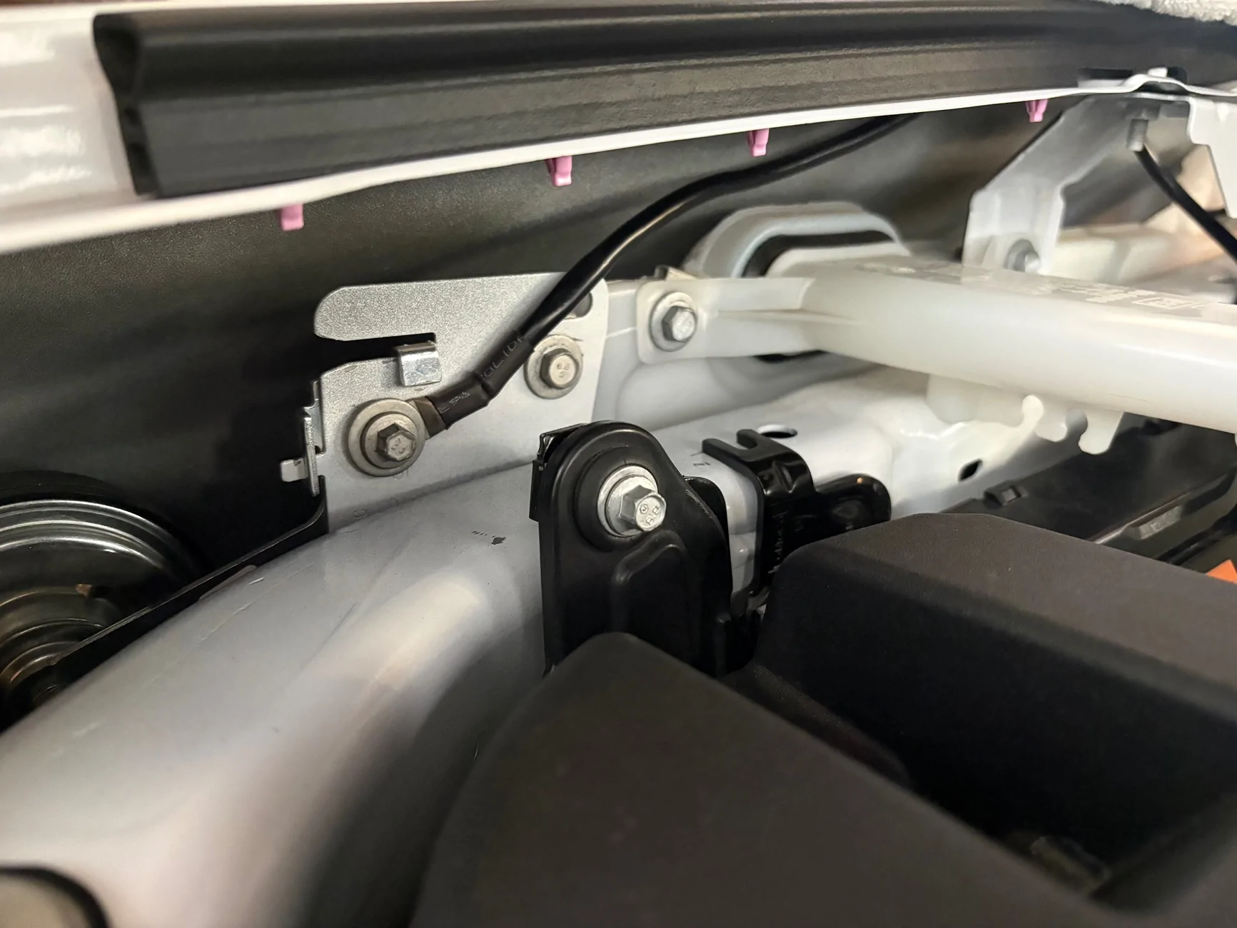

Where did you hook the ground wire for the auxbeam to?

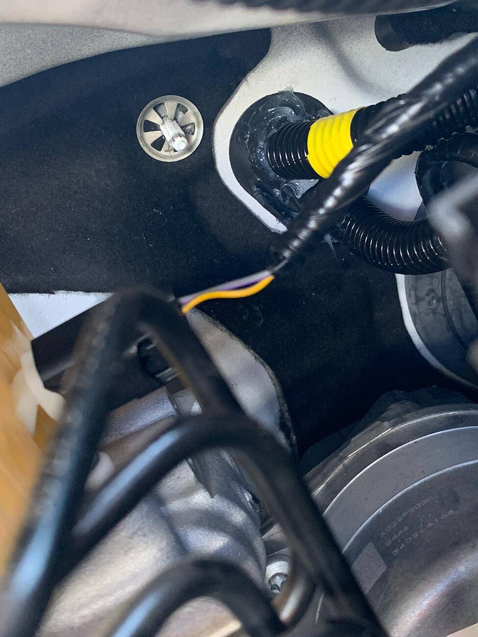

Hey dude sorry to take so long to get back to you I hope this helps. I took pictures of where the plate is mounted to.
Ford Ranger Fix4Dirt 2024 Ranger Build IMG_4740
Ford Ranger Fix4Dirt 2024 Ranger Build IMG_4741
Ford Ranger Fix4Dirt 2024 Ranger Build IMG_4742

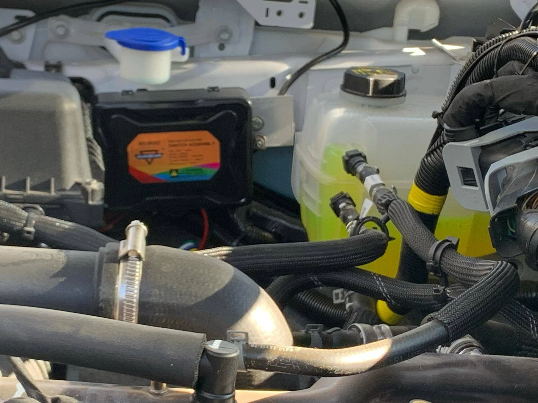

Sorry also for a late response. I have a pocture attached where it comes out of the fuse panel and its wrapped around and geounded to the bracket as shown. Hope this help!
Ford Ranger Fix4Dirt 2024 Ranger Build IMG_4744
Ford Ranger Fix4Dirt 2024 Ranger Build IMG_4743

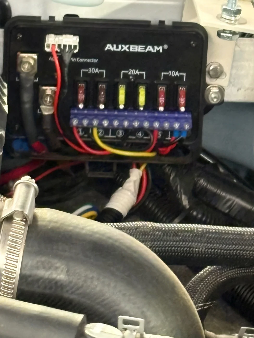

Heres a picture of the panel and the ground cable comes down and around.
Ford Ranger Fix4Dirt 2024 Ranger Build IMG_4745
