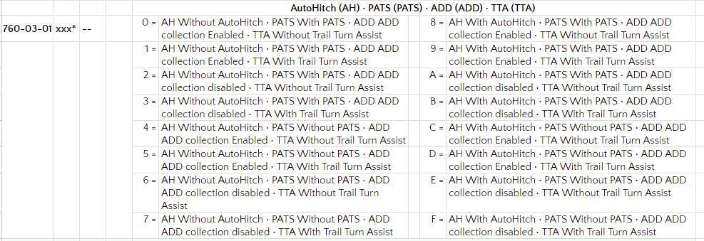

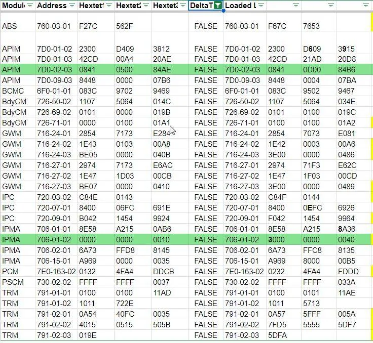

I was out camping and fishing over the weekend so I got a chance to try out the settings for Trail Turn Assist for the Raptor...
Unfortunately it was only "sort of" successful using the codes in the spreadsheet. I changed my ABS module parameter 760-03-01 from F27C 764F to F27D 764F following the listing in the spreadsheet (which is based on the F150 Raptor). It immediately gave me a checksum error when I tried to write it but I pushed on regardless and it "seemed" to take.
In trying it out, it was a bit hit and miss. I put it into 4L and the initial press of the TTA button returned a message on the dash like "Feature not available" (or something to that effect). I pressed it again and it didn't pop up message but didn't seem turn on either. I think locked and unlocked the rear diff and then turned it on again and this time it stayed on. I went for a (very) short drive and I think it worked but then immediately turned off again.
My conclusion is that this is not the correct parameter or byte or value. I then just set everything back to what it was before (and received another checksum error and all kinds of stability control not working type messages - thought the car was still in 4L). Since then, all is back to normal.
I would first update to version 63 of ForScan that has the latest non Asbuilt info.
@Sequoia , do you have an updated sheet that has the detailed As Built tables? The one I have is missing a couple. Read below to see what I mean.
Go to the "ABS-Raptor" tab on the spreadsheet, then find 760-03-01. From there, you can decode what each parameter does.
Disclaimer - those tabs on the spreadsheet were snagged from F150 forum earlier thsis year and have yet to find a new one. I've found a few parameters that are not right on those tabs, but most of them are. The ABS tab especially is a bit iffy, esp in this case.
For example, 760-03-01 is missing some bits (your value above has xxxx xx-- but the spreadsheet only has xxxx -- , so it would be nice if we could find the most up to date version of this sheet. But at any rate, TTA is listed to be xxx* on the screen shot below. Take the value "C" from your "F27C 764F" reading, and decode the C below, which mentions "without Trail Turn Assist". Change the C to a D and that activates TTA. Sequoia above though said to change the 5 to a D though, so I'm not sure which is right....

Rewrite the 7 to D. It will look like this F27C-D64F
This would make sense considering my experience above.
It would be nice if we could get the same coding information in the spreadsheet from the Bronco range of vehicles rather than the F150 range as the Ranger and Bronco are on the same platform so are probably a much closer match than the F150.

Also, BTW, the Checksum error is normal - the last two bits on every asbuilt data chunk are for the checksum and that's why they get displayed as -- rather than xx in this spreadsheet and most others you'll encounter. Forscan automatically recalculates those when you make any change to any other value. The Forscan forum has some wikis that explain a lot of how it all works.

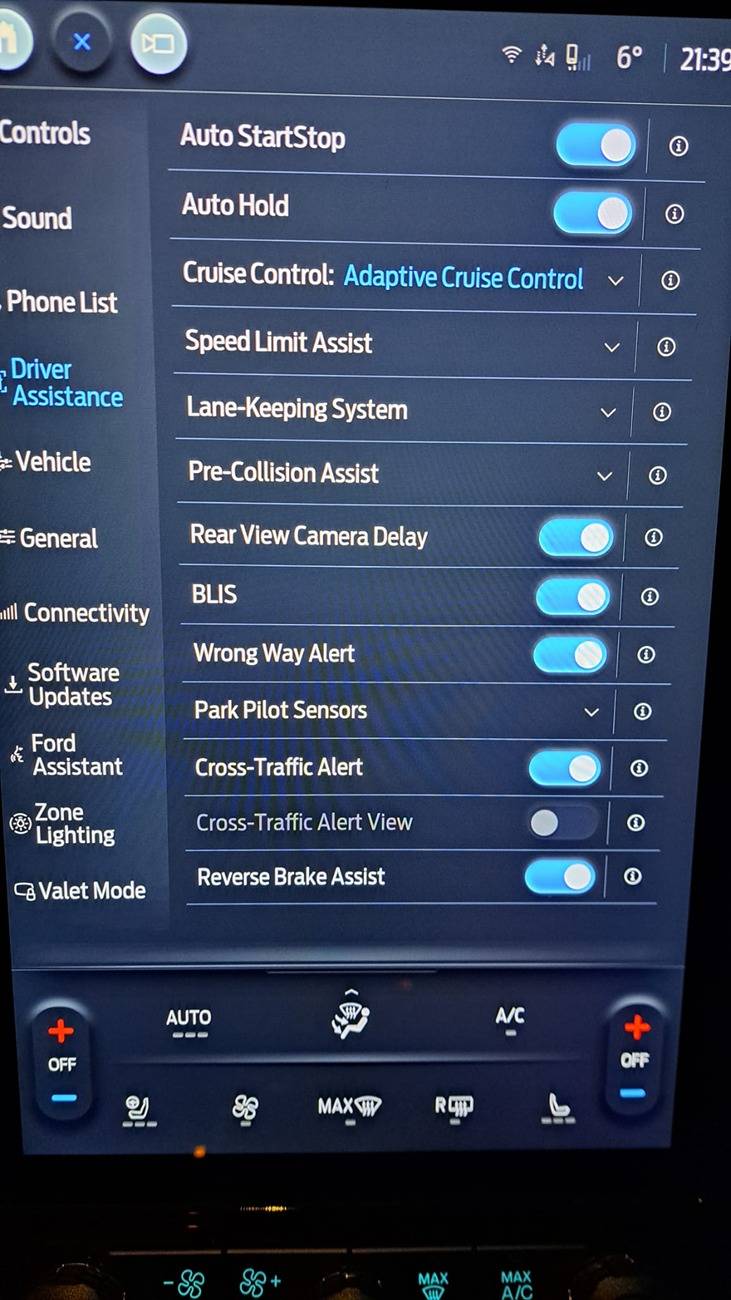

I found this on Facebook, does anyone know how to activate this function?
cross traffic alert view

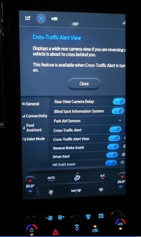

I quickly got into the car and checked. APIM.
Ford Ranger FORScan NA Ranger 6th Gen (2024+) Crowdsourced Spreadsheet Bildschirmfoto 2024-12-16 um 20.59.29
After that, the menu option appeared.

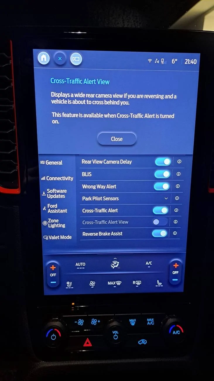

Yeah. Same here. I already had activated everything around cross traffic alert in IPMA, IPC and APIM.
but still greyed out.
Any ideas?

Unfortunately, I don’t quite understand what you mean.
I do have cameras. It’s just about the wide-angle camera being activated when there is cross traffic, meaning that the normal camera view switches to wide-angle.
