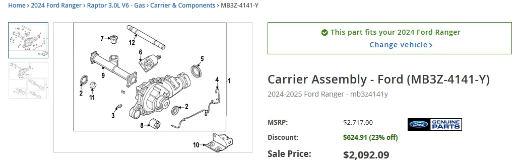

I visited the dealership this morning and talked to the Service Manager for my RR. He said that the first repair was a completely new front differential unit. He also said that the current (2nd) problem was the right front axle. Parts are ordered and my RR should be "fixed" again tomorrow if all goes well.
The S. Mngr. suspects that the rt. front axle was cracked during the first failure and then broke completely near the CV joint when I drove it a few miles after the front differential was replaced. He maintains, despite the second failure, once the axle is replaced the truck will be safe to drive and not a problem as far as future collateral damage that will results from the two front end failures.
I am still wondering why I was able to hear a slight whirring noise after the front differential was replaced while I drove it home from the dealership. Was this noise from a cracked front axle? And, if the crack wasn't obvious enough to spot during the repair or the dealership's test drive, why did it break completely while be gently driven in 2H after the front diff replacement?
When I pick it up this time I will be test driving my truck in every possible mode, while listening for any sounds that weren't there before the original front end failure. I hope there aren't any and I can begin to trust my truck again.

Update--Today at noon I contacted the Ford Dealership. They had received the new right axle and parts but when they took a closer look and started the repair, they discovered that the newly replaced front differential was actually trashed for the second time. Unfortunately, there are not any more front diff units currently available. Ford is "projecting" they will be available starting December 12. The dealer is saying that lack of parts inventory may be due to more demand for replacement front diffs due to a defect in some of the Raptor trucks like mine.
