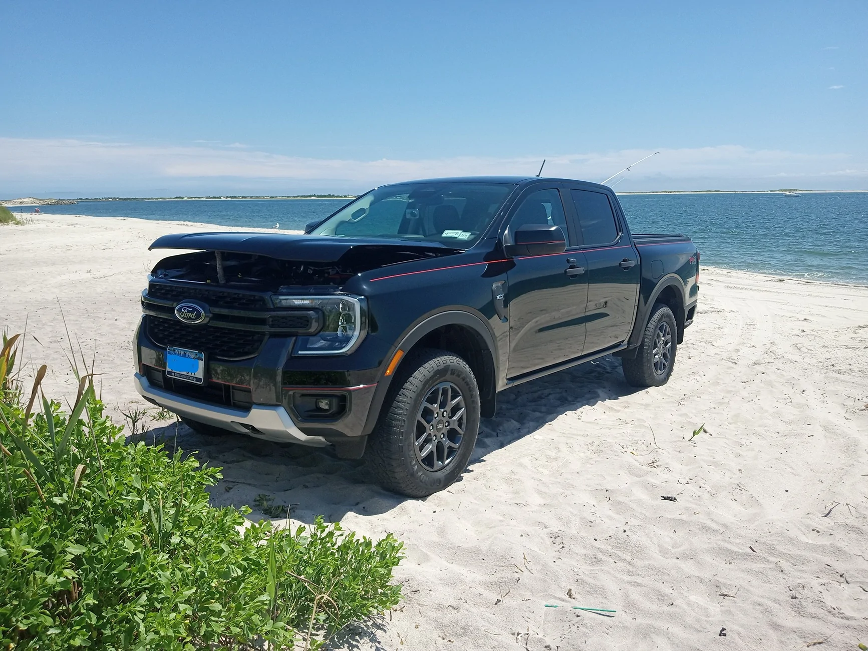

Went off roading on the beach placed the drive mode into sand. Lots of fun, but when I came off the beach and placed the drive mode into 2H normal and the rear locking differential stayed locked.
To disengage the differential for street driving, I had to go into the off road menu and deselect locking differential.
Is this the normal way to unlock the rear diff? I would think by selecting 2H normal the vehicle should reset the drive mode including unlocking the rear diff.

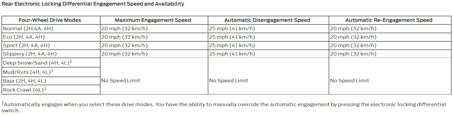

Looking at the manual, I see instances where it will automatically disengage, as in normal modes above 25 MPH, and auto-engages in sand mode. But I don't see that it disengages when move out of sand mode, which seems odd.
I saw the manual but I'm puzzled why it doesn't unlock when you put it in nirmal
