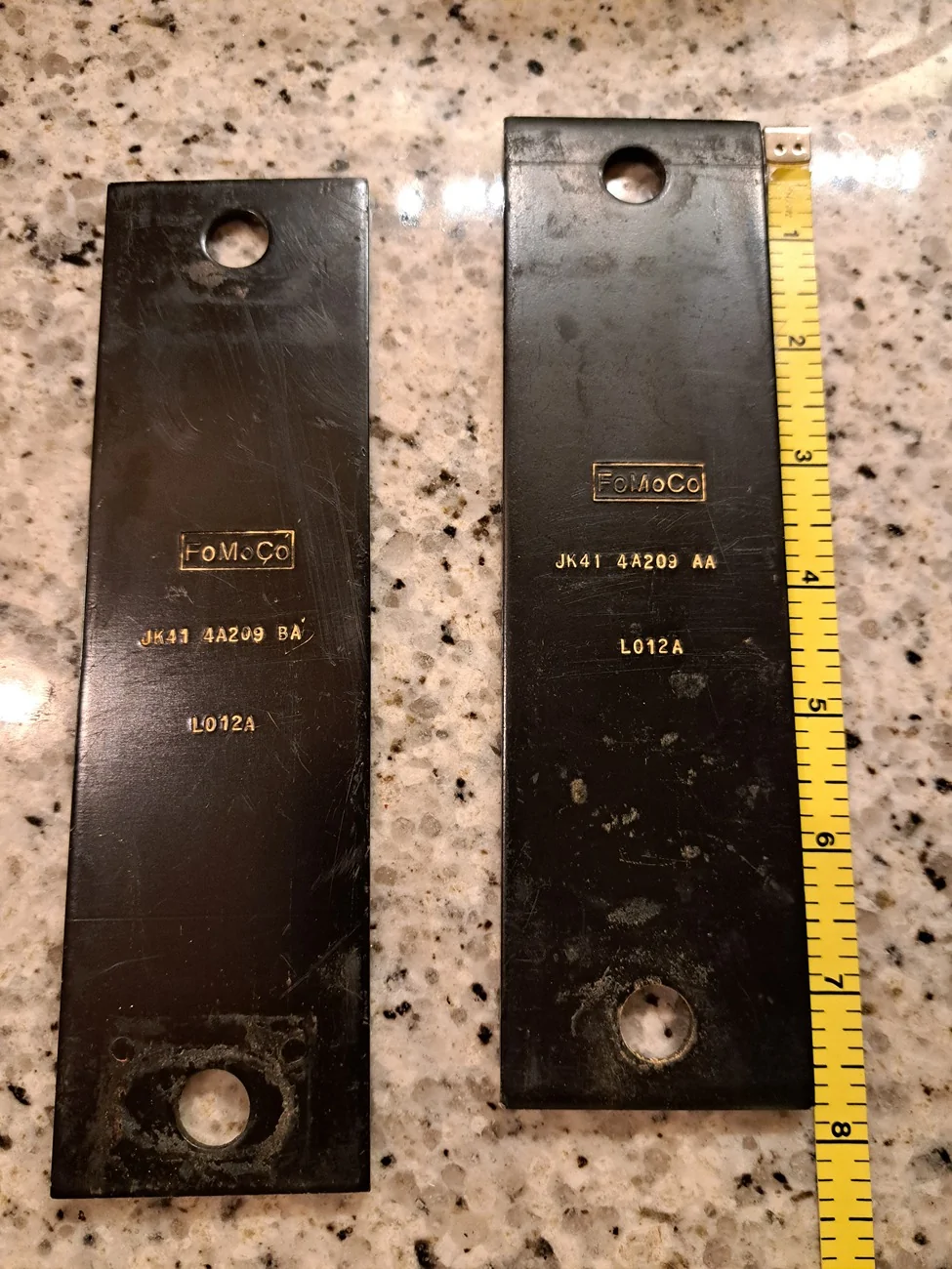

Ok, I suppose both could be used if needed.
I might have used washer(s) for my former Tacoma. A $15 magnet protector was handy too.
