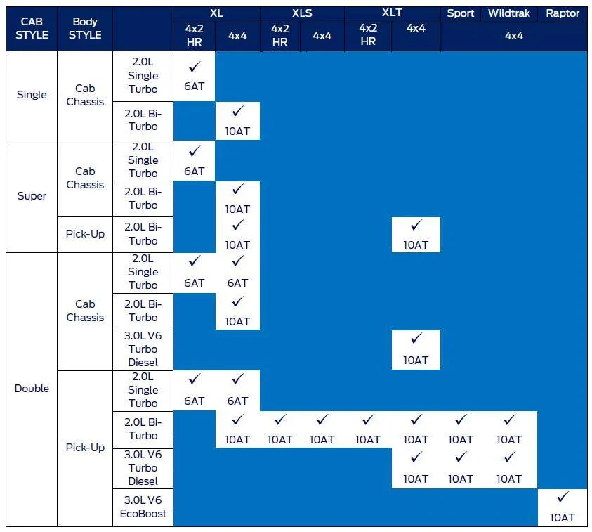

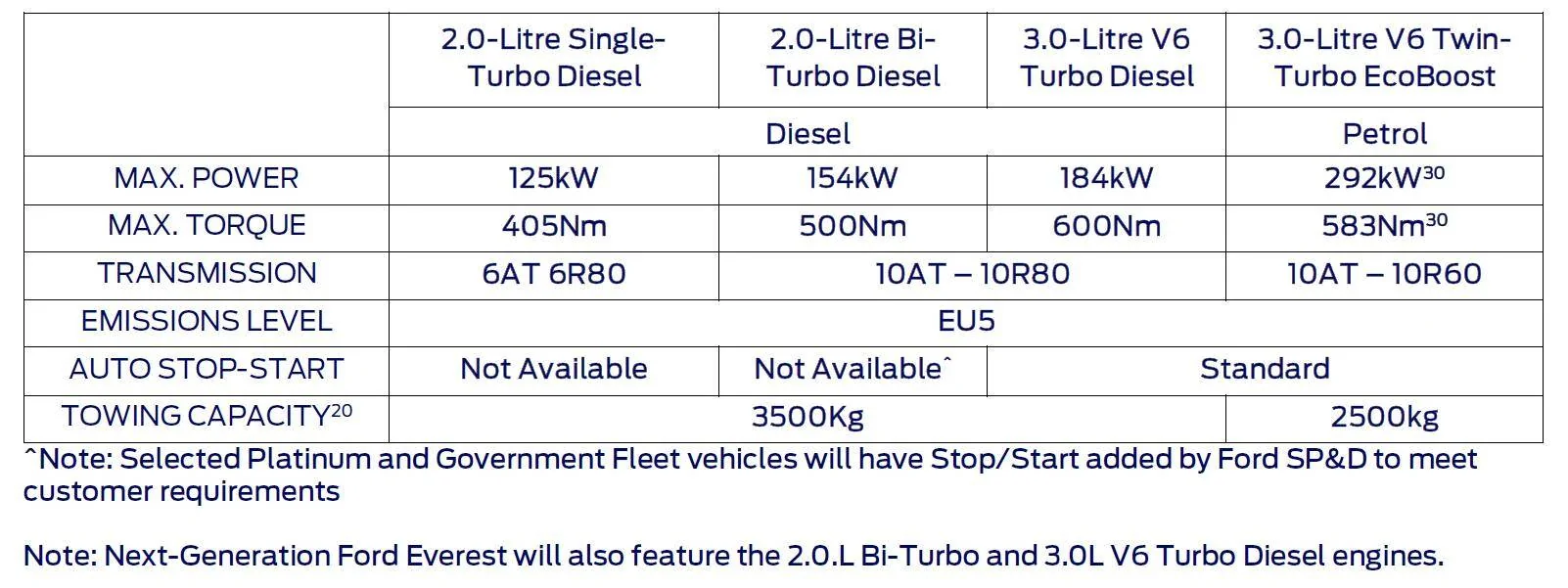

This is correct, generally speaking we really have never had choices for axle ratios or differential models, it's always been a case of 'you'll get what you're given'.
These tables show what engines come with what driveline in Australia.

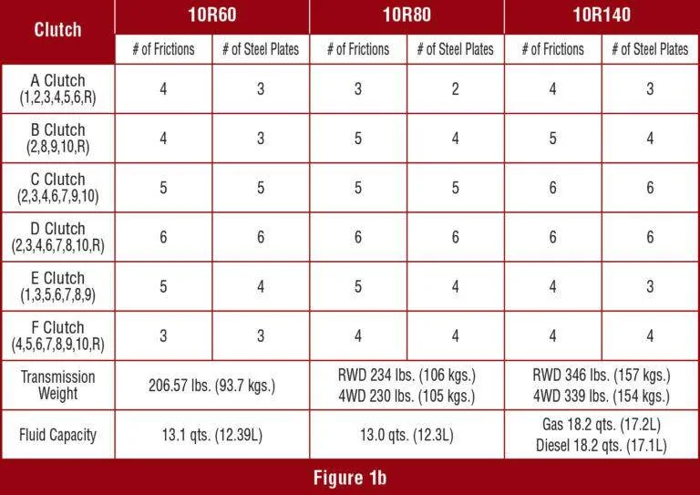

Hey, don't know why Ford would put a maxed out Trans in the Raptor from the git...
In its hottest current form, the 2.7 produces 335 horsepower and 380 pound-feet of torque, while the 3.0 produces 400 horsepower and 415 pound-feet of torque.
ACCORDING TO GEARS MAGAZINE:
The 10R60 is the latest addition to the 10R family. With a maximum input torque rating of 443 ft-lbs (600Nm), it is specifically designed for the lowest torque output engines Ford manufactures. Introduced in the new 2021 Ford Bronco, the unit is lighter and physically smaller than the 10R80, implying better fuel efficiency.
In 2017, Ford used the 10R80 paired with the 3.5L Ecoboost V6 in their best-selling truck, the F-150. It was versatile enough to be later placed with the 2.7L turbocharged engine through the 5.0L V8 applications. With an input torque rating of 590 ft-lbs. (800 Nm), the 10R80 covered a wide range of engine applications .
Ford Ranger Front Differential 1669658396649
