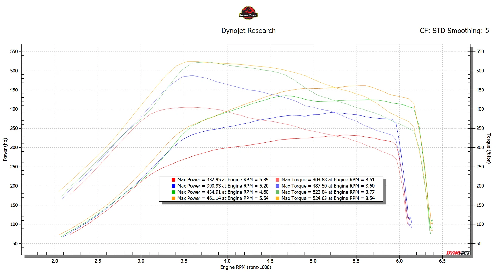

Hey man,
Over the FP tune, usually about 40-50hp and 30-40wtq
Below is the dyno chart where I tested this (on 91oct)
Red = Stock
Blue = Ford ProCal
Green = My 91 tune
Orange = My E40 tune
Ford Ranger Goosetuned Tuning R&D - Ranger/Bronco 3.0 Raptor +300hp! Stock vs Procal vs goose S1 91 vs goose S1 e40

Nice, substantial gains over FP Procal. I'm in Texas so I have 93 all over. I see on your websites the standard options are 91/E40. Would it be fine to run the 91 tune on 93 octane? How much more power can a 93 mapped tune squeeze out, if any? Would you be able to provide a 93 octane tune as one of the standard options in the future or would I need to pay extra for the 93 octane map?
I'm using 93 on the Procal 91 tune, so I'd assume is fine. In Austin it's either 93 or 89 lol.

93 on a 91 tune is fine. To a point more octane is usually better. I ran 93 on the FP tune as well. The hp question has been asked before, I think 93 is worth another 20 hp +/-. As is the S&B intake.

No you'll want to run 93 or higher. If you get a 91 tune you can run 91 or higher.
93 should be a standard option, if not I'll have to modify that!
Yep, 93 on a 91 tune is ok.
