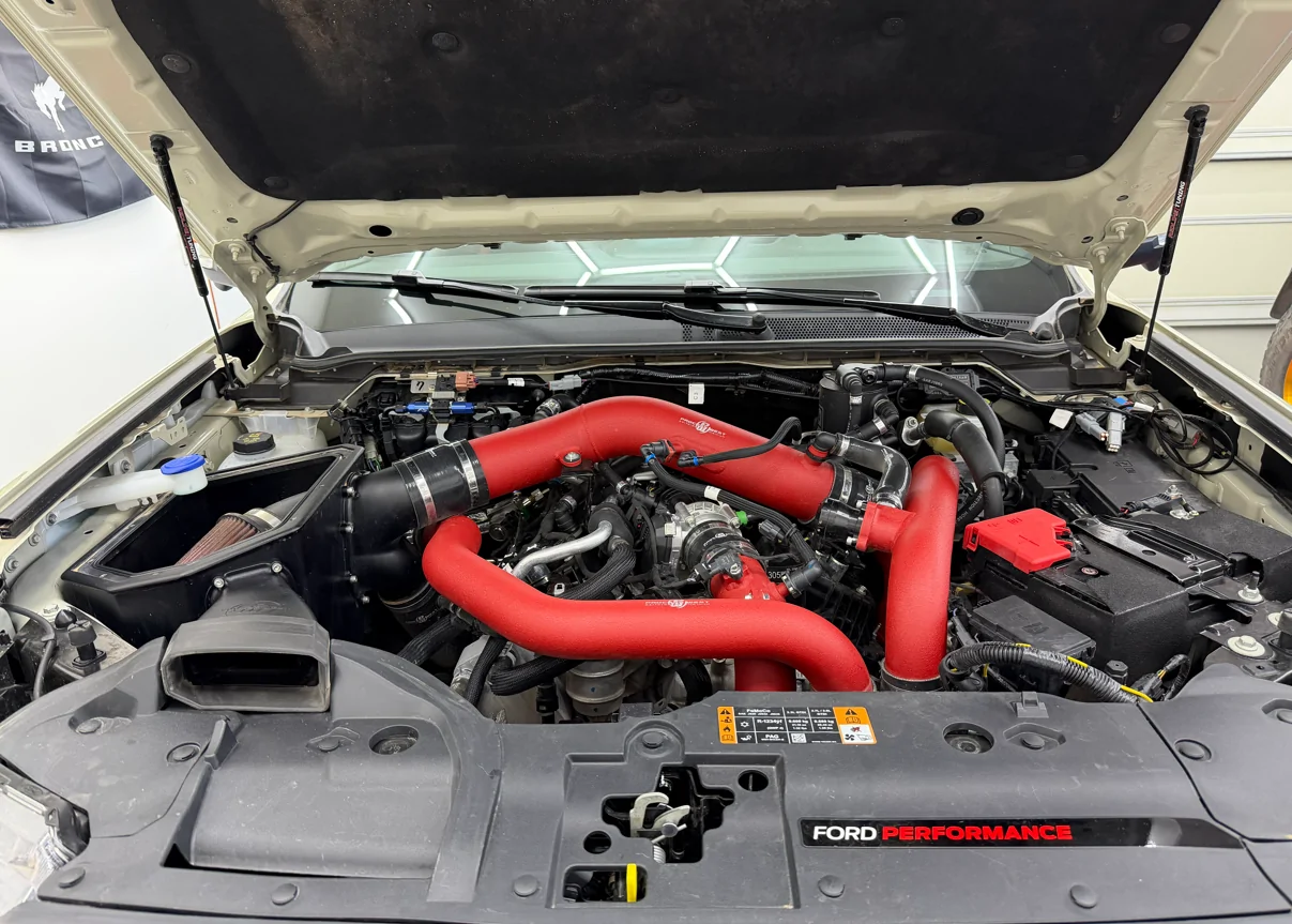

I've been absolutely LOVING the Ranger Raptor as it sits!
0 issues, 100% total fun.
Ford Ranger Goosetuned Tuning R&D - Ranger/Bronco 3.0 Raptor +300hp! 1787503055565-07
Ford Ranger Goosetuned Tuning R&D - Ranger/Bronco 3.0 Raptor +300hp! 1787503166712-jr
The Garrett PowerMax turbos are what I'd consider PERFECT for the daily driver that wants stock spool, great power up top, all while not stressing the turbos keeping them happy when tuned properly.
Once you get to adding ethanol, the power is even more insane!

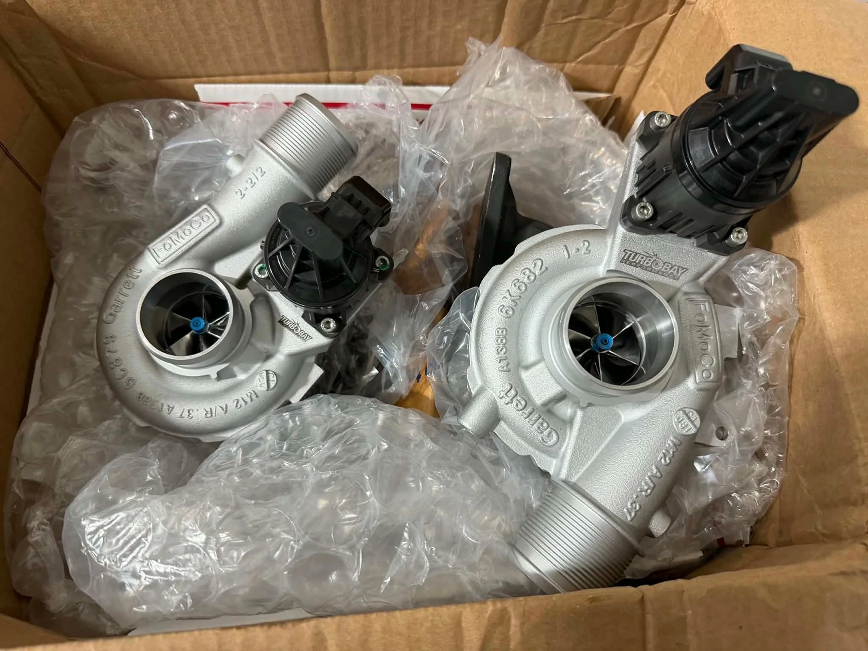

I reached out to a few turbo builders in search for bigger (stock location for now) turbos that may make more power *WHILE KEEPING STOCK SPOOL*. Spool characteristics are most important to me as I use the truck for mainly off-roading! TurboBay Matt said he wanted to try a few new things, so I bit.
With that said, I had a modified stock turbo set spec'd with what I feel would be the even more-perfect set, if all goes well. Stock spool, and 650-675whp ratings on Ethanol, 525-550whp on 91. At altitude turbo speeds need to come down for longevity, and the abuse this truck will see should easily be able to show this pretty quickly. This isn't a dyno queen as you guys know. I use my truck, I abuse my truck.
Ford Ranger Goosetuned Tuning R&D - Ranger/Bronco 3.0 Raptor +300hp! 1787503264528-mo
I have another R&D truck that I will likely move the PowerMax turbos to, but this set will be going on asap. I'll keep you guys updated!

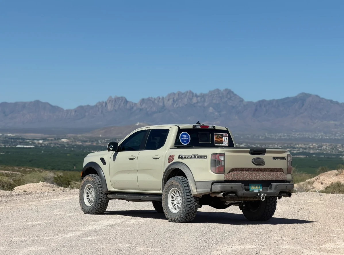

That build is turning out great. What size tires are those and what suspension setup is it on now? I know there is one through the bed long travel option already from foutz but thats gonna be cool to see what SVC does.

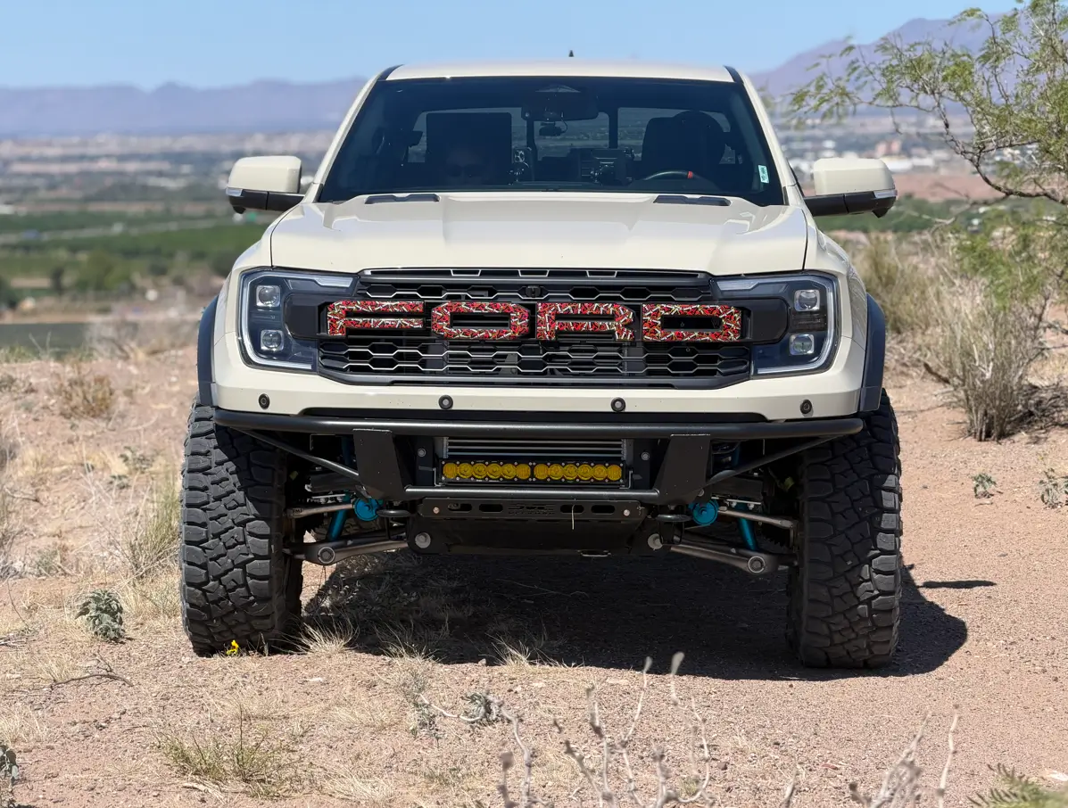

https://www.foutzmotorsports.com/co...rganizer-with-3-0-x-14-coil-over-main-section
Thank you!!
The truck has Toyo 35 x 12.5 x 17, on King 2.5s.
I've seen Bubbas truck (rode in it and tuned it at TRR) but his was on Portals.
I want to keep the factory leveling w/long travel
