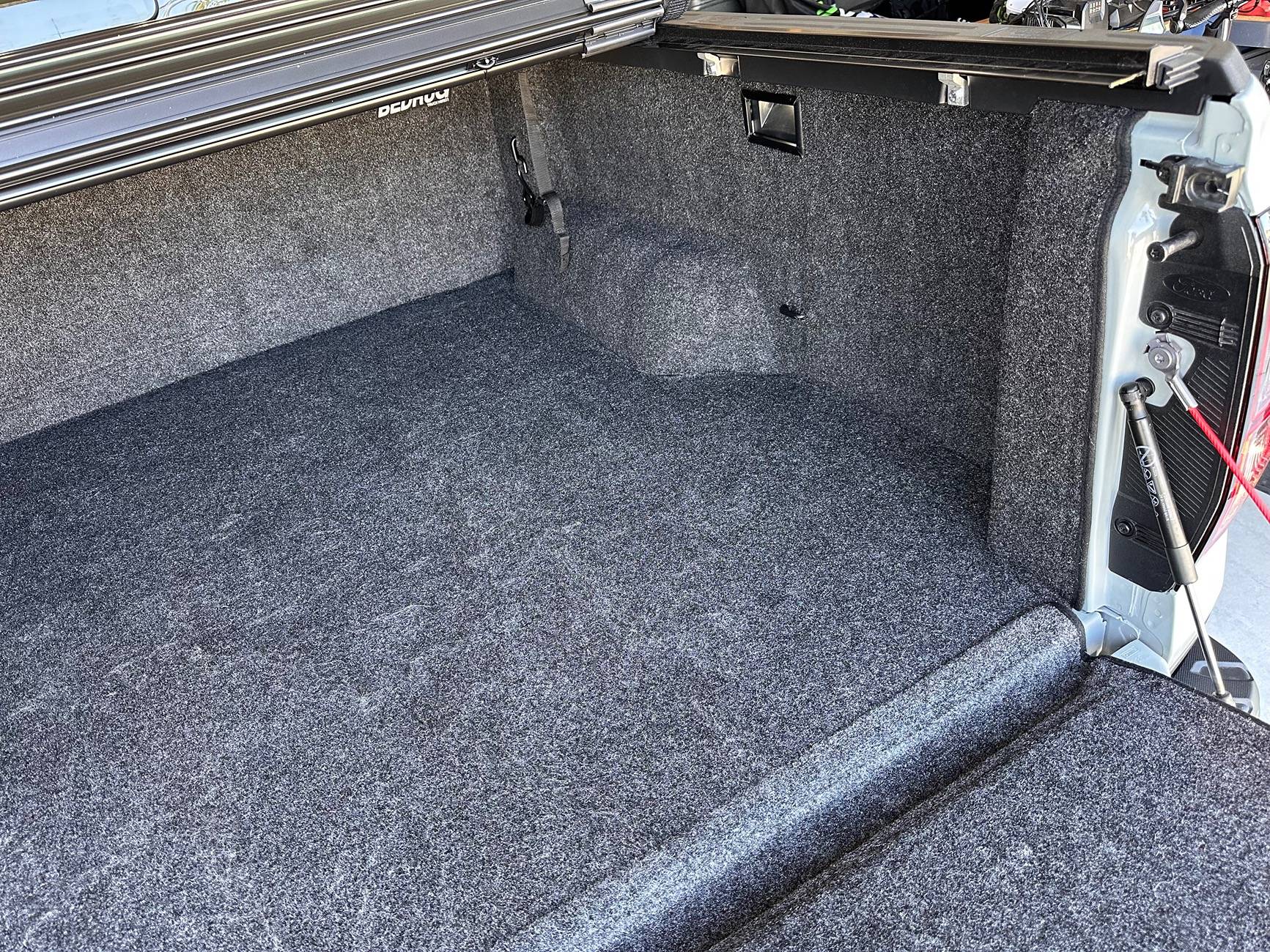

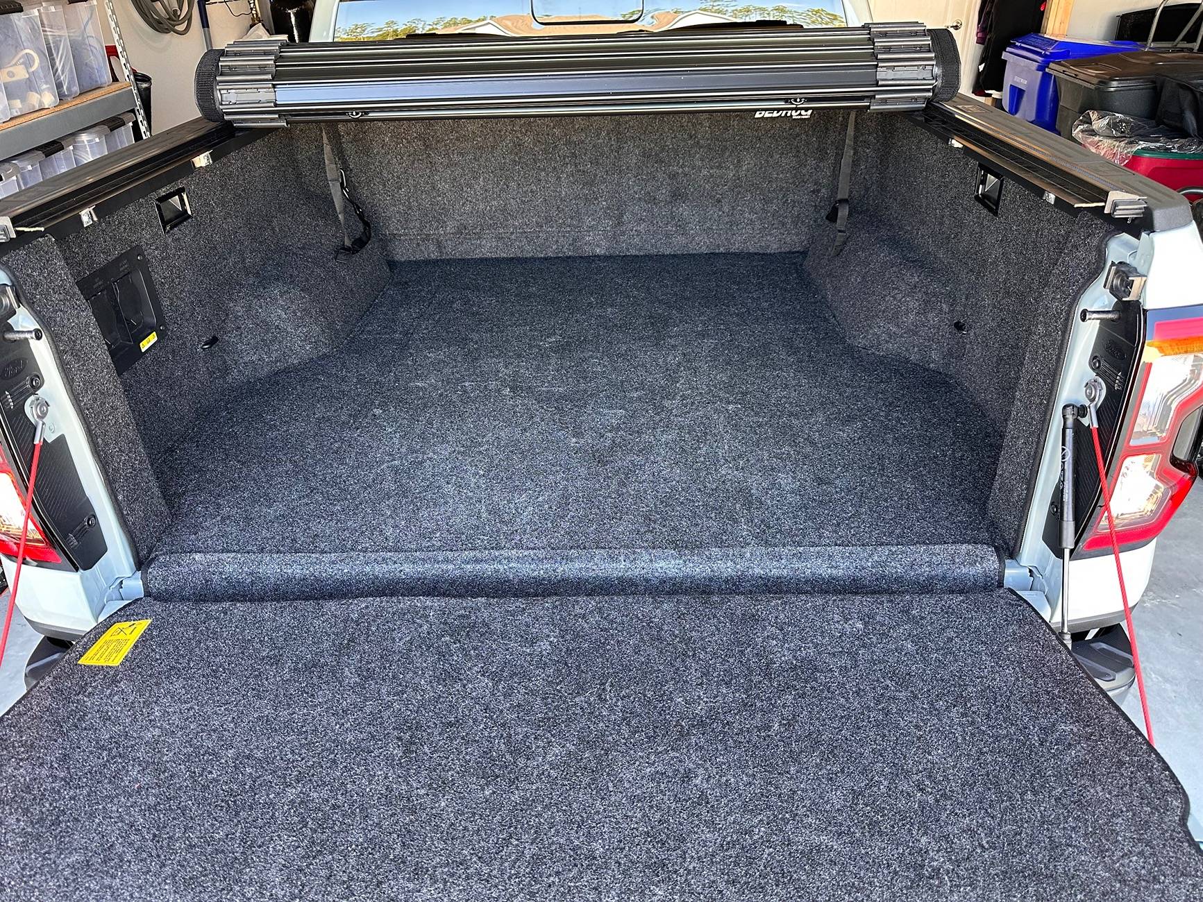

I got my bedrug and X4s cover installed. Both fit very well. The bedrug took the longest. I will have to look at the bed lights when I install the J-Braces. They had something holding them on the outside after taking the two screws out.

pretty straight forward. I cut slits for the bed tie downs instead of taking them off and bolting them over the bedrug. Stiil have to work on the bedlights. The cover was very easy to install and I think it will work with the accessory rail setup.

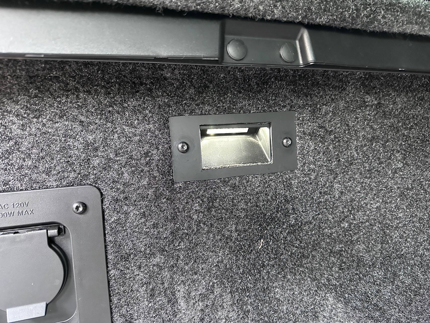

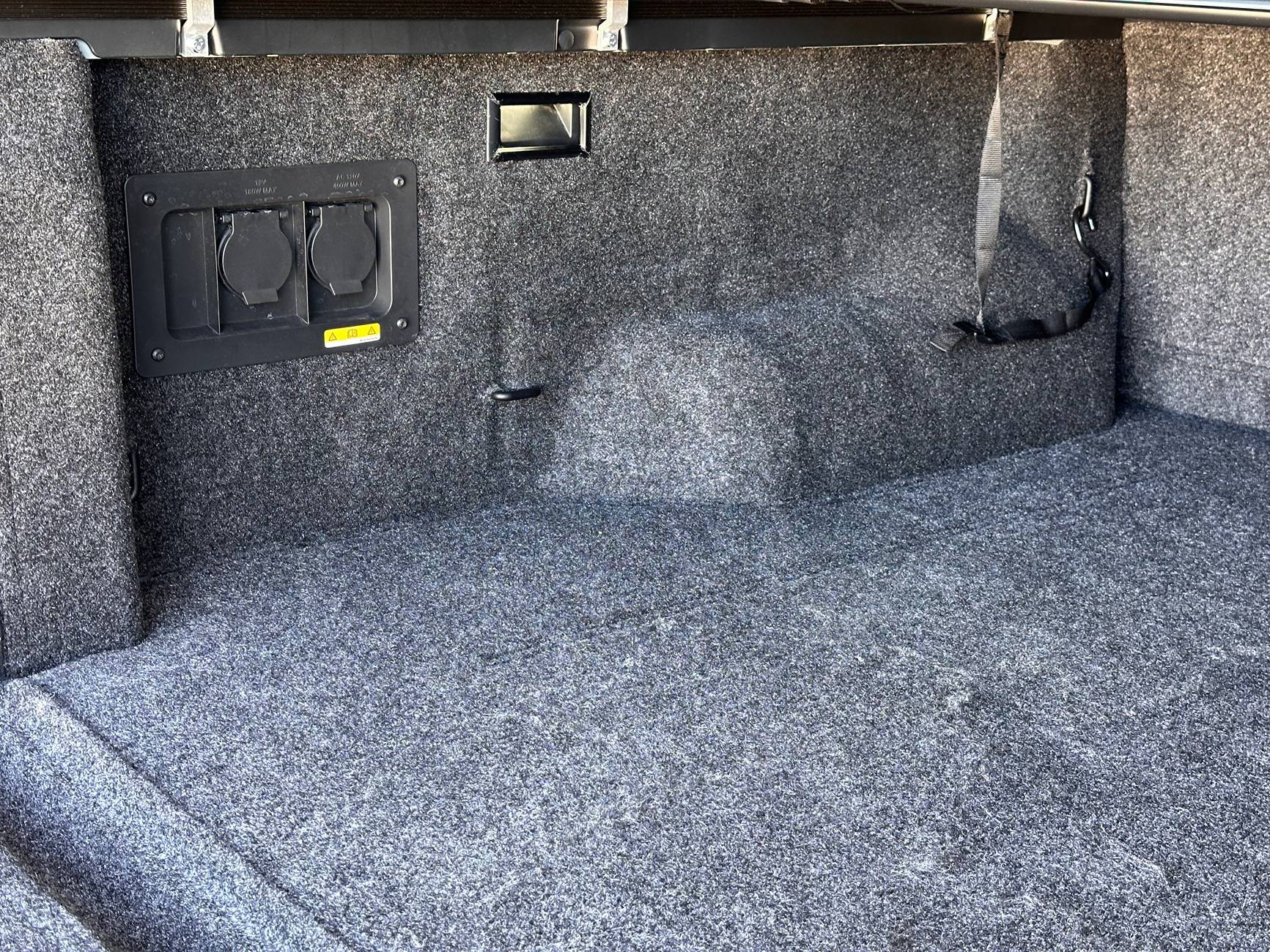

I have exactly same bedding and x4 cover. I added frame around LED opening using cheap wallpaper frame from Walmart. Also it requires more effort to close gate due to fabric between bed and gate.

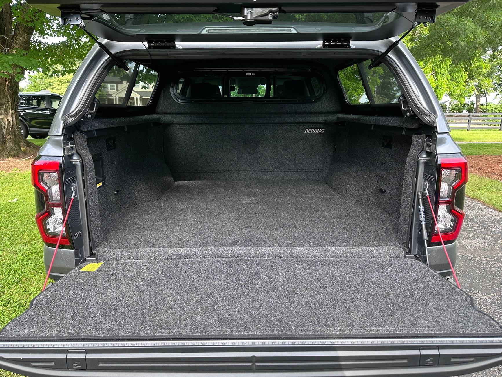

I also had trouble getting the tie-downs out without ruining the screw heads so I just cut slits for those. For the cargo lights, I got a small sheet of 16 gauge metal from Home Depot and made two cover plates instead of trying to get to the backside to find the release clips others mentioned. Just used a jigsaw, dremel, drill, and paint. Used the same screws.
