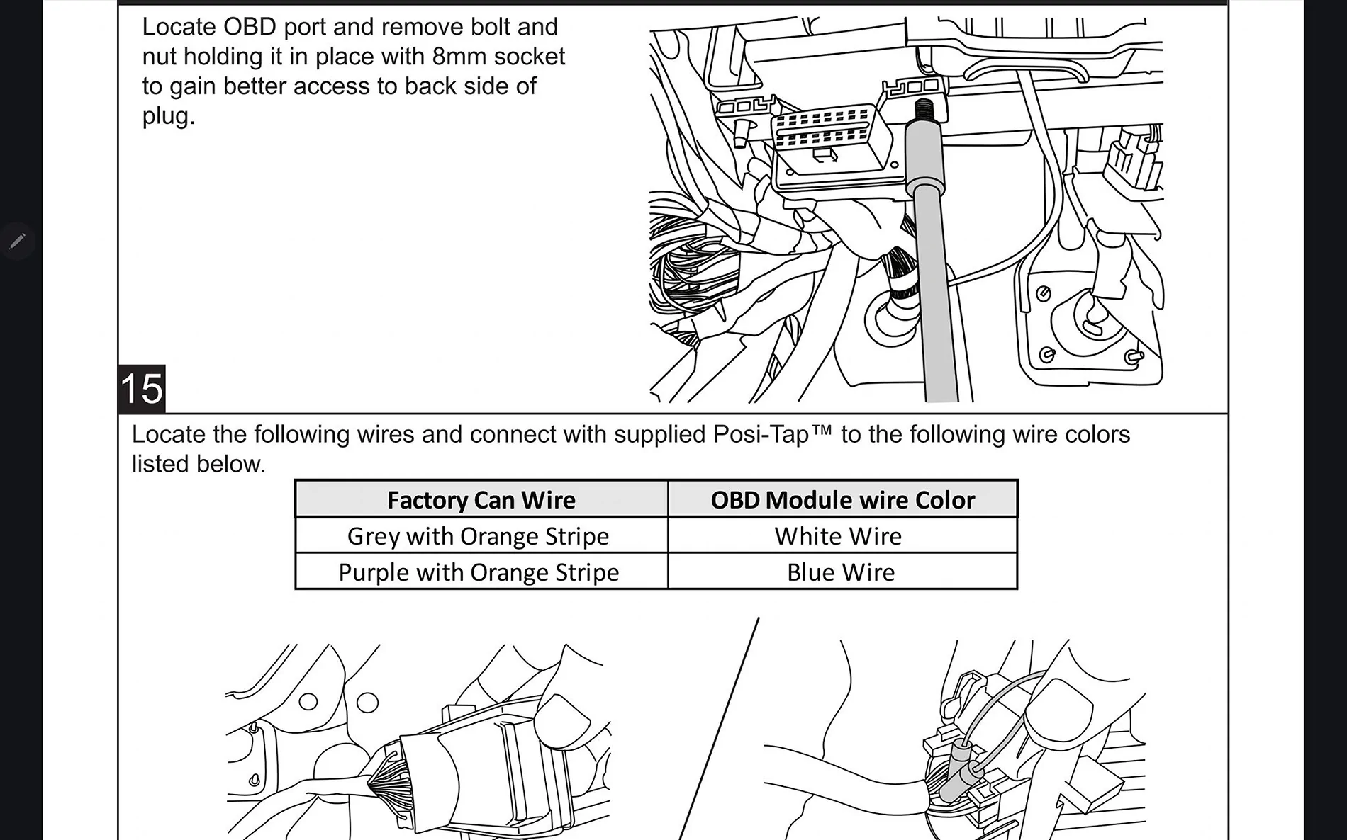

Has anyone installed Amp research power strip vision running boards? The instructions suck!! I have to tap 2 wires on the OBD port but the instructions show a different ODB port that has a 8mm screw holding it in. Mine (25 Lariat 2.7L)
Ford Ranger Has anyone installed Amp research power strip vision running boards? 640327997_10226685261232173_8103038545289858621_n
just clips out and I do not have the two colored wires that I'm supposed to tap. Maybe the instructions are for an older ranger I don't know but I'm stuck now till I figure out which wires the tap. Here's a pic of what I'm talking about from the instructions.

Where did you buy these from? And are the instructions specific to Ranger?

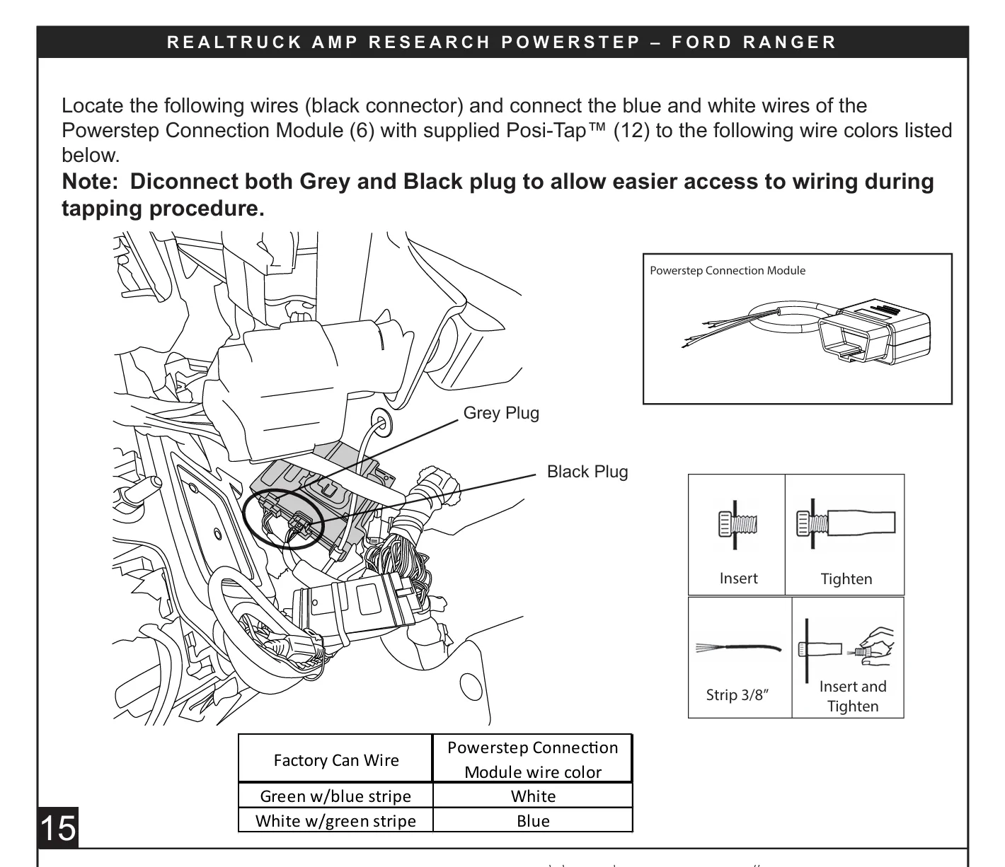

The instructions for these on Realtruck says differently. Refer to page 11
40169a3568b0f9af97ab2b41ed6ca222.pdf
Thanks, there was a code to scan in the box so that's what I was working with. Support sent me this correct manual today. I got the boards installed but the Bluetooth app isn't working so they're sending me a new obd plug.
