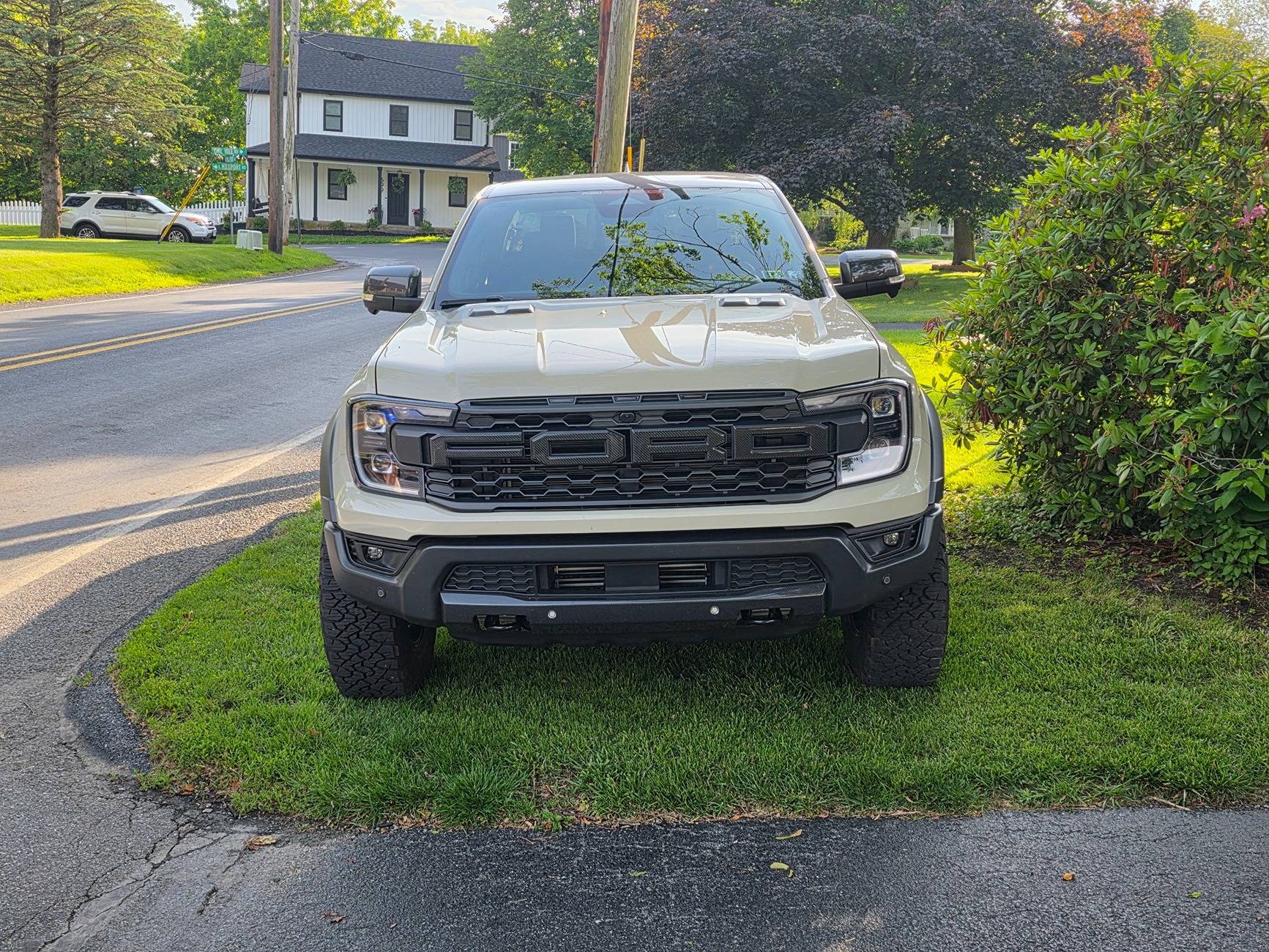

Hi Everyone, I’m looking to get new wheels for my Shelter Green RR. I’m going to keep the tires. I don’t know much about offsets, wheel sizes and fit etc so I was hoping some of you could help me. I like these wheels from RRW (https://www.relationsracewheels.com/collections/rr7-flow-form-wheels/products/rr7-h-flow-form-hybrid-beadlock-wheel-matte-bronze?variant=42002798870610)
The support there suggested
17x8.5 | 6x139.7 | +25 | 5.73" I’m not sure if this the size he’s really suggesting or these are the numbers that came up on the site. Would these fit?
Also he suggested +25 and again I’m not that familiar with how much these would poke out? I live in Maryland and it says modifications to wheel width and offset must not extend beyond the original fender line of the vehicle. I know they don’t enforce this very mush as I see truck etc that poke out very far all the time. I’m not really interested in poking out very far. Somewhere else it suggested +12. It seems that would be a little but not too much?
Any help with this would be very much appreciated.

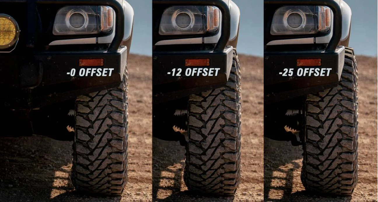

So just to show how little I know about this stuff. I'm confused now. Most are says +25 or better +35 would push them out a bit? But when I look at the wheel website it shows this...
Ford Ranger Help getting new wheels Screenshot 2025-05-31 at 9.47.11 AM
A negative number pushing it out. What am I missing?

Play w the calculator. The lower the number the more they will stick out. Factory is +55. As the number goes lower than that they will stick out more. Wheel width also factors into how much they stick out which is why the calculators are helpful.
Now you're getting into negative offsets which poke out even further...... minus 12 and minus 25.
You need a positive offset probably +18, +25 or +35.
Ok. I think I'm getting it. It's all relative to the stock offset of +55?
