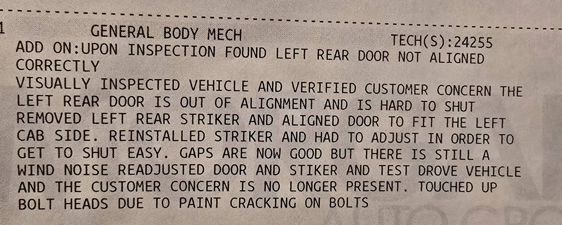

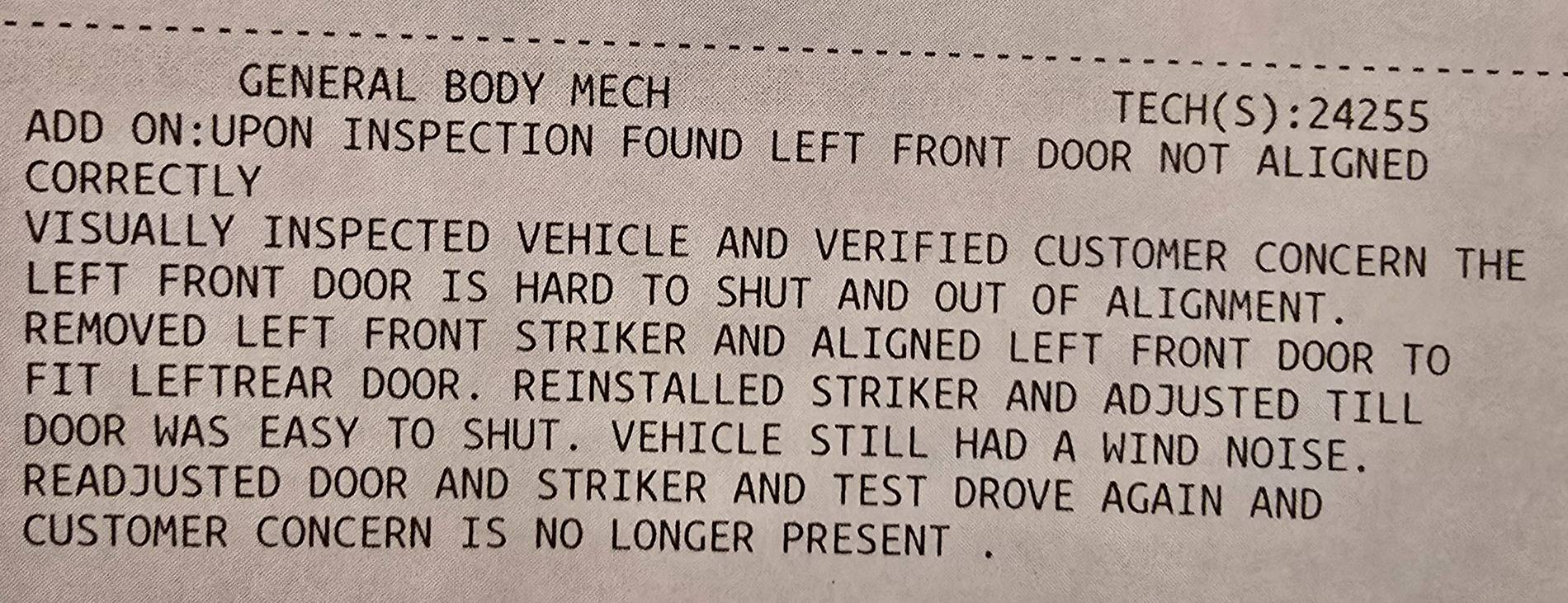

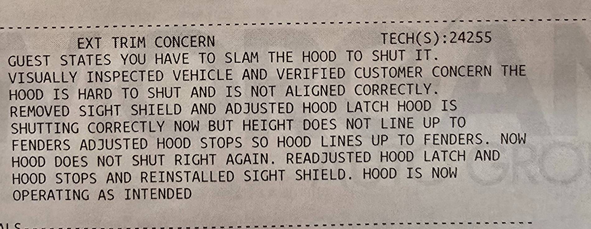

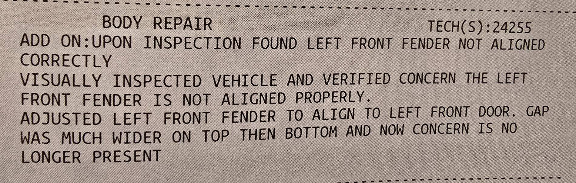

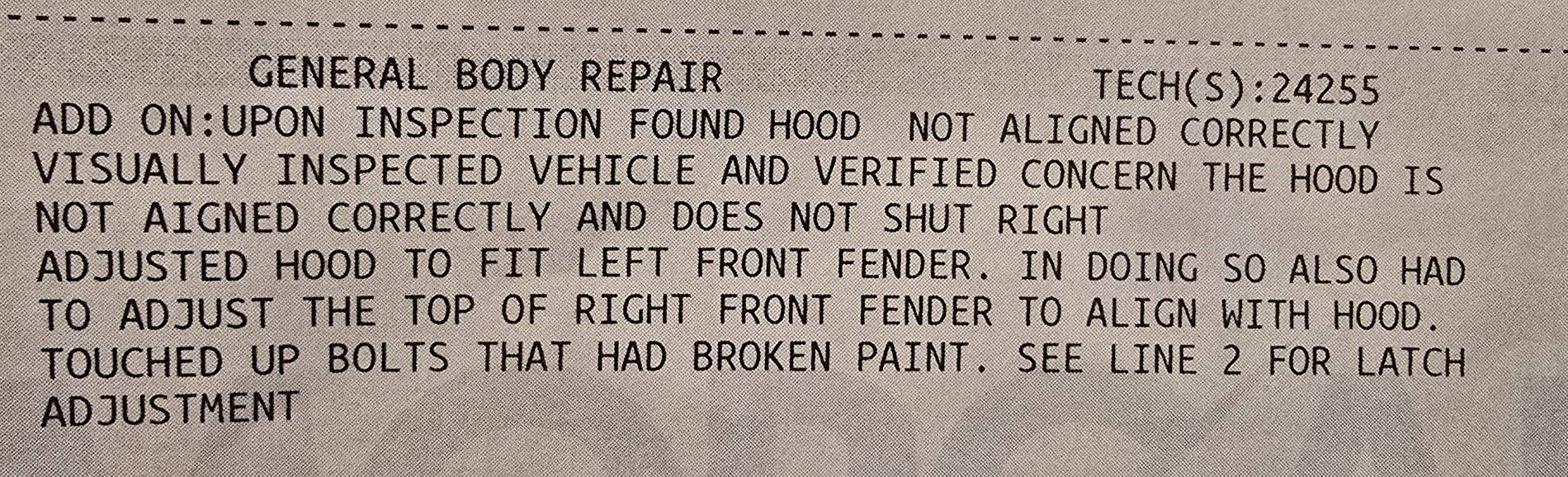

Ford posted they no longer monitor this forum but I'm sure someone has eyes on it, and they just don't reply anymore.
My dealer was able to get all my body alignment concerns covered under warranty and did a great job of fixing everything.
