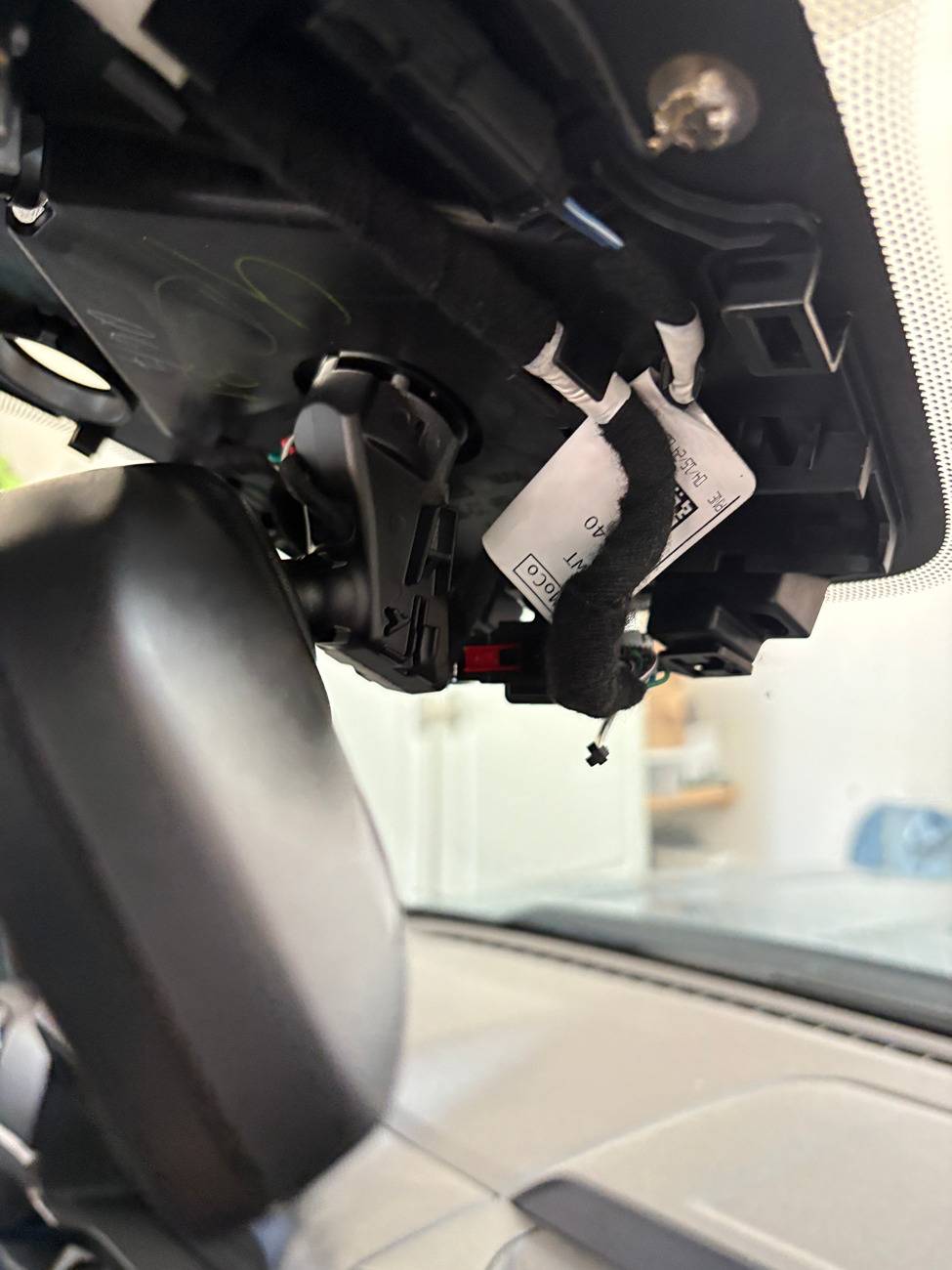

Trim I want to remove trying to replace stock mirror with WOlfBox digital mirror and no use the straps
Ford Ranger how to remove trim around rearview mirror windshield mounting point IMG_0491

There are pics if your search dash cam. It's in 2 pieces. Take smaller piece out by pulling down then the bigger piece pops down. I got a plastic flatbar with my dashcam and got another with my wire tap. Makes things easier.

Check out flaberdoopin on YouTube he has a long video(34 min) on installing a dash cam(not Wolfbox) in which he goes over it in detail.

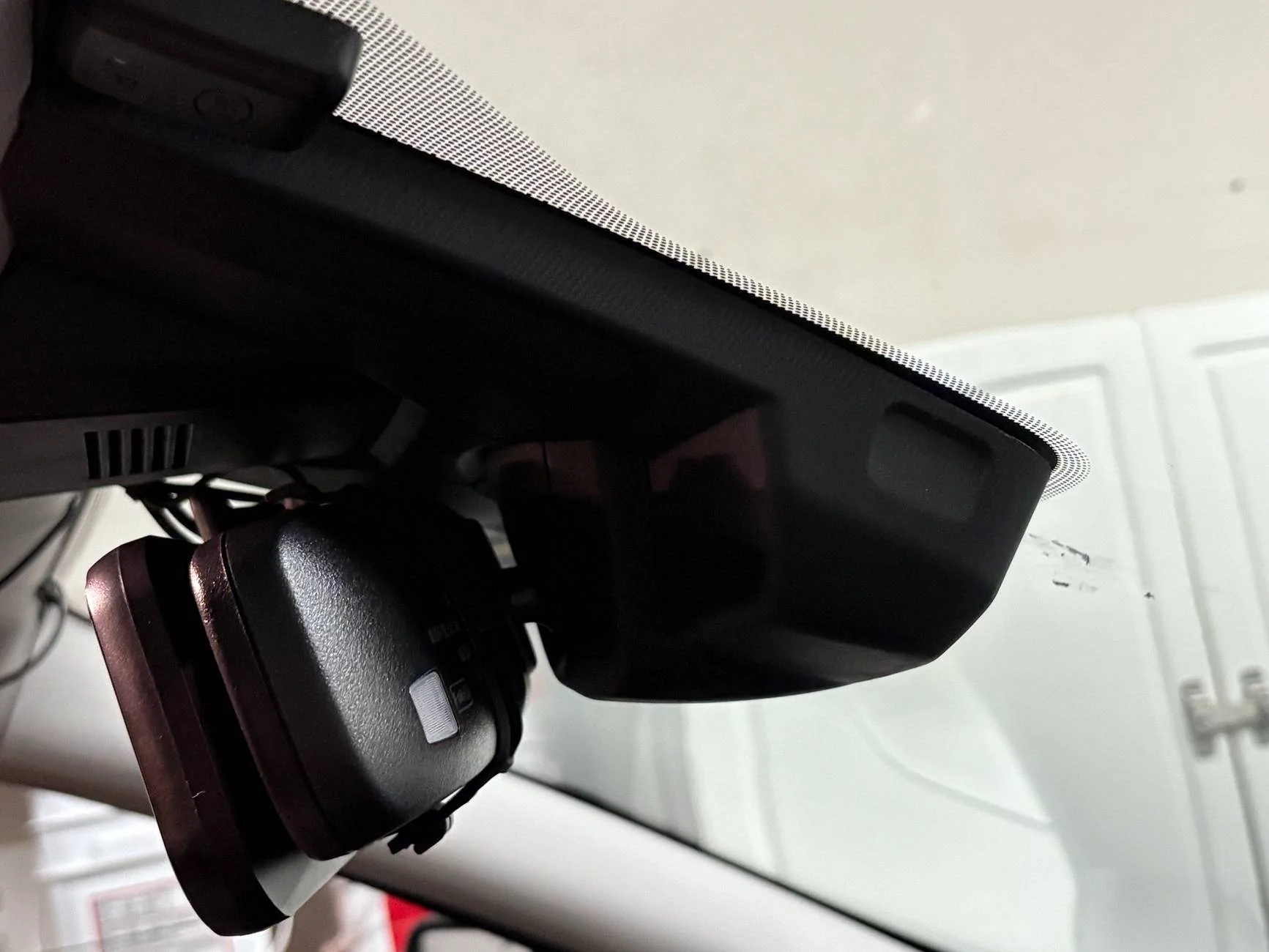

Ford Ranger how to remove trim around rearview mirror windshield mounting point IMG_0522

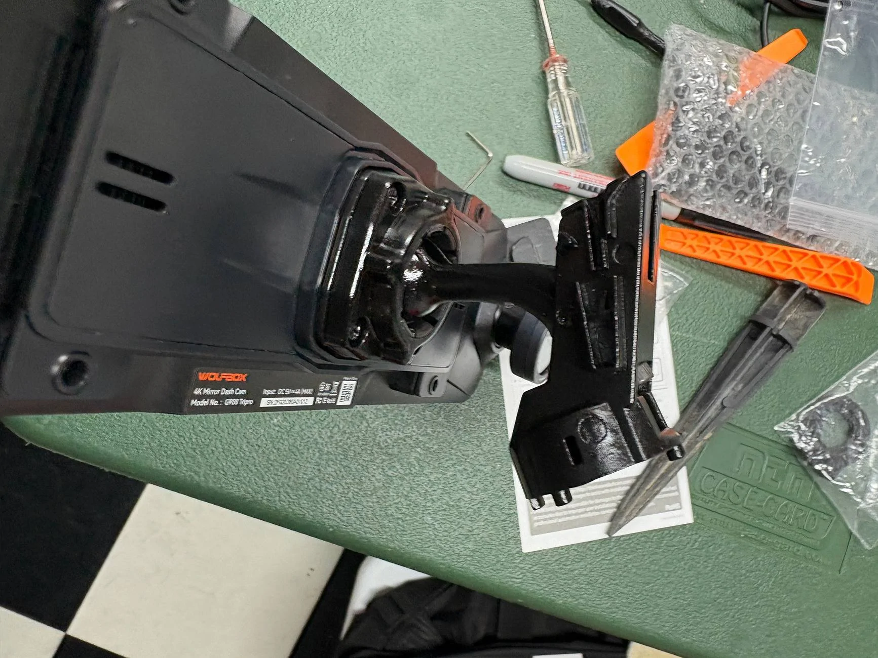

Is it twist to the left to get it off top pic is the WolfBox Mirror with the new bracket I got>It's OFF!!!! now to get it installed
Ford Ranger how to remove trim around rearview mirror windshield mounting point IMG_0520
