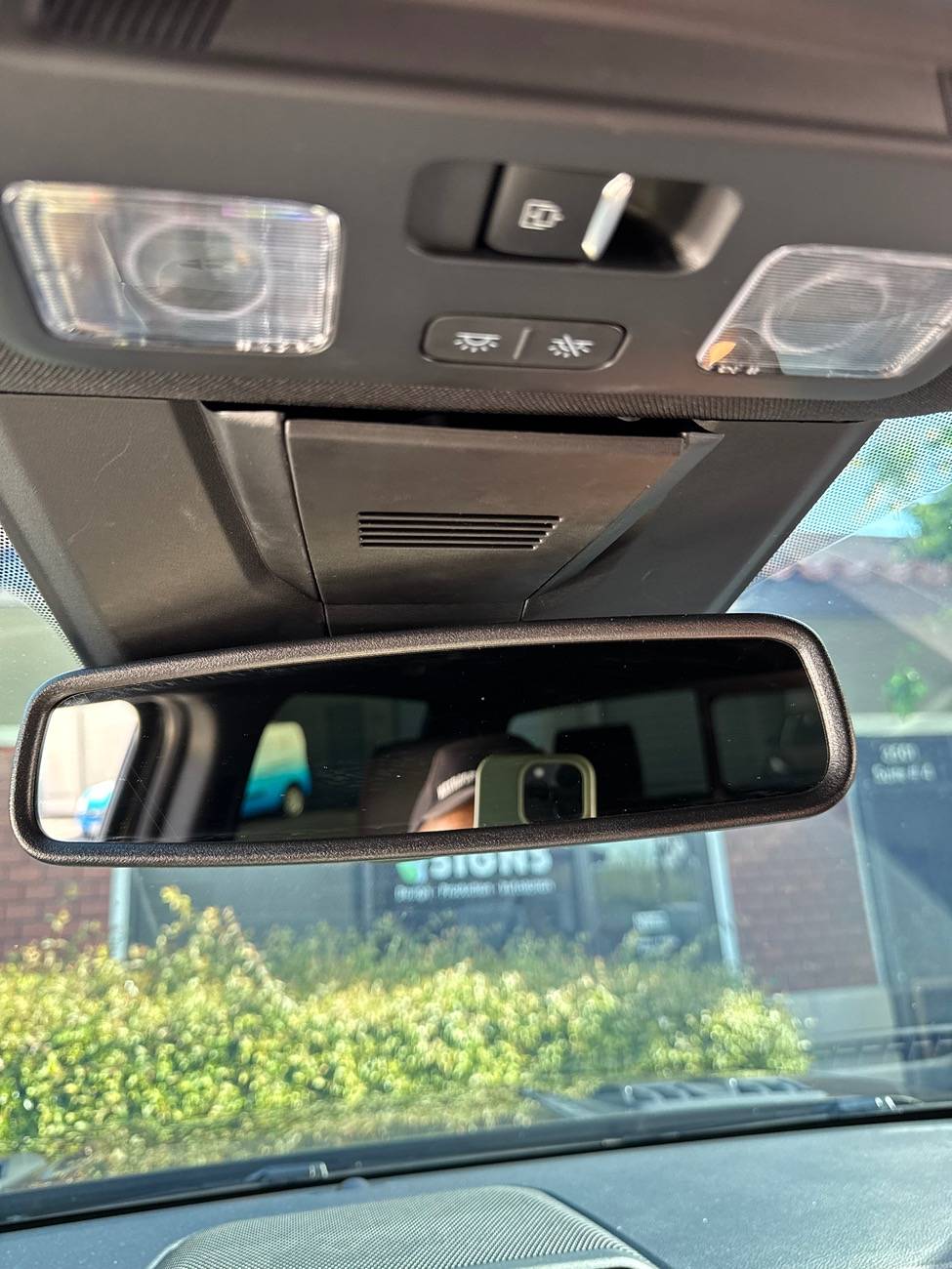

Love my truck. But noticed the black plastic cover above the rear view mirror is loose?
I took it into the dealer today and they said they will fix it no problem. They are also going to pull some fabric on the driver sear to fit better. It is a little sloppy where it tapers in at the top on the back.

Lost in translation lol. How did you fix it? Does it pop off and snap back on? I don't want to attempt to pull off and break it.
I popped mine off to do a mirror tap for my dash cam. When I put it back there’s two spots on the left and right that make contact the plastic part on the truck. I put some really strong double sided tape on those contact points and pushed it back to. It tightened it to the ceiling so there is no more gap it’s flush with the ceiling liner. It also doesn’t move at all.

Just FYI, every Ranger we have gotten in is the exact same, I guess its normal, or how it was designed. ugh.

Common since day one. Some loser than other but all loose on passenger side for some reason. Even the 25s same issue.

I was able to get it replaced shortly right after. But it still looks loose. I get that's just the way it is.
