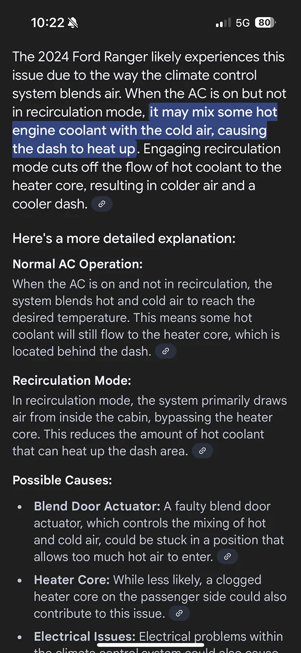

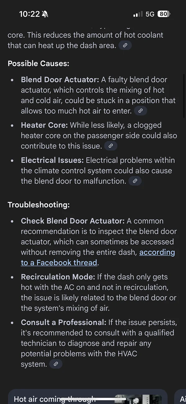

With AC on I have noticed the dash gets very hot between the screen and glovebox area. If I just push the recirculating button it cools back to normal very quickly. Do you think it’s just the heater core getting hot? Still blows ice cold either way if recirculation mode is on the dash doesn’t get hot at all, but if I turn recirculation off, it gets really hot on the left side of the glove box and the front of the dash to the right of the screen on the passenger side Seems like it gets awkwardly hot on the glove box area. Anyone else notice this? If you put your hand in the cubby above the glovebox to the left it feels very hot. AC temp is still ice cold either way.
