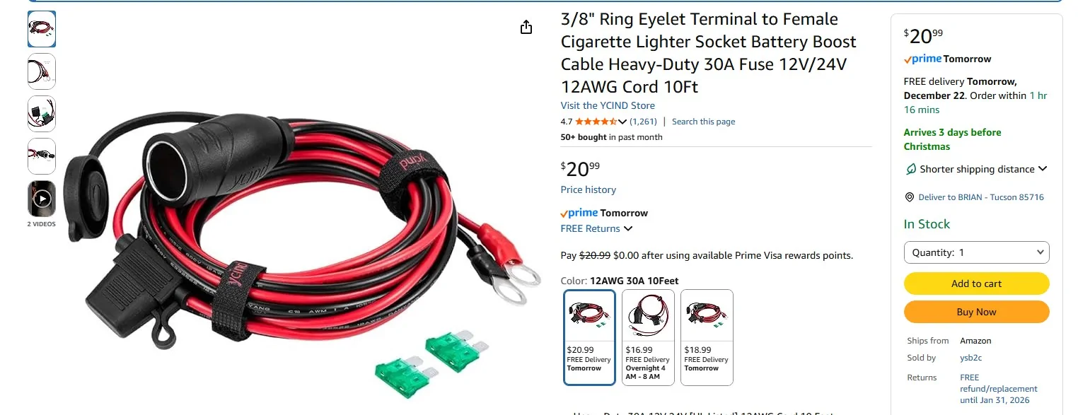

If I needed a live 12V socket in the cab with the engine off I'd probably just buy one of these and poke it thru one of the rubber firewall grommets and wire it to the battery. The socket and cord could be stashed in the charging cubby or in the console. They come in 3,6 and 10 foot lengths.
I have a 6 footer that I used to power a 12 volt cooler for 5 days last year.
Ford Ranger Cigarette Lighter Socket Won't Stay Hot 12V socket
Do you mean 5 consecutive days? What was the outside temperature and were you parked in the shade? Can you please tell us what model cooler or fridge you have? Were you able to restart your truck afterwards without using a jump starter?

Sorry I should have been more specific, this was not on my truck, it was on my motorhome. The fridge was an Alpicool IR42 portable inverter fridge that runs between 40 and 60 watts, the temperature was moderate in the low 70's, in the shade and the battery was a 100ah LiFeP04. The cooler was not opened during the 5 day test. The 5 days were consecutive and there was no charging taking place during the test.

Depending on what the OP has in mind to be running off that socket the second battery option is a good idea if the load will be substantial. If just for charging a phone I wouldn't be too worried.
