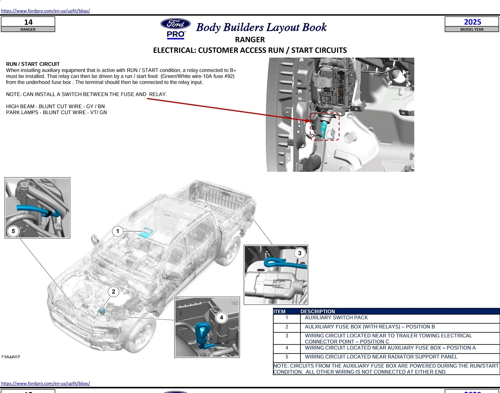

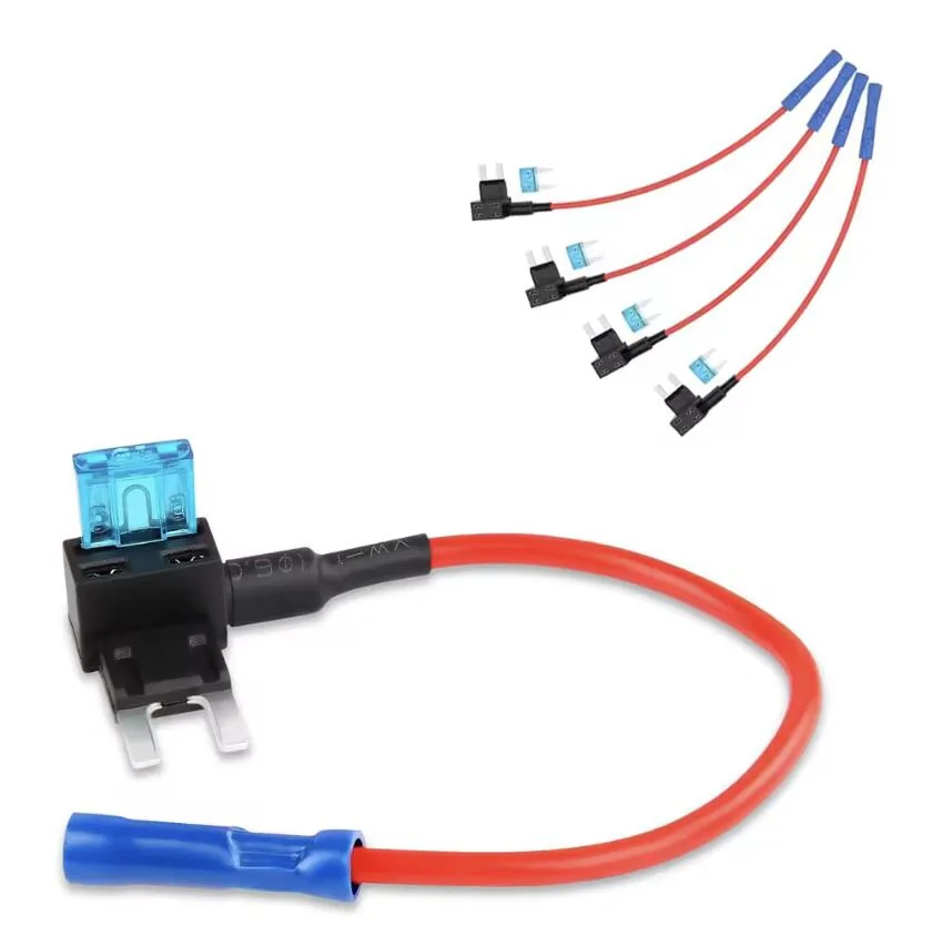

I recently installed some electrical components to my 25 Ranger:
1. LED bar at front bumper: It's connected directly to the battery and I have a switch next to the steering wheel to turn it ON/OFF but I need it to be ON only when the ignition is turned on, so even if I forget my switch ON it looses power when I remove my key from ignition. I know Raptors have the AUX from factory, any ideas on how to do it with non-raptor models?
2. Courtesy lights on the inside: This one I would like to turn on automatcaly only when my headlights are on because during daylight it's barely visible. Any suggestions on how to do this without cutting any wires and losing my warranty?
I guess the easiest way for both cases are these fuse jumpers. Am I right? How to now witch fuse to use? Thanks

I may be misunderstanding, but here's what I think you are looking for....
Ive been researching similar functionality and while there may be another way to do it, the simplest method seems to be using an aux distribution box. The Auxbeam is one of the cheapest / simplest. Basically you use a fusetap (like the one you showed in your post) to trigger the distribution box so that it only turns on with keyed ignition. Note that you would still need to hit a power button to actually turn the light on - it wouldn't automatically turn on, but it would automatically turn off once you pull your key though.
If you wanted it to automatically turn on with keyed ignition you need a more sophisticated distribution box like the Garmin Power Switch (there are many others) where you can program the fuses. I think it offers this auto on feature as well as the ability to link lights, or have multiple (2) triggers depending on what you want to trigger the lights.
I don't yet know exactly which fuses are key powered. Someone told me fuses 21 and 22 work, but I was going to double check when I got around to installing.
