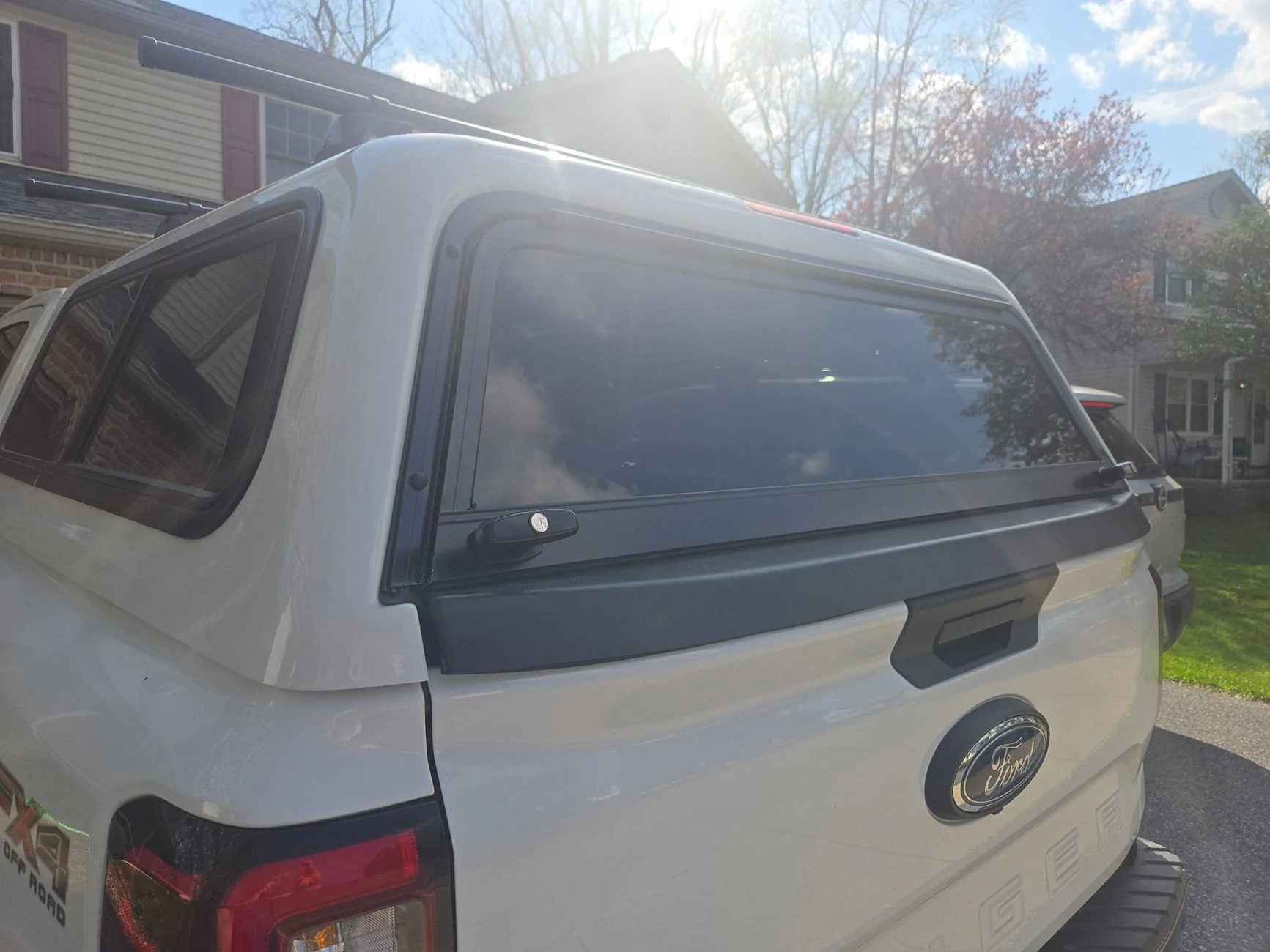

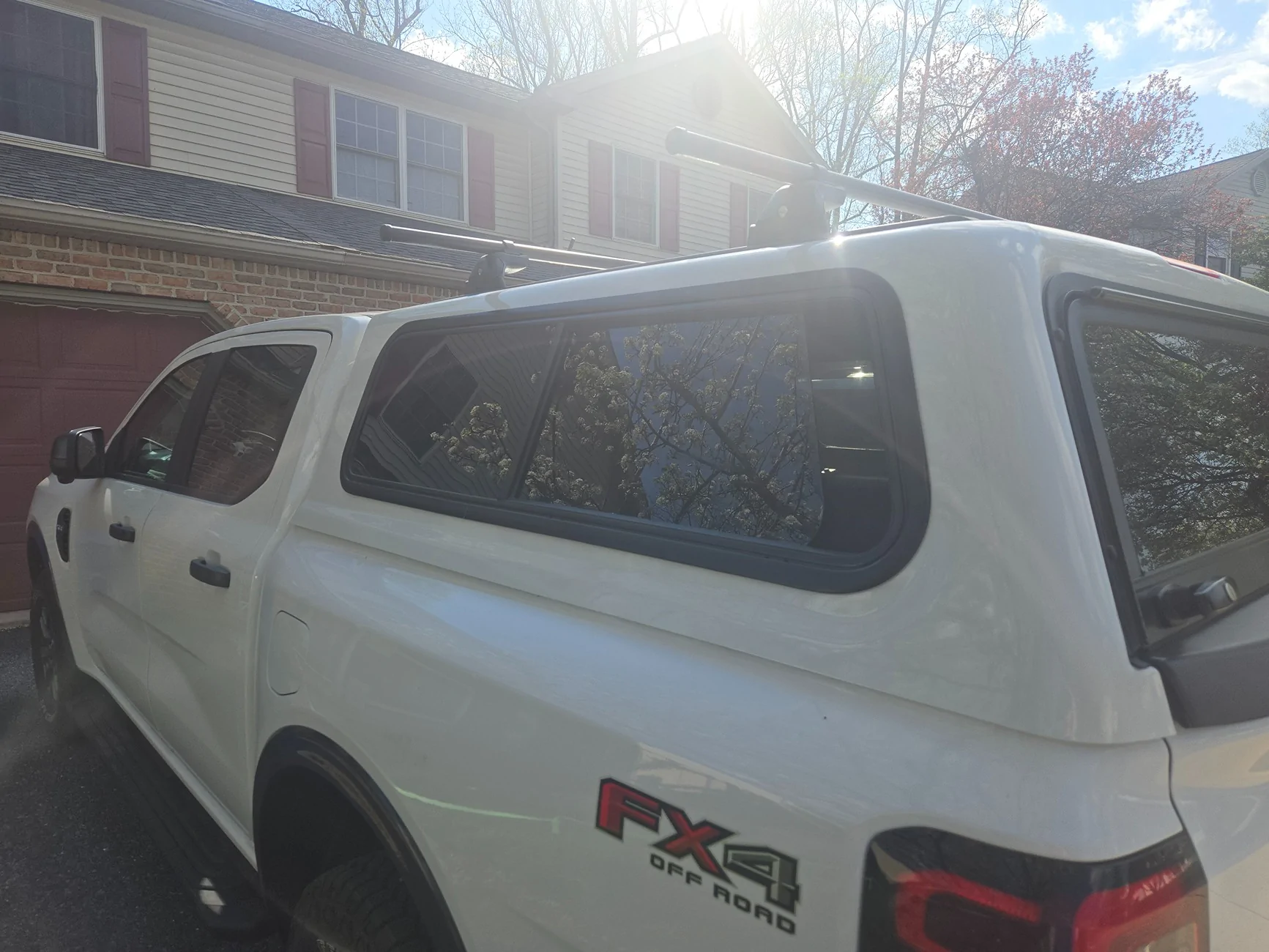

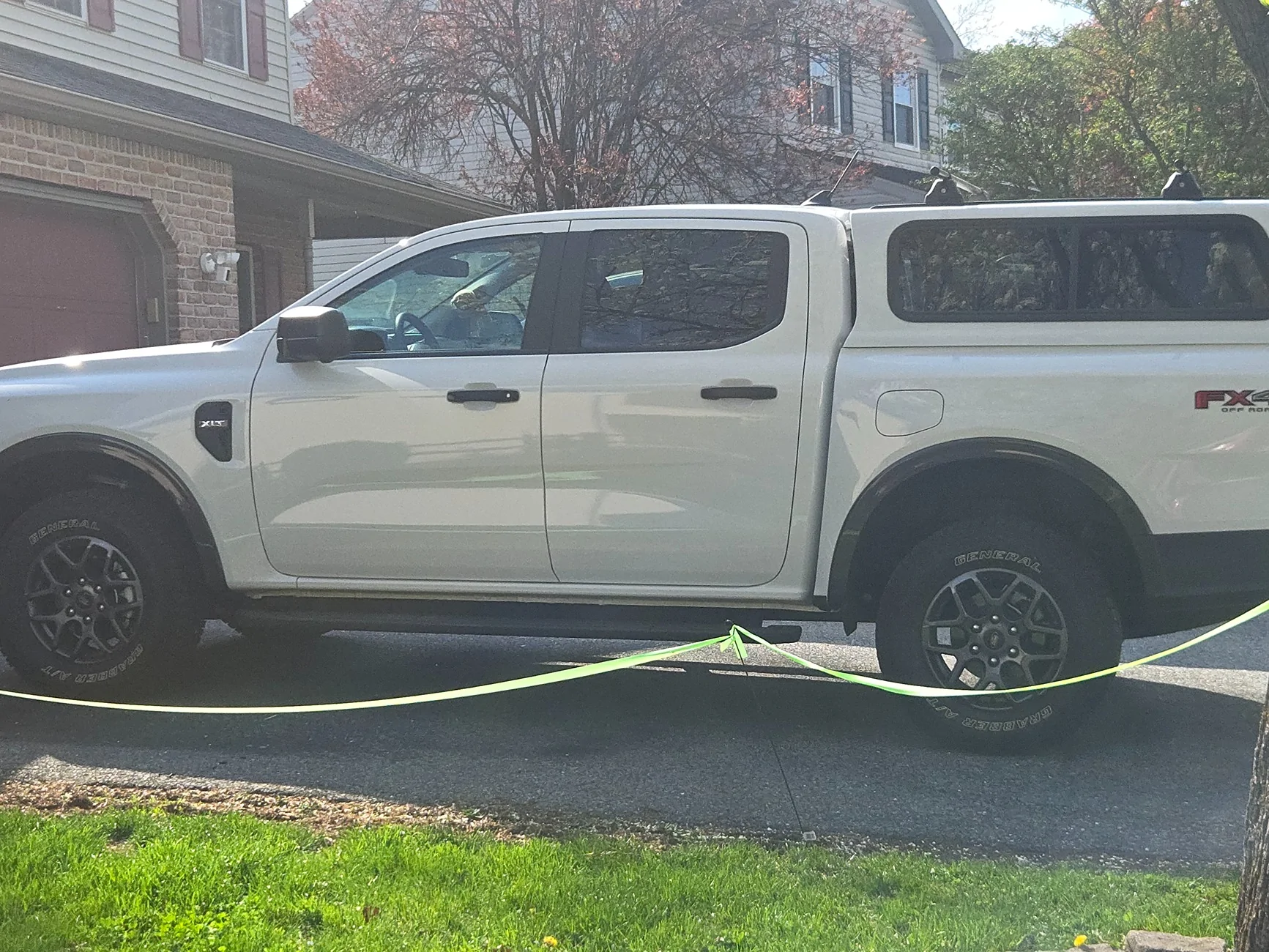

Hey good people. If anybody wants to know what a Leer XL cap looks like on the new Ranger here it is. Fit and finish are great installation went off without a hitch except for one thing. The dealer I bought it from was hooking up the third brake light and it sent the truck in all sorts of issues tapping into the rear brake light. Causing the blind spot monitoring system go off the tail light blinking rapidly. The dealer disconnected the wire nothing was cut or anything. He was an old school dealer and I don't think he's very familiar with these new trucks. Does anybody know which wires to tap into to hook up the brake light on the cap.

Get a tailight out and plug it from there. Remember to put a connector in case you take off the cap.
The same wire feeds either 2.4 as running lights or 12volts when brake is pressed. Maybe your leds will act the same.
Another option if you have the tow package, you could take the wire underneath the bed.
