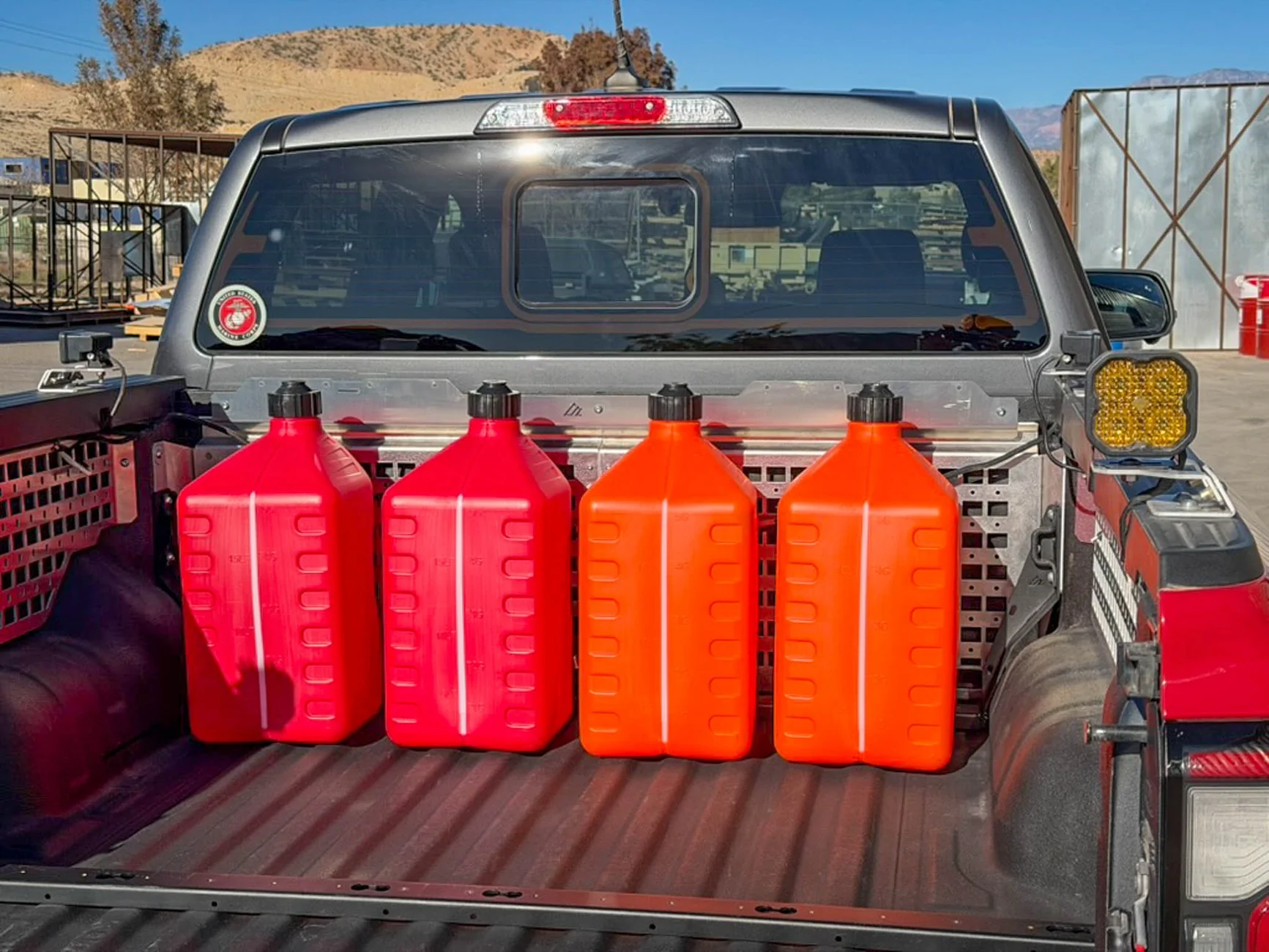

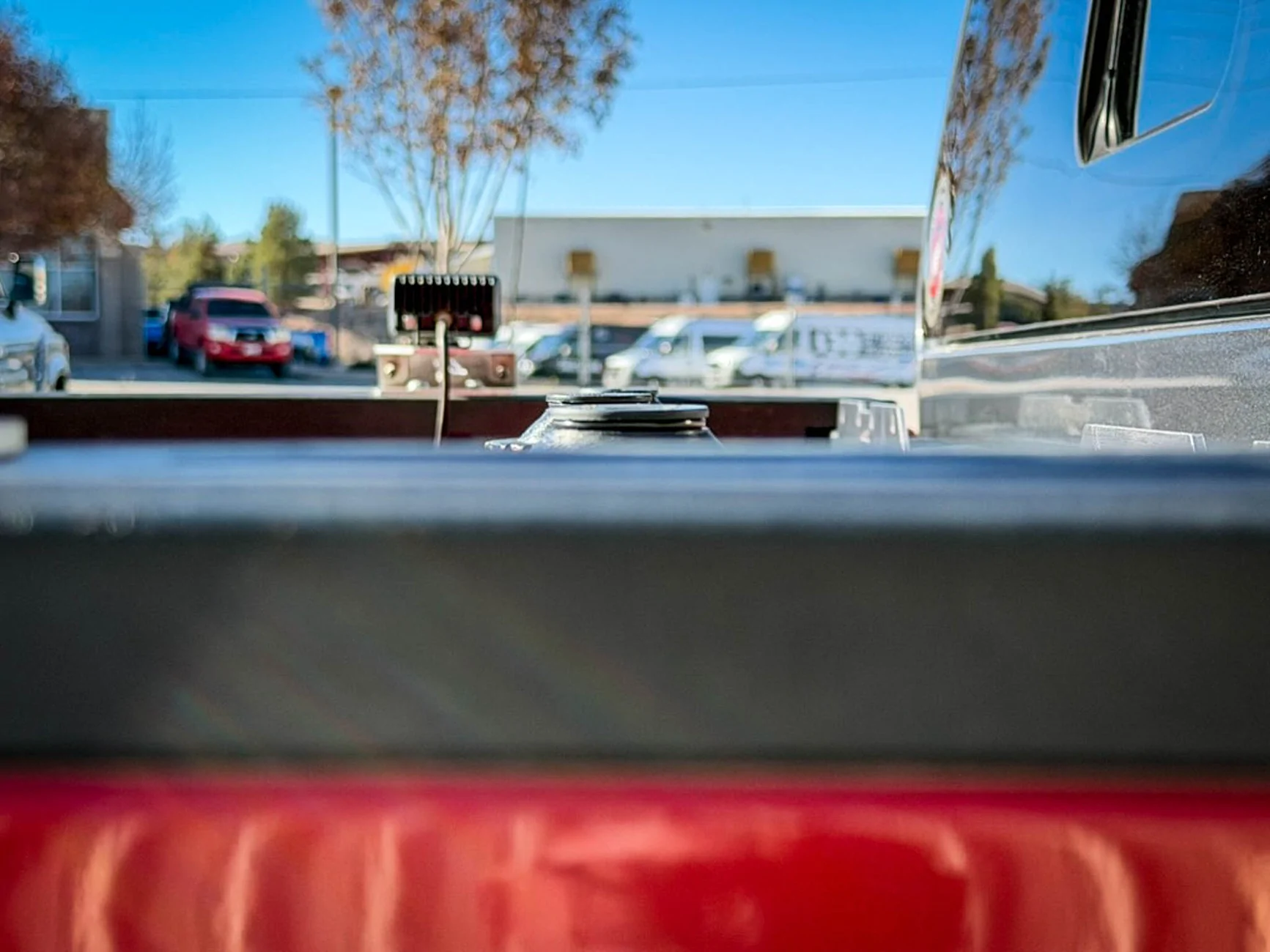

I'd like to see y'all make a bracket system, or whatever you call it to accommodate 4 jugs side by side for the rear of the bed. That would make a total of 20 extra gallons, effectively doubling the range of the RR before a gas station could be located.
Looks like they are right at the edge of the bed rails. So, keeping 5 gallon cans below a tonneau cover is going to be tough unless we used something more like a traditional "lawn mower" can. Although, if your tonneau cover allows, four of these fit perfectly against the bulkhead. I'll ensure our mounts take this tight mounting placement into account.

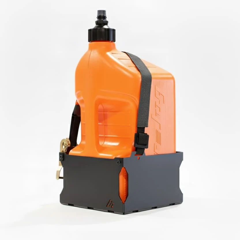

As much as I love our Ranger Raptor, the fuel mileage isn’t exactly its strongest feature. On longer trips, especially when we’re far from gas stations, it’s always a relief to have extra fuel on board. If you’ve watched the Trail Hero Expeditions TV show, you’ve probably seen us scrambling more than once to stretch a tank. The Rotopax cans we’ve carried in the past have saved us every time, although they trade capacity for packability. They’re great for what they are, but we’ve been wanting a better option for carrying more fuel without giving up space or usability.
A while back we had a thread discussing everyone’s preferred style of fuel container. There wasn’t a clear winner, mostly because the use cases vary so much. Still, we needed a starting point. After digging through a bunch of options, we noticed a lot of interest online around the new American-made Tuff Jug products. We brought a couple in for testing and decided they would be the first jug we support.
You can check out Tuff Jug’s site if you want to learn more about their quick-fill system - https://tuffjug.com/.
With a jug in hand, we went to work designing a lightweight but solid mount for it. That product turned out well. You can see it here - https://americanadventurelab.com/news/tuff-jug-mount/. The mount will also fit most jugs with a 10 inch or smaller footprint. The ratchet strap was intentional since it makes the system more universal.
Now we’re shifting focus to the Ranger platform and how to integrate this mount cleanly and safely into the bed.
Before I outline some early ideas, I’d really like to hear what matters most to you when it comes to carrying extra fuel. Community feedback has played a huge role in shaping several of our major Ranger products. Our Bed MOLLE Panels, Rear Seat Delete, and Bed Rack all benefited from early input from this forum, and that collaboration made those products far better than they would have been in a vacuum. I’m hoping to repeat that same process here.
Here are some of the priorities we’ve been thinking through:
  • Easy removal of the jug from outside the bed
  • Simple and repeatable process to drop the jug back in and secure it
  • Zero movement once mounted
  • Quick removal of the mount itself when you don’t need it
  • Works with or without bed MOLLE panels
What else should we be considering?
What would make a fuel solution genuinely useful for the way you use your truck?
Looking forward to hearing your thoughts.

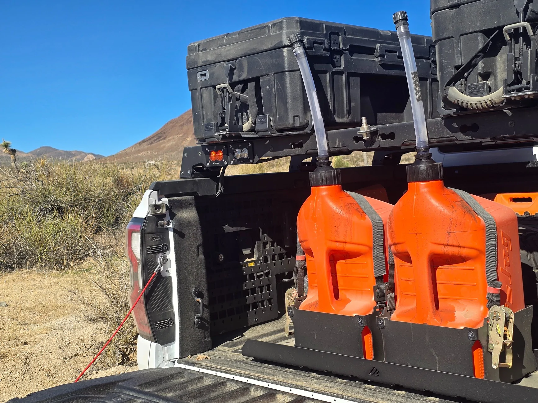

Just used this set-up on Sunday in Joshua Tree on EXO adventure since the Broncos had much better range.
Apologies I don't have a picture of me pouring 5 gallons in but trust me - it is FAST!.
The jugs stay put in the AAL mount, they unlatch in seconds and, while the pour rate is constrained by needing to use the small diameter TUFFJUG adapter for Ford vehicle gas tanks, it is still ~2x faster than Rotopax and infinitely easier.
Plus, filling them up at a gas station is stupid simple rather than a chore.
I had tiny leakage and that was simply operator error failing to screw everything tight. I promise it won't happen again! :):):)
Apologies I don't have a picture of me pouring 5 gallons in but trust me - it is FAST!. The pour rate is constrained by needing to use the small diameter TUFFJUG adapter for Ford vehicle gas tanks but it is still ~2x faster than Rotopax and infinitely easier. Plus, filling up is stupid simple rather than a chore.
Glad to hear it's working for you! Hope the trip went well.

Looks like they would fit under a diamond back cover.

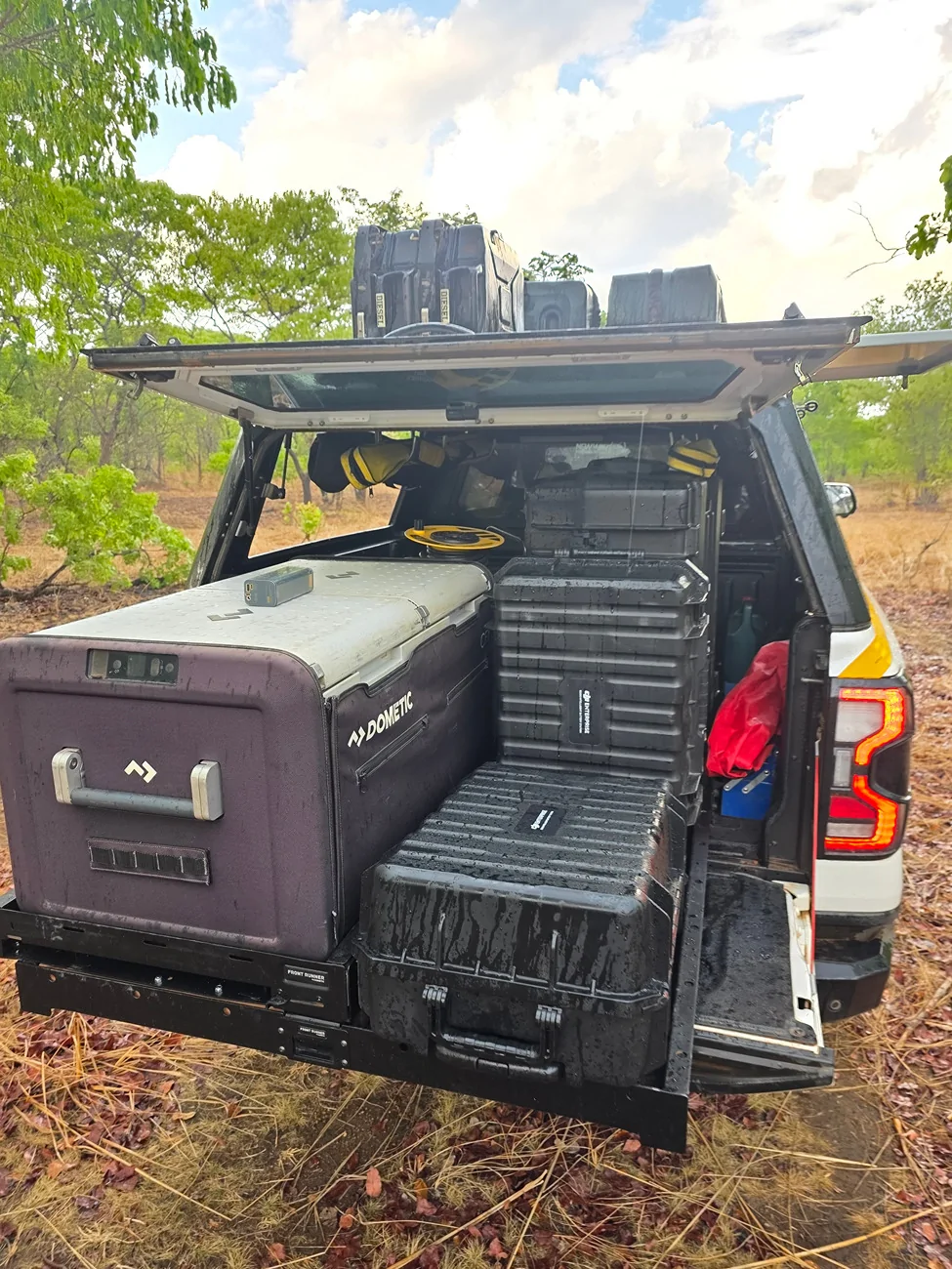

WOW.... Nice setup. Zambia eh?
Interesting. I bet you could tell some stories.
I can tell as many stories as I've punctured tyres. Too many to count 😁
Very happy with my Wildtrak. Couple of problems here and there but I'm confident she'll get to 200k without anything more issues than I've experienced. Most major issue I've experience has been the fuel system but I think I have it figured out now. Will relocate one module so it can't happen again in the future.
Apart from that.. some of the places I've taken this thing required new roads to be cut. I have breathtaking pictures of it all over my country.
Ford better sponsor me and my company or I'm jumping to the BYD Shark for my next car 😂.. and I've really shown what the Ranger can do.
