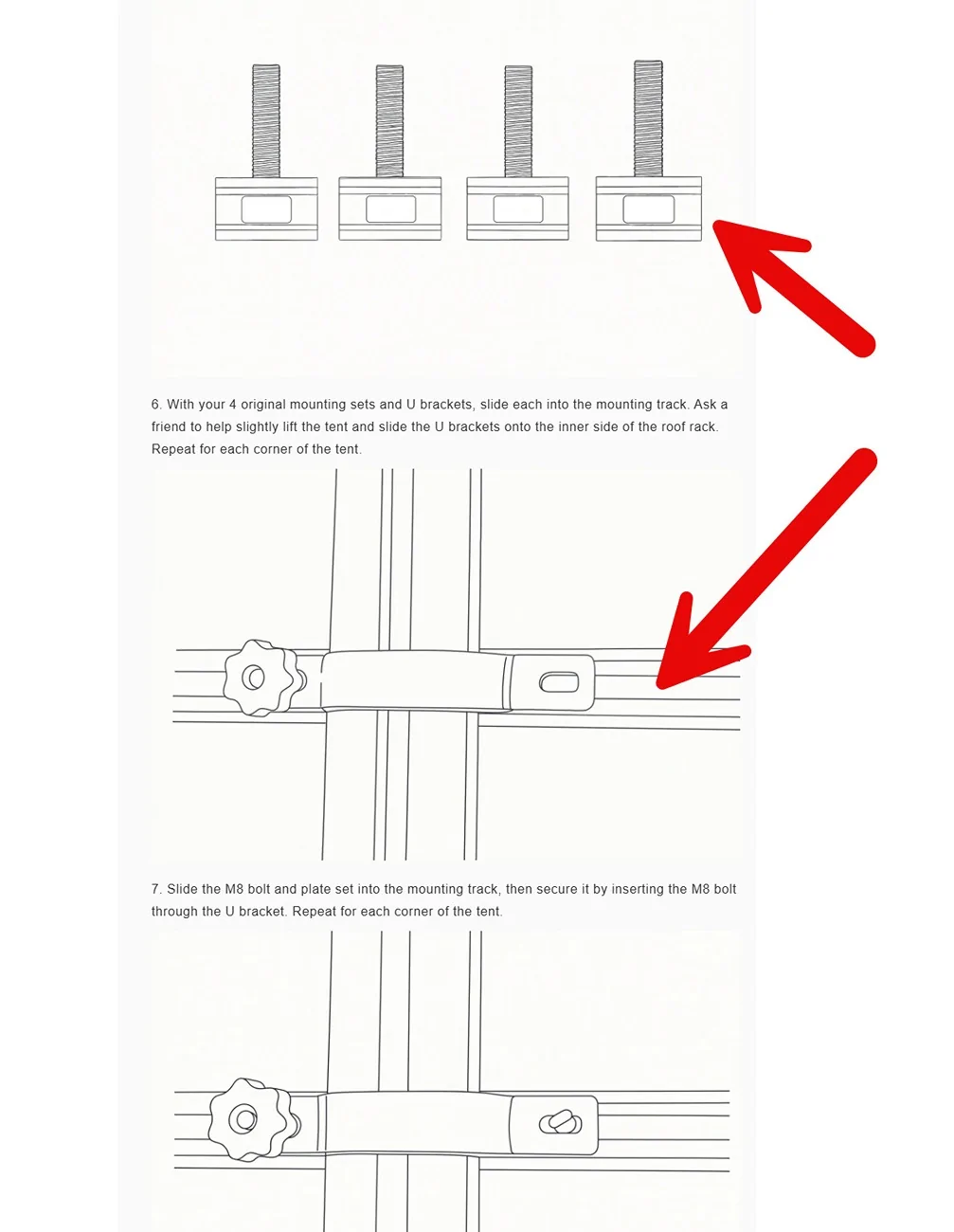

We make it much easier than that. You wouldn't use those clamps at all. The track on the bottom of the tent will attach directly to the RAILs. You may want to put some abrasion resistant material between them (may be provided with the tent). The track on the tent will hopefully line up with the slots in the top of the rails. We can't know all of the tent patterns, so I tried to make the slot pattern as universal as possible. Just put your normal t-slot bolts into the track and attach it to the RAILs.
By removing those clamps, you eliminate another failure point and restrict movement of the tent, providing a much more solid mounting system.
From the tent instructions:

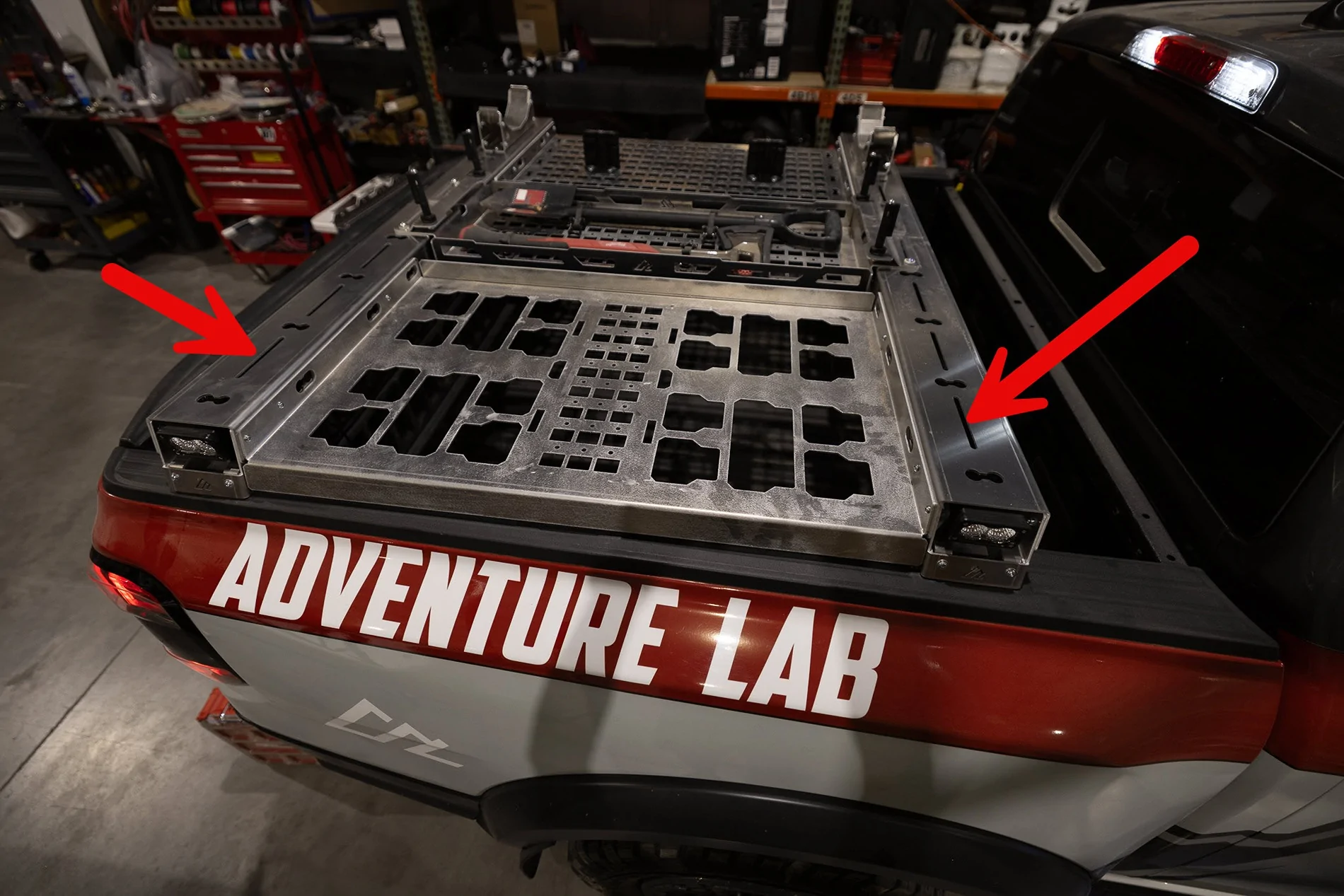

Ford Ranger Let's talk Bed Racks for Tonneau Covers 2025-12-03_08-27-14
View of the bed RAILs.
