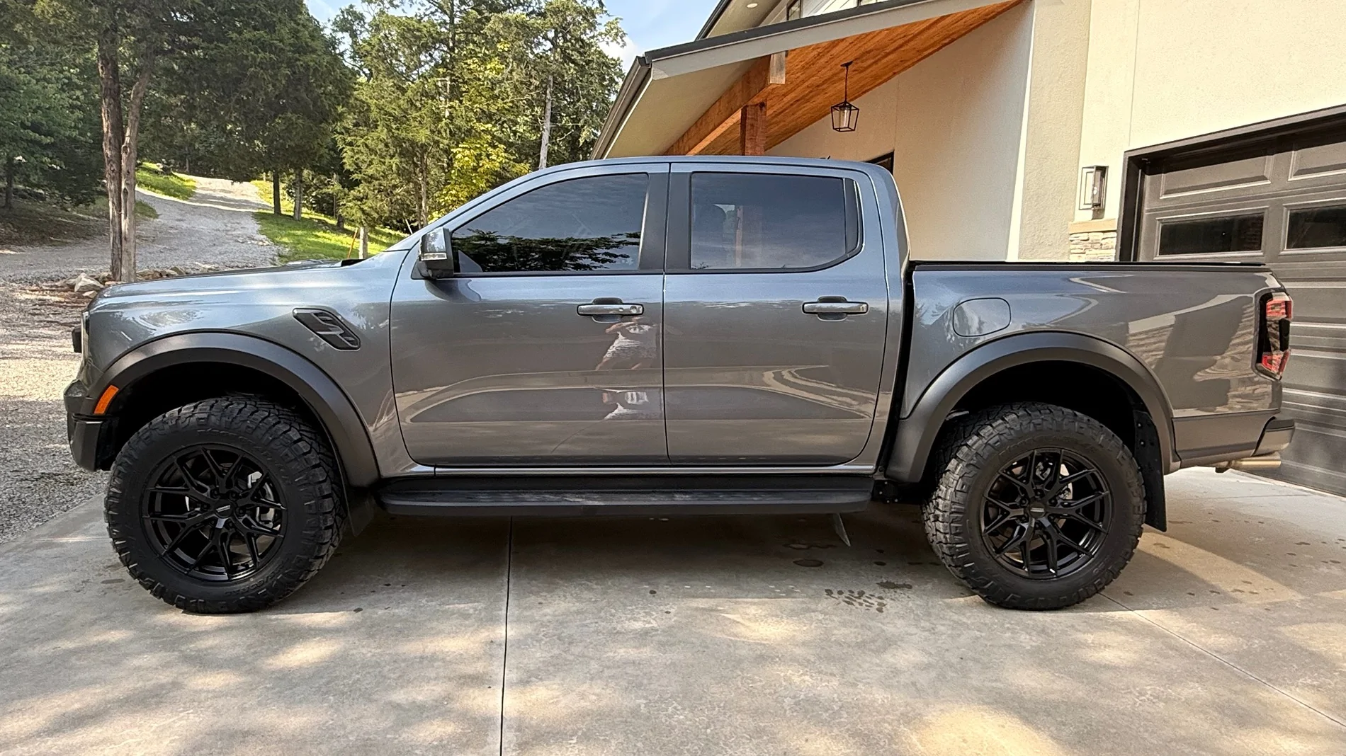

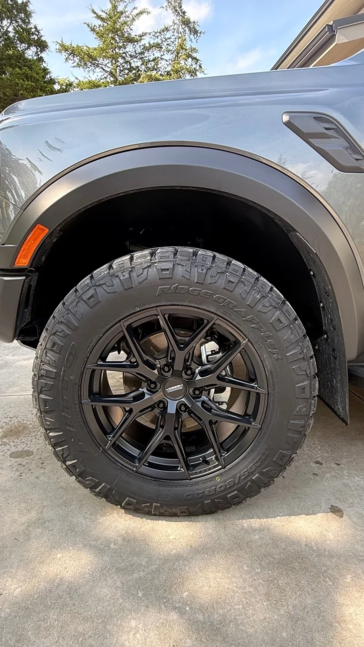

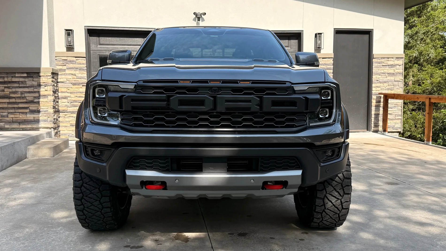

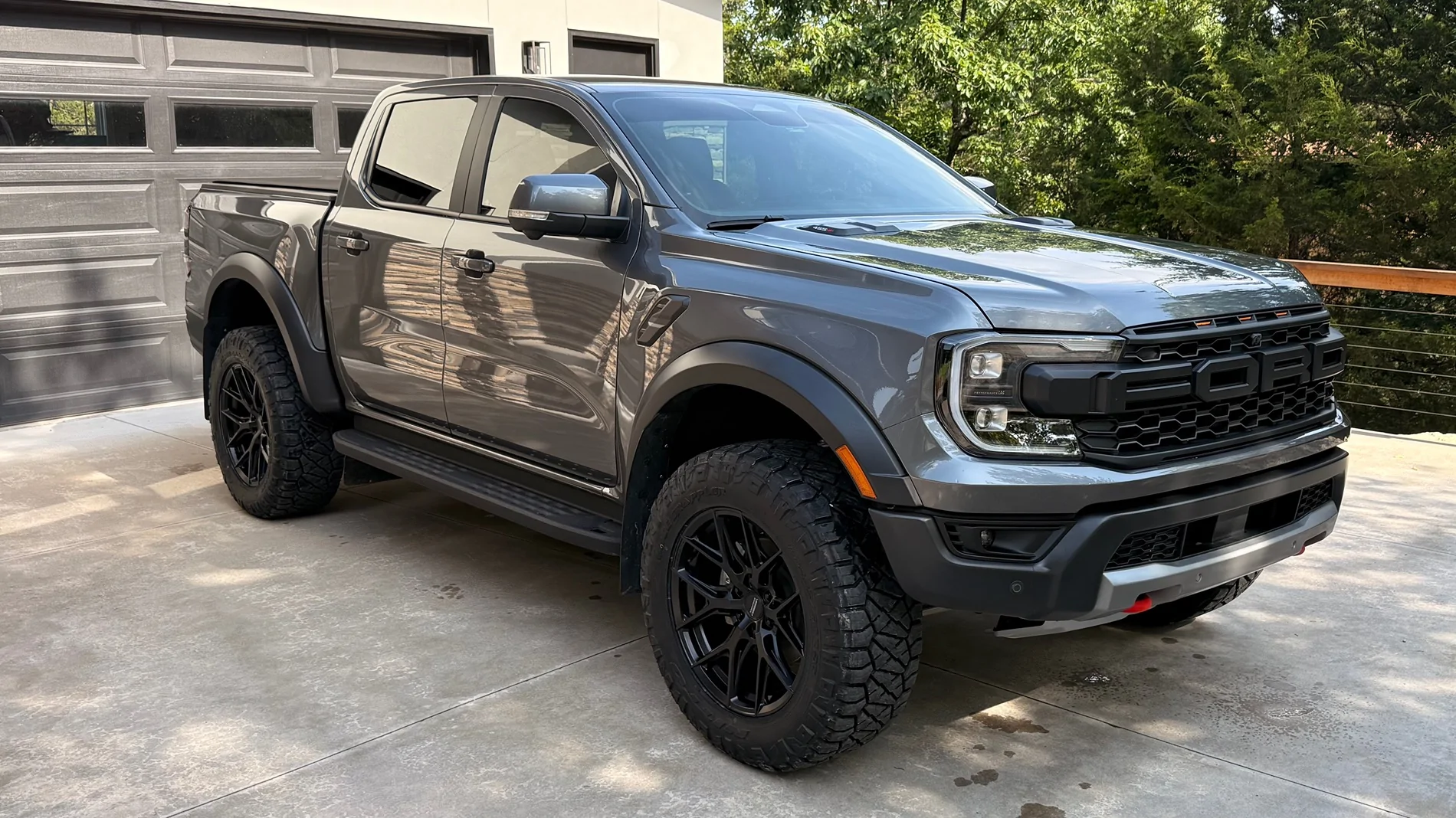

After way too many hours researching, I finally pulled the trigger on a new lift/wheel/tire update.
Opted for the 2”/1” GOAT off-road strut spacer lift, Vossen HF6-4 satin black 20x9.5 +30 offset wheels, wrapped in 295/60R20 Nitto Ridge Grapplers.
After an alignment and the ForScan ride height calibration, it’s about ready. Need to do just a little trimming on my Rokblokz mud flaps, but so far no other rubbing on the crash bars.
This gives me exactly 1” rake, 40” from the ground to the lip of the fender guard up front and 41” in the back. Tires equate to a 34” and the offset brings them right to the edge.

They look good.

Those Vossen wheels are awesome looking. Great look on the truck!

Perfect proportions. That is exactly what I want to do. Well done! And I hear you about the research that goes into a lift/wheels/tires decision.

Looks great! What did you buy for lug nuts?

I like them, that looks like a good "mostly street setup" but something you can still do smoother dirt trails / gravel roads etc. with. The only downside to lower profile tires is heavy off-roading and jumping, you loose a lot of sidewall cushion that can save suspension parts, not to mention your back! I like the spoke pattern, reminds me of the RTR Tech 7's I had on my 2016 GT.
That's kinda like a hybrid Lobo concept, except not lowered, so you still have a lot of clearance for snow, sharp inclines etc. I'll bet those would look amazing in dark bronze too!
