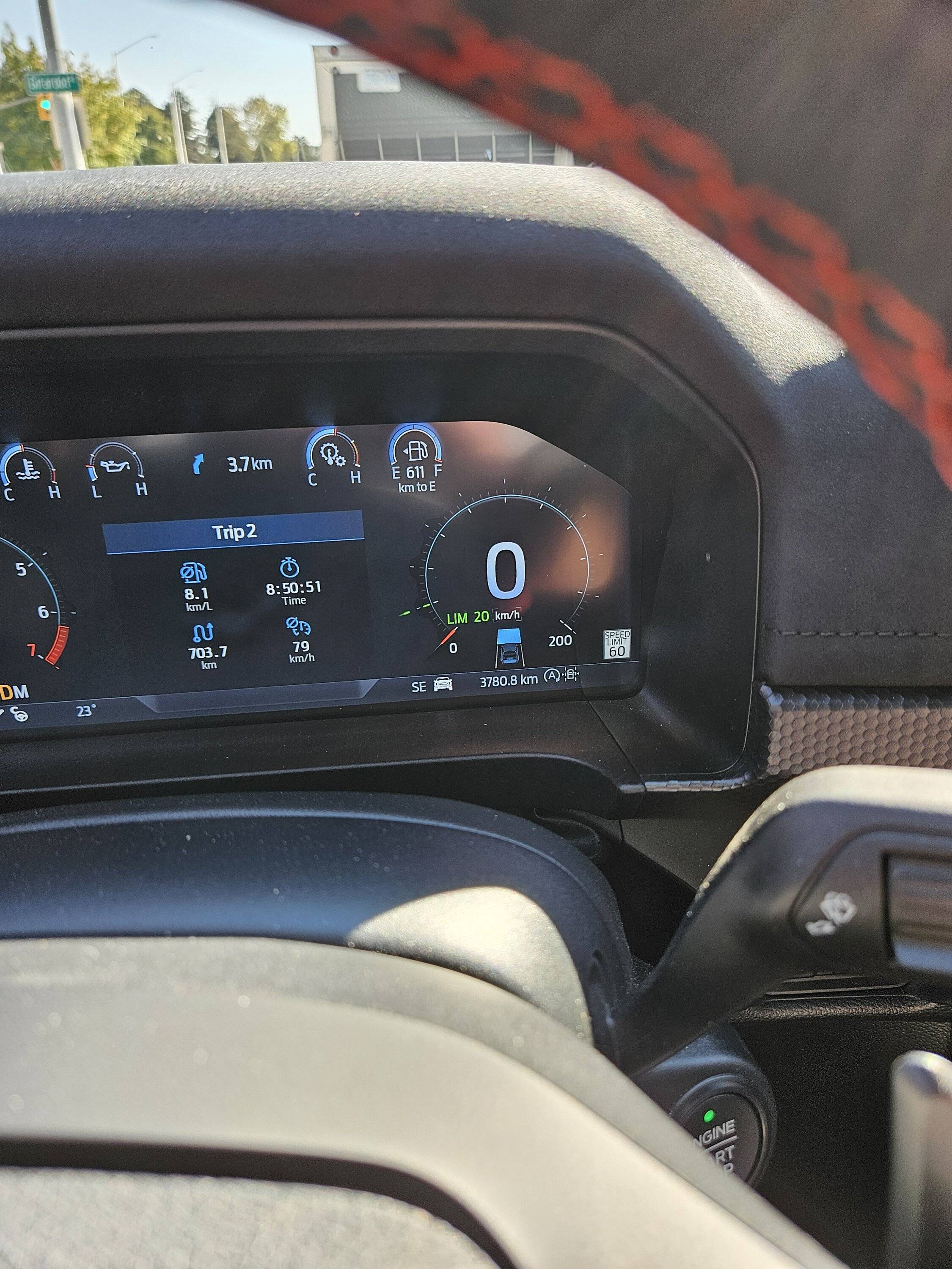

After a stop, when trying to accelerate i lost power after 20-30 feet. Didn't stall, but no response from gas pedal. Several pumps and went again, only to repeat another 3-4 times. Took a pic when it was happening. Checked out the settings and was same as i had set everything and no possible OTA update had changed something. This happen to somebody else?

Looks like you pressed the limit button on the left side of the steering wheel, which means the truck won't go over 20. Press it again and it should turn off and to back to normal.

you just pressed the LIM button on the steering wheel...it sets the limit speed at the speed you are when pressing it...then you can change with +/-. re-click, it goes away

Silly me....Thanks Guys. I'll check that out.
