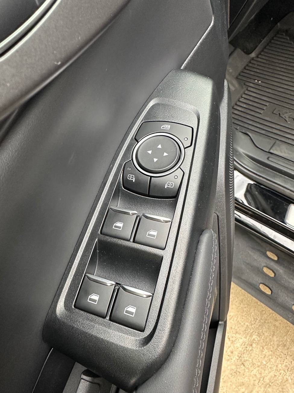

Yeah - I don’t have that button!!
wha??? Mine's an Aus spec Raptor and has this button, but the other poster has the button in an US spec XLT - if an XLT has it then so should a Raptor. I wonder if any other US spec Raptor owners can advise if they too have this button or not??

Wow that is different. I have a Canadian spec Raptor delivered in May and manufactured in Jan/Feb, it has the same window switches as the Aus spec above. I wonder if Ford have supply chain issues, maybe the wiring is installed and you can get a replacement switch unit installed by the dealer.

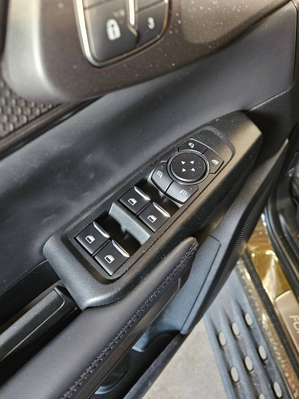

Ok so the mystery continues - I looked at some other 2024 RRs being advertised on cars.com, and it looks like they DO have that button!? What the heck?

Supposed to be standard on all RR. I'd look into it with the dealer. Maybe try @Ford Motor Company.

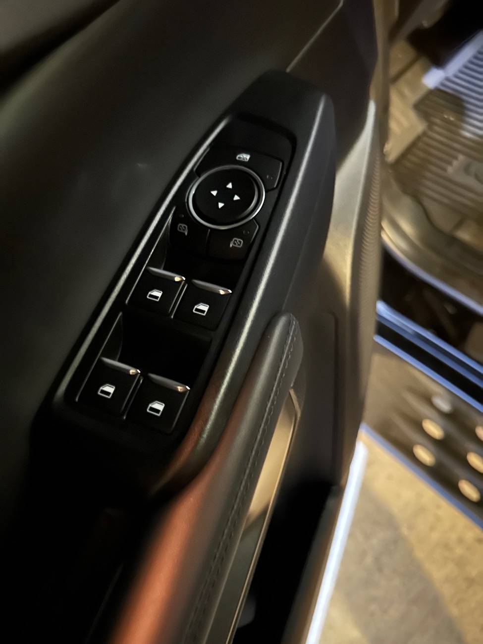

Thanks - I’ll do that - here’s a better pic in the daytime.
Ford Ranger UPDATED:  FIXED. Manufacturing Issue or Stupid question - how to manually fold mirrors? IMG_3082
could someone else with a 2024 USA based RR post a picture of theirs?
