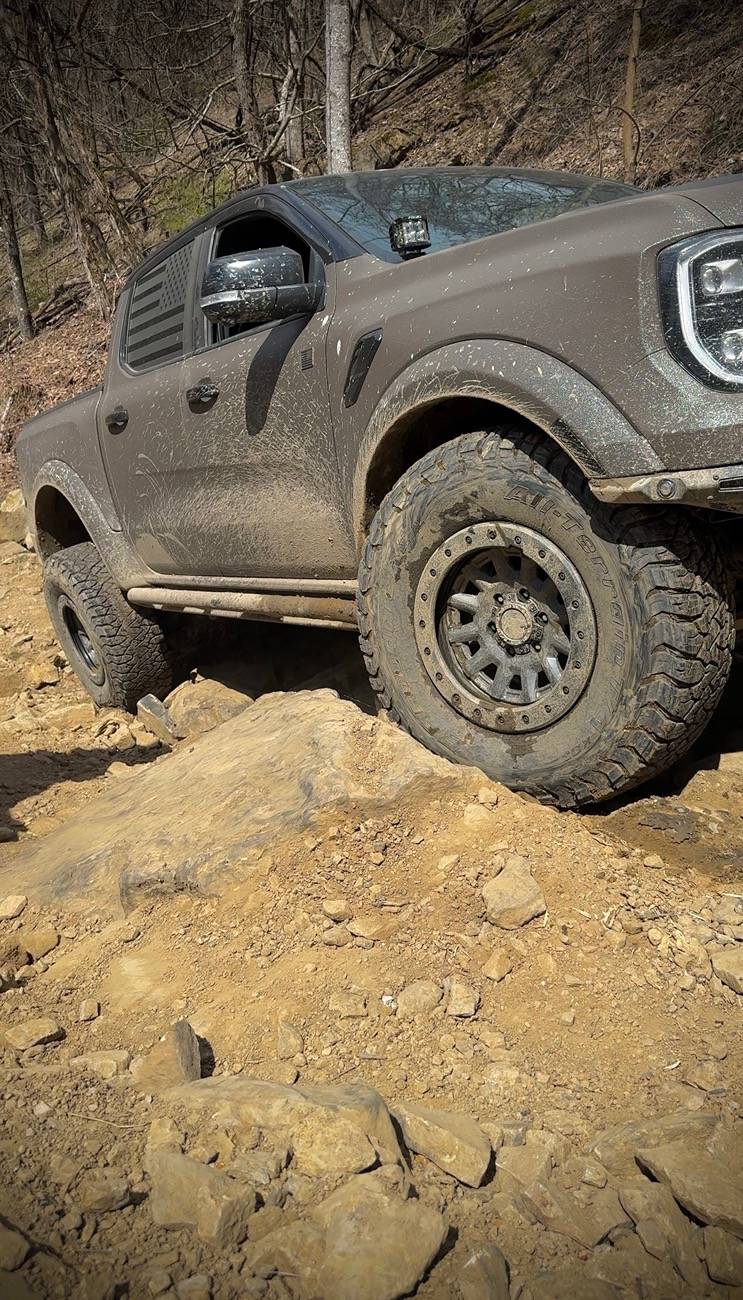

Does that 34 rub at all? I'm trying to find a bigger size tire for my oem beadlock capable without rubbing or trimming but willing to remove crash bars.
OODA Dev
Joe
May 31, 2024
California
2024 Ranger Raptor, 2017 Tacoma TRD 4x4
Going from the +55 offset of the factory wheels to 0 offset (wanted a slightly more aggressive stance) had to do some minimal trimming of the plastic near the bottom of the wheel well and removed the crash bar plate. I could have avoided this possibly had I either done a lift (which I didn’t) or had I done 34” wheels by going taller wall height, but I went 34” wheels by way of wider tires (305/70R17) vs 285 (factory) or 295.

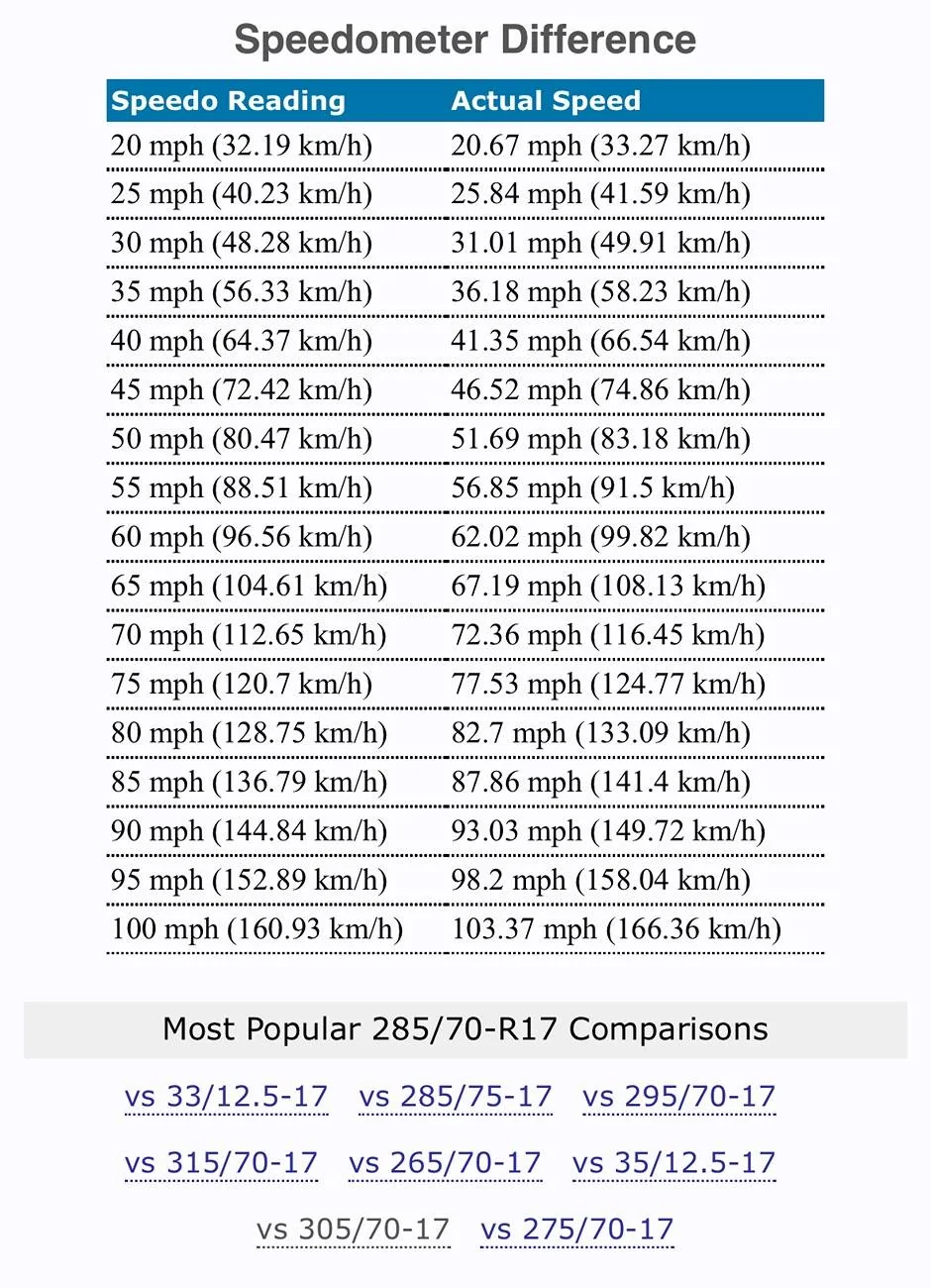

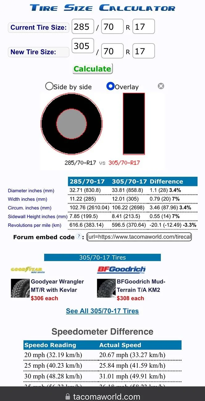

what is the exact size of the KO3? are they the 315/70/17's?
Mine are 305/70R17. Here’s a photo of a tire size calculator showing the comparison. I know some people will bump up to 34” tires via a 295/75R17, but I found the 305/70 keeps the speedometer closer to the factory 33” size (285/70R17), and also has less negative effect on gas mpg.

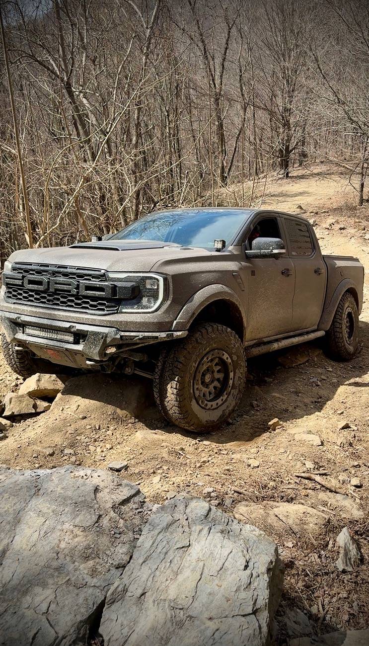

That is one good looking truck ! Love the skid plate and what you did with the back windows.
May I ask where you got those please !?
Ciao !
OODA Dev
Joe
May 31, 2024
California
Ciao !
Thanks man! Skid plate is part of from bumper (Addictive Desert Designs phantom bumper. The skid bars are Phat Bars AU angled rock sliders). The window flag decals I found on amazon (https://a.co/d/24wO7Ug)
