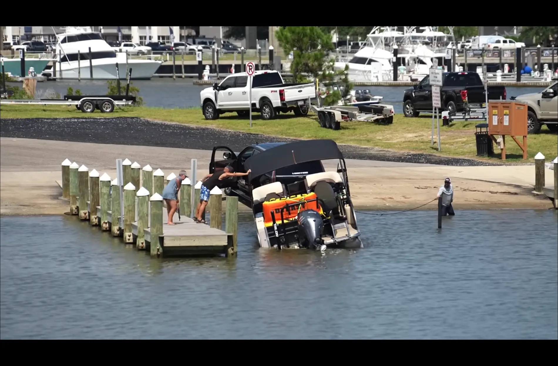

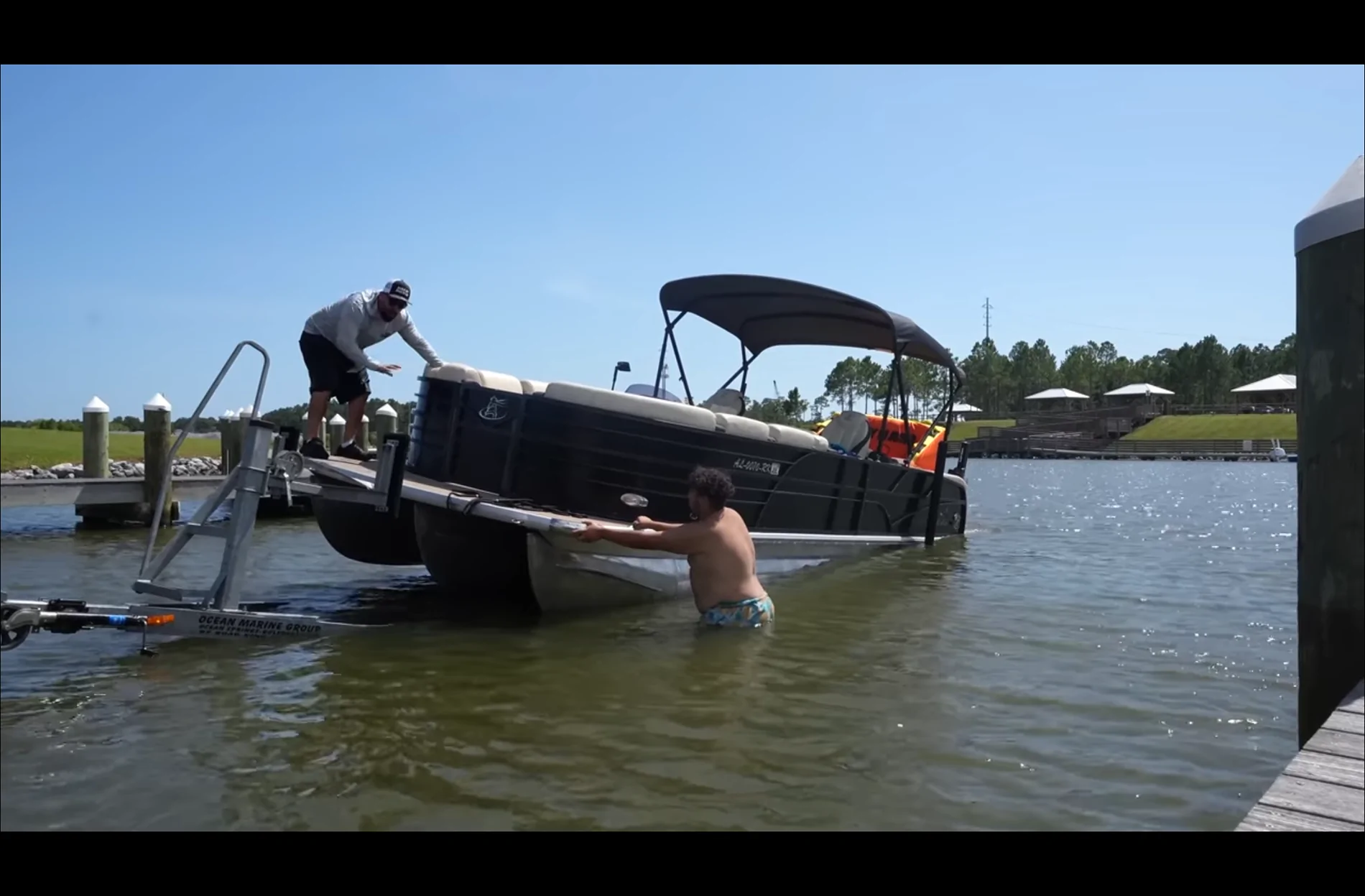

I can’t help with your questions, but I have to ask, do you plan to use boat ramps? If so, you definitely need a bigger truck for those times the ramps are slick. 4wd is a must, but you also need a lot of weight on the rear axle. Have you actually weighed the boat and trailer with full tanks and your stuff on board?
You also need to consider if you have enough reserve capacity, for example, if a pontoon springs a weld and you have to get the boat out when it weighs an extra 2000 pounds. ;(
I recommend that you avoid highways and stay slow with that long a rig, you are a prime candidate for the tail wagging the dog…
