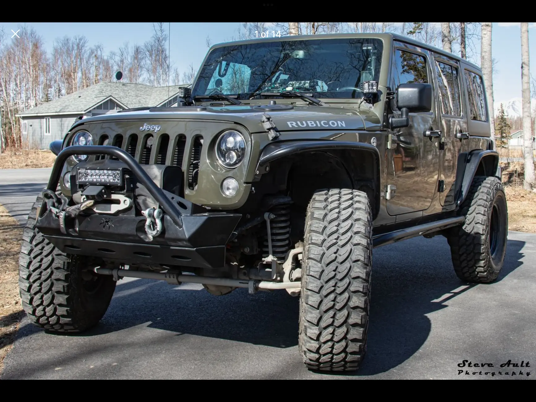

I’d consider using a wireless trailer 3-camera setup. Easy install and complete side and rear view.
I’ve even used wireless cameras to connect with my iPad or iPhone on my Jeep as forward and undercarriage points of view. You can see one between the light bar and the winch.

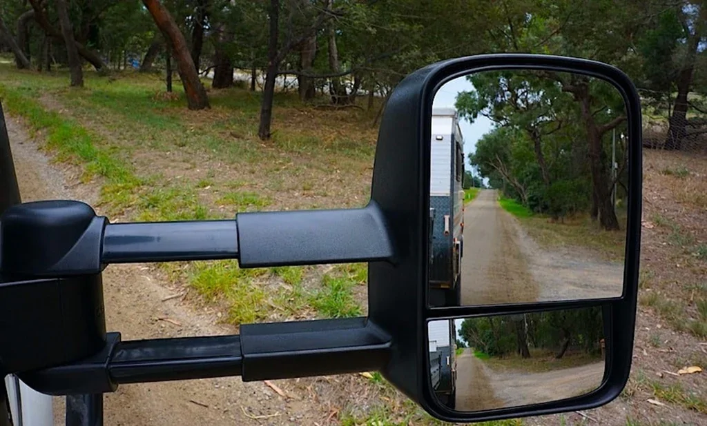

Mirror setup - Sit down in the truck, adjust your mirrors WITHOUT leaning foward etc. You should be able to look into your mirrors without having to struggle to see. Your best setup is going to be having the trailer on the inner edge of the mirror, and the rest of the mirror view being the adjacent lanes. So in your mirror you're going to want roughly 10% trailer/90% next lane over. Next adjust the mirror so that you can see the bottom of the trailer tires, maybe a hair under them. At this point, depending on the width of the trailer, you might not even be able to see the truck anymore. This is fine because if something is going to hit, its the trailer. See pic below

These mirrors work great. Very stable and adjustable and works with your mirror sensors and puck lights.
https://a.co/d/0bDcqhuh
