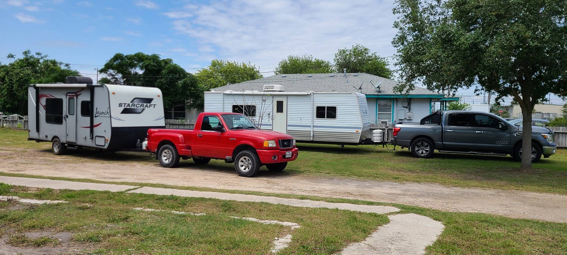

I am the same. I have had half tons then go down to mid size and back to half tons.
I hope this 2024 ranger will be one that stops that since i also still have my 04.
The 04 would have probably needed mirrors pulling our travel trailer but we had the titan.
Ford Ranger Exterior Mirror Extensions for Towing ? 20230409_124326
The small trailer is 19 feet snd the larger ine in the back is 24, and it weighs so much more since its an older model.
