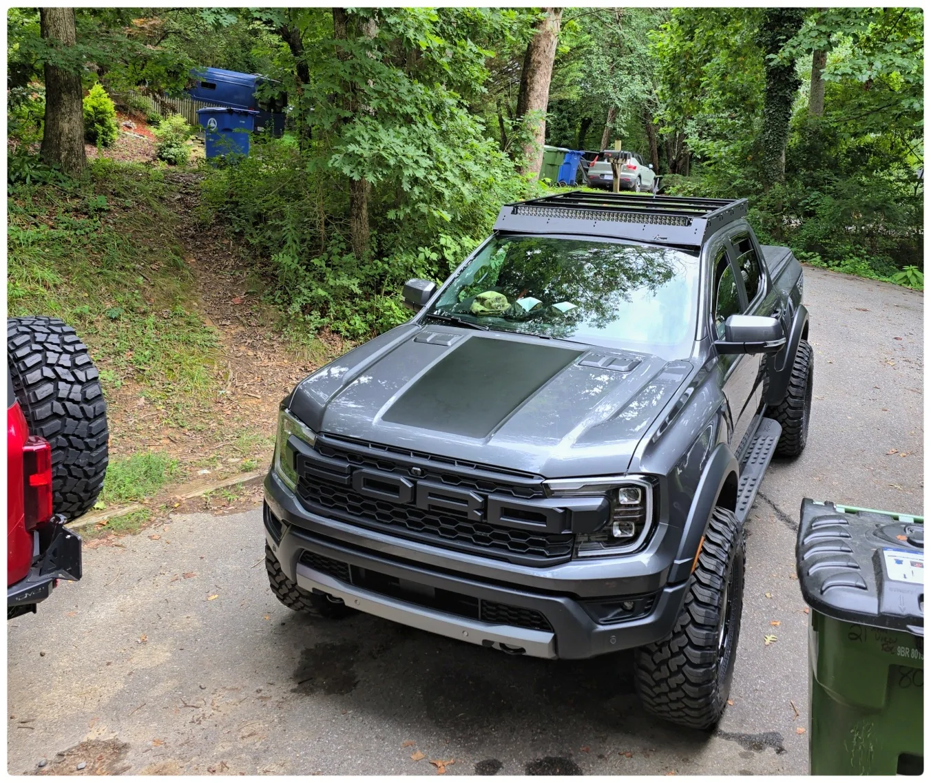

pmontague1968
Peter
Jun 24, 2025
Asheville
It will rub but easy to trim. I put on a 2.5" leveling kit and did a little simple trimming. All good now.
I am running same size wheels with same offset. I removed crash bars as well fyi....
pmontague1968
Peter
Jun 24, 2025
Asheville
The rubbing will happen in rear part of the wheel well. I just used a grinder with a cutoff to trim some of the plastic and sheet metal. Took about 2 minutes per side... Seriously easy. The crash bars are a little more of a pain but not much. I cut the rear bars and painted
