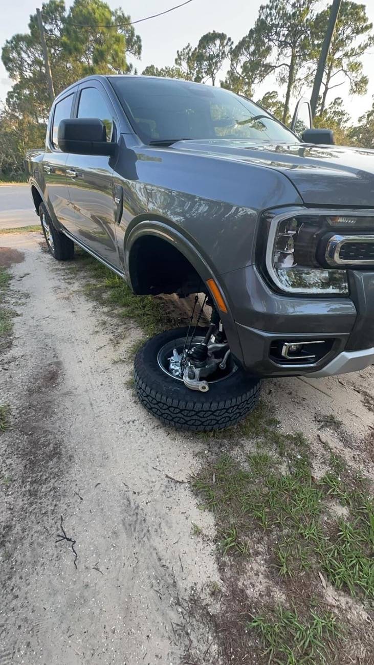

Recall issued. Didn’t see it on my Ford App but it comes up on the Ford website or NHTSA site.
My RR has an August build date.
Better check those ball joints….
Oct 16,2024
Manufacturer Recall Number24S64
NHTSA Recall Number24V770
Recall StatusRecall Incomplete, remedy not yet available
SummarySOME OF THESE VEHICLES MAY HAVE A MISSING OR IMPROPERLY TORQUED NUT ON THE BALL JOINT THAT SECURES THE FRONT UPPER CONTROL ARM TO THE KNUCKLE ASSEMBLY, WHICH CAN RESULT IN SEPARATION OF THE FRONT UPPER CONTROL ARM FROM THE KNUCKLE ASSEMBLY.
Safety RiskSEPARATION OF THE FRONT UPPER CONTROL ARM FROM THE KNUCKLE ASSEMBLY MAY RESULT IN PARTIAL LOSS OF DIRECTIONAL CONTROL WITHOUT WARNING, INCREASING THE RISK OF A CRASH.
RemedyFORD MOTOR COMPANY IS WORKING TO PRODUCE PARTS FOR THIS REPAIR. WHEN PARTS BECOME AVAILABLE, FORD MOTOR COMPANY WILL NOTIFY YOU VIA MAIL TO SCHEDULE A SERVICE APPOINTMENT WITH YOUR DEALER FOR REPAIRS TO BE COMPLETED FREE OF CHARGE PARTS AND LABOR.
