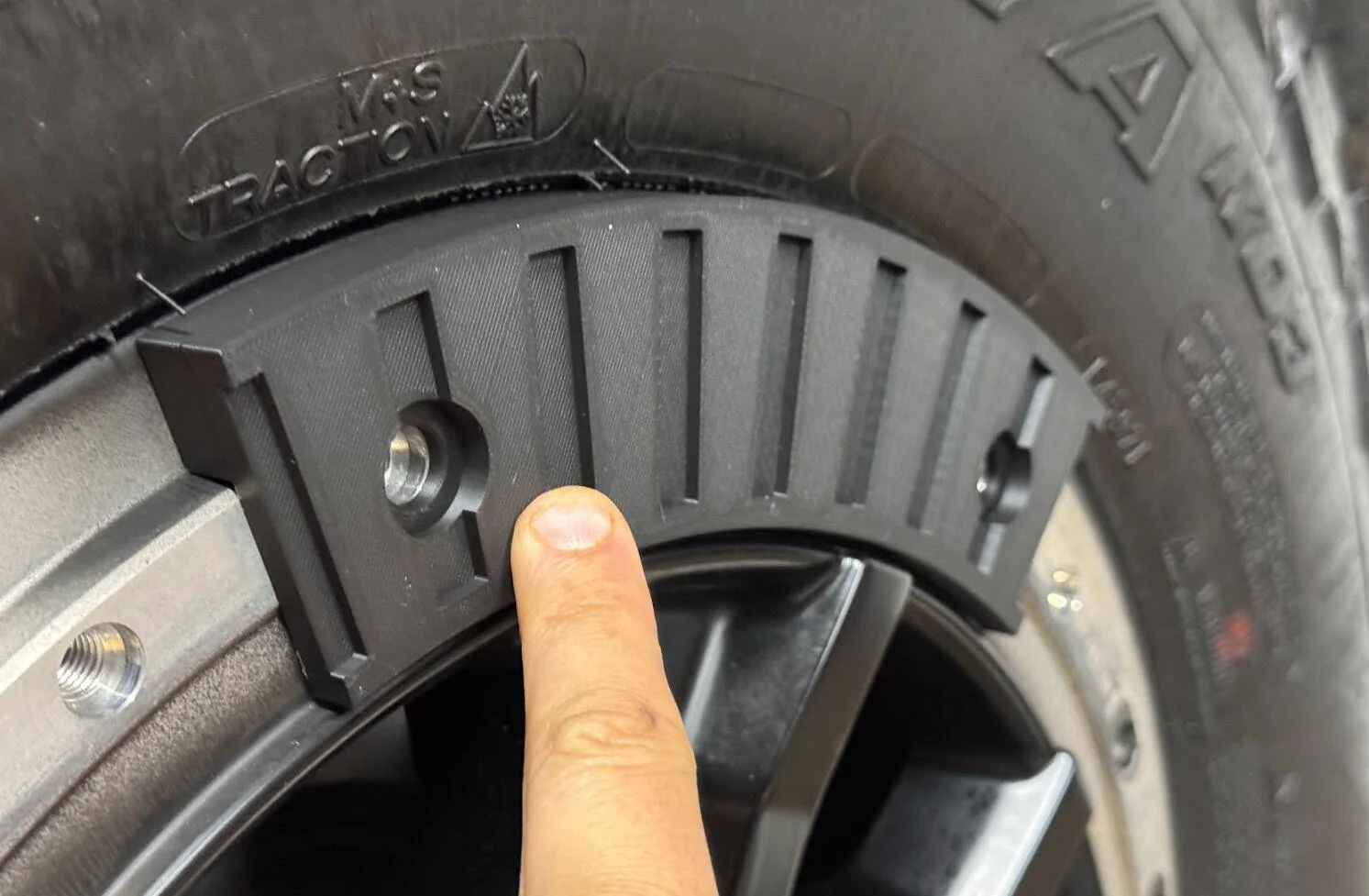

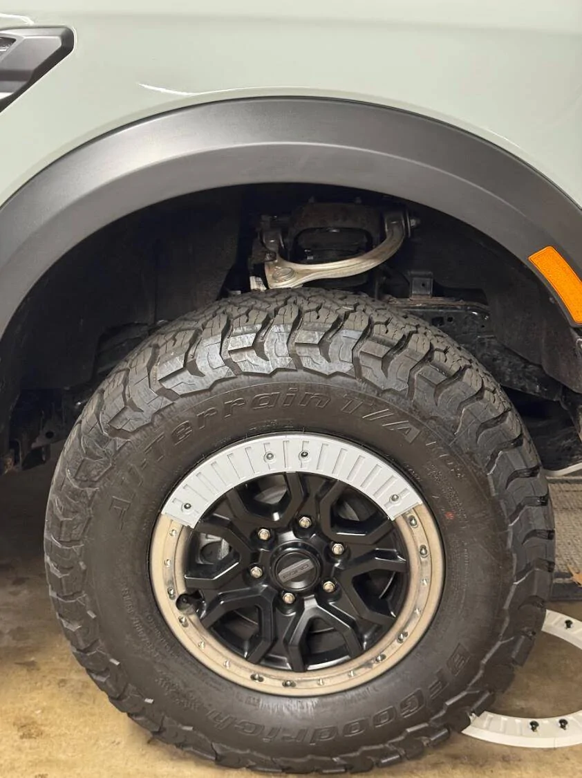

OK guys,
I got the step in, and it sits on the wheel perfectly. Notice this ring is flush with the 'arms' of the wheel.
QUESTION: Do we want the trim ring thicker to prevent scratches? Send feedback.
QUESTION: Do we want to add holes for ALL of the beadlock threads ... it's a lot and will prevent pattern options. Send feedback.
Notice the black is also way off from the wheel. if you want black, you'll have to paint them with a gloss black on your own.
I think I am read to print my first legit ones in ASA for cactus gray, it's 24 of these sections, and each section plus spacer is 1hr 30min, so you'll probably get a pic by Monday morning or so.

Here is a quick update. I think I like them sticking out a bit more. This is how close I can match the cactus gray:

Looks like I ran into an ASA problem. ASA is printed on a much higher bed temp, thus when cooling the parts shrink, I need to do some test prints to accommodate this issue, likely going to be a few days, I'll be back, thx

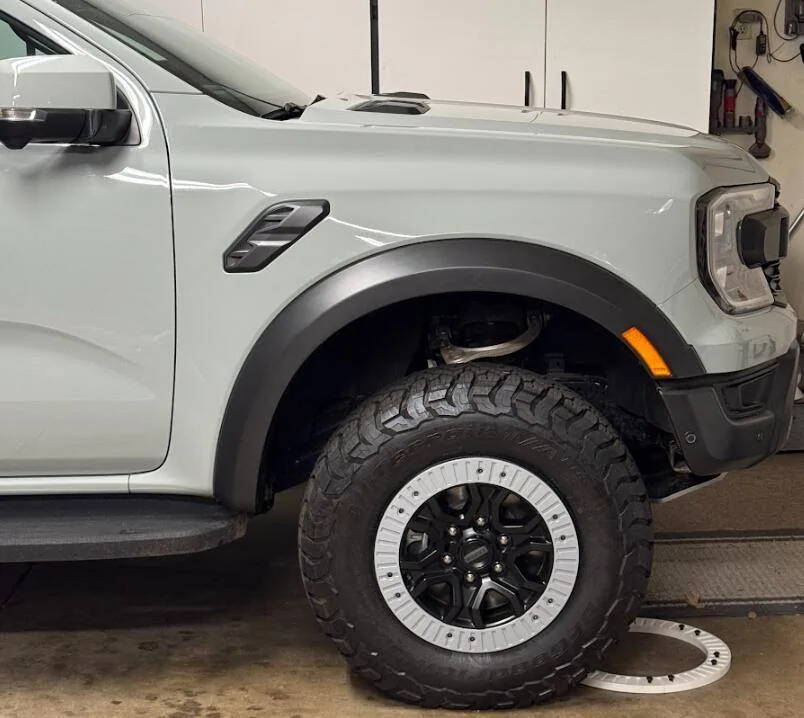

Hey Everyone,
I modeled and 3D printed beadlock wheel trims. You can do almost any color and design pattern you chose with this method.
Here is my first official revision of it. It is in white for cheap/quick printing, but it looks pretty nice.
The cool thing is it is also dirt cheap, about ~$7/wheel or less. AND if you damaged them, who gives a s#!t, you just print another one.

Great job! What are the inside and outside dimensions on your rings? I'm guessing 17" outside but the inner circle? i plan to cut some out of cardboard and spray paint them various colors and stick them on our wheels when the RR arrives so we have an idea what colors to paint the oem's or powder coat.
You need to scale up all the dimensions to “about” 100.8%. There are many size test files, are you using one? That is the most accurate way. You are also going to get warping, that is going to be a lot harder to deal with.
359mm
thanks
https://forum.bambulab.com/t/polymaker-asa-printing-wraping/23488/5
Being creative with a brand new 3d print is lots of hard work, isn’t it?
John Davies
Spokane WA USA
it's not always that exact amount. X and Y can be different due to thermal differences in the chamber. I'll work on it tomorrow.
I measured mine to be off my 1mm in 234mm for the longest dimension on one of the trim segments.
I'll do a test print with different scales shouldn't be too hard to figure out. But yeah as you print more and learn all these little things.

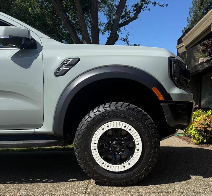

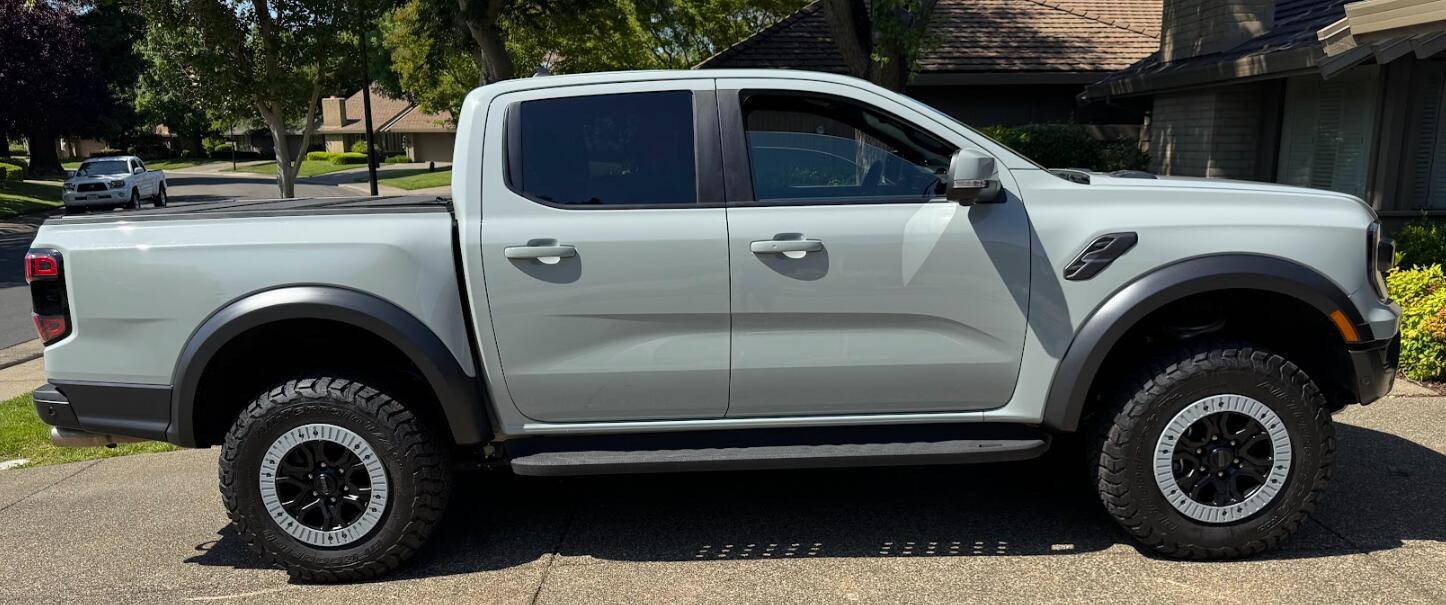

Hey everyone quick update:
- See attached image with my design on it. They fit well and no issues with vibrations or anything.
- Due to workload I cannot commit to printing for people, instead I can share the MCAD files in STEP and you can print them yourselves or send it to a 3D printing house.
- If my workload goes down I can offer to print for a few people.
- Printing total is about 14 hrs per wheel. It's a lot =(
- The design uses 1.68kg of filament, so 2 1kg spools is enough for the rings.
So I am not sure if this is cost effective for everyone, you'd have to check with a 3D printing house. The cool thing is you can totally customize your style/design/pattern/color.
If you know someone who has a 3D printer, you could ask them to do it. It's not a lot of labor for people it's just a lot of time printing.
If you guys message me and need help making a design because you're not able to make your own, let me know and maybe I can help there.
I will share the design files this weekend, in a google drive.
Thanks,
-P
