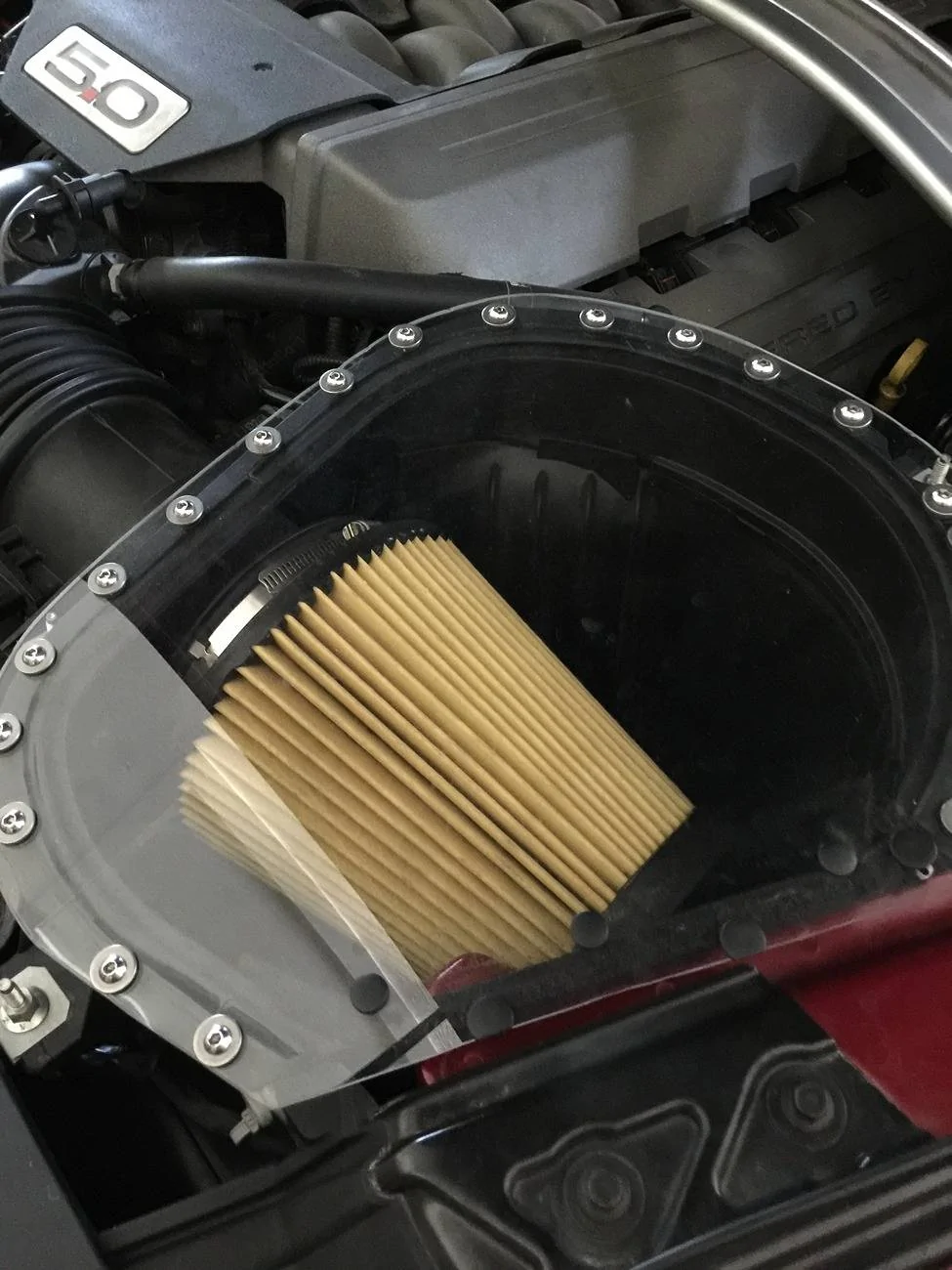

I had customized the GT350 intake box by sealing it off and using an aftermarket ducting up front to make a "true cold air intake" from the radiator high pressure zone at the front of the car. Worked awesome.

BTW, my recommendation is also to NOT EVER use K&N or aftermarket filters. Why? Because most of them allow for higher fine dust contamination, which causes accelerated wear of the upper cylinder. Good way to lose compression by 100k. Also testing has shown that while they do flow better, those filters also have 1/3 the dust capacity. So once they clog, they MORE restrictive. So if you go for say 25k miles between changes, for 2/3 of that your making less power than an OE.
The better solution I found on the mustangs was...USE A BIGGER PAPER FILTER. So, you increase dust capacity and reduce flow restriction while maintaining filtration. That's what Ford did with the GT350's. If it's a track only vehicle on-road, I do think K&N's make sense, because it's low dust, low mileage and you can clean it after a few track days, so it may be worth it for those applications, but for daily or trucks? No thanks, I'll stick with OE because I want my rings to maintain seal still at 200k.
