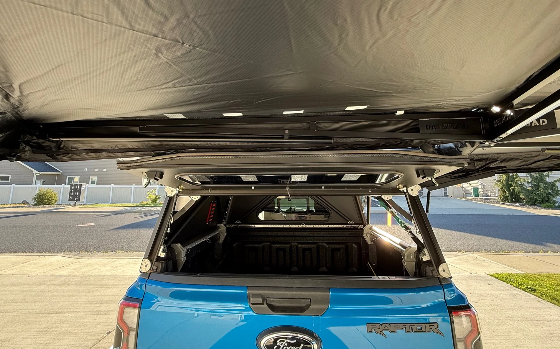

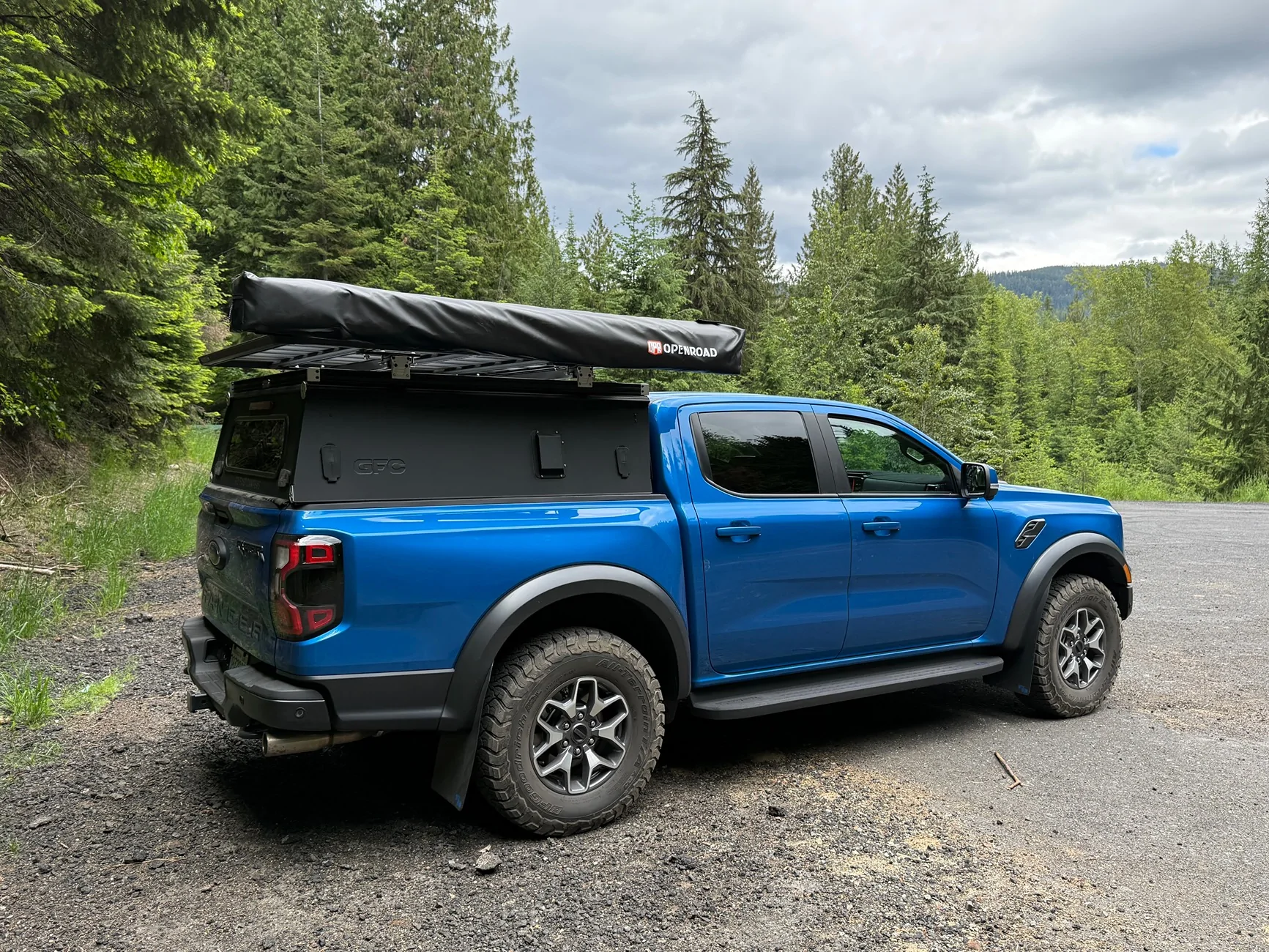

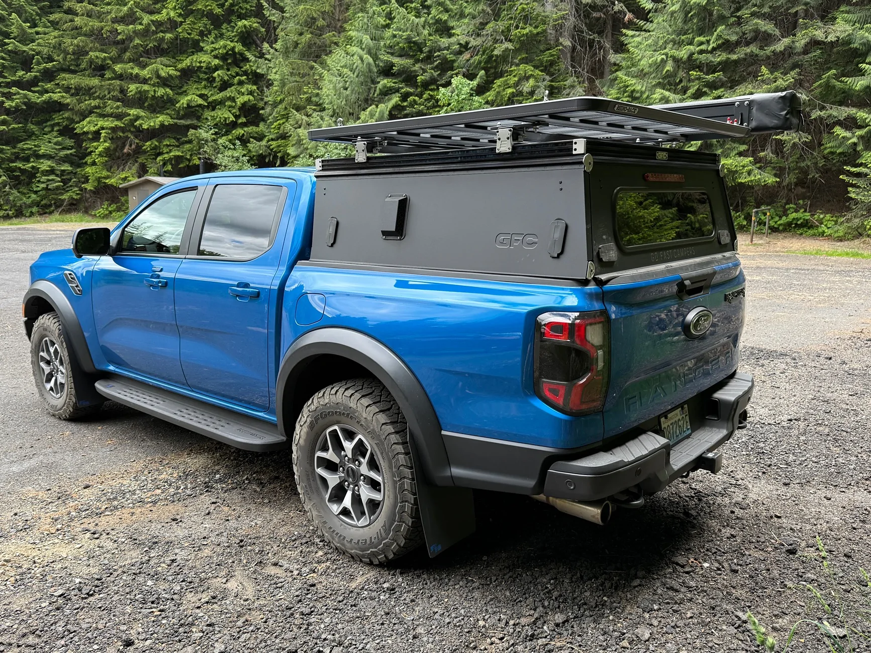

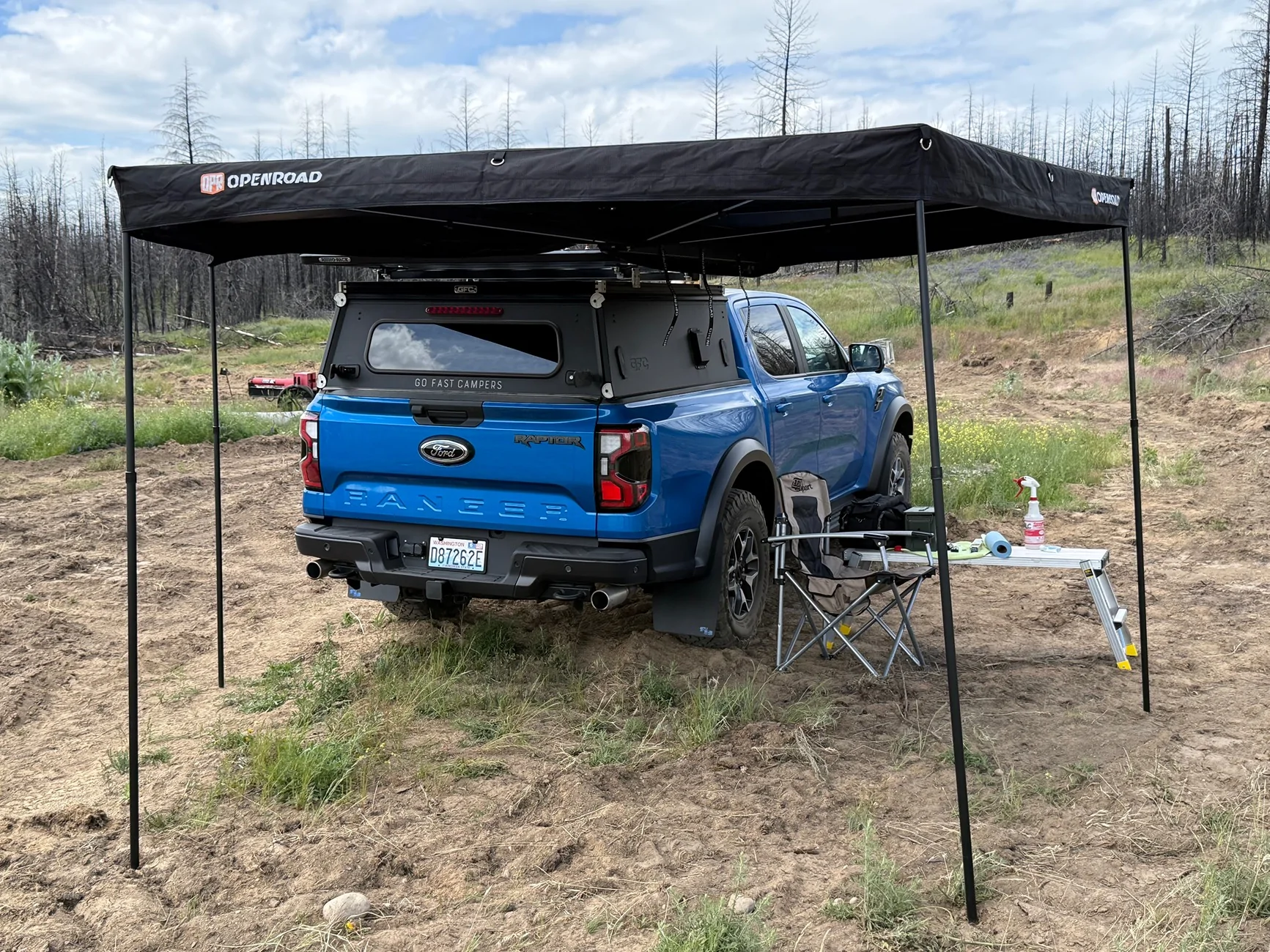

It all works well together, with minimal wind noise and no measurable decrease in mpgs.

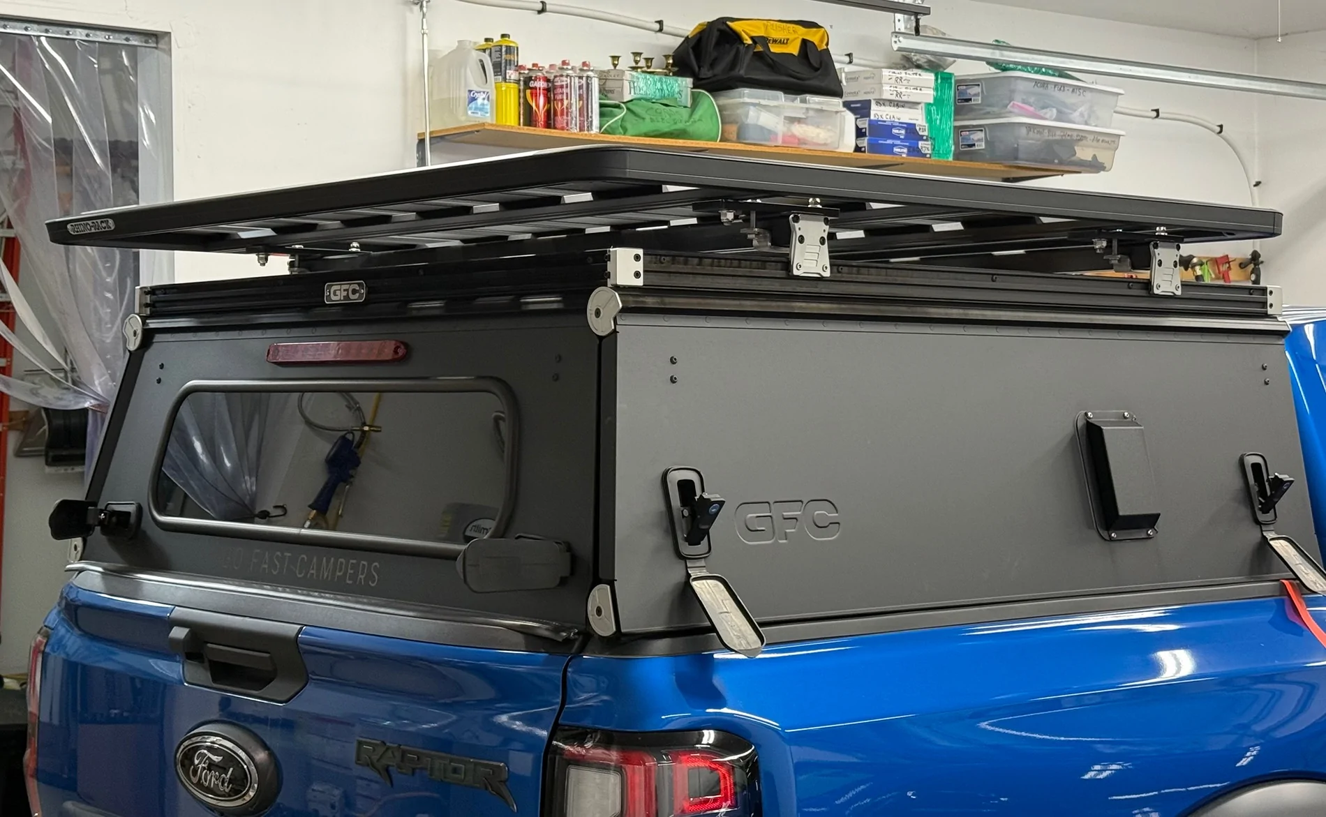

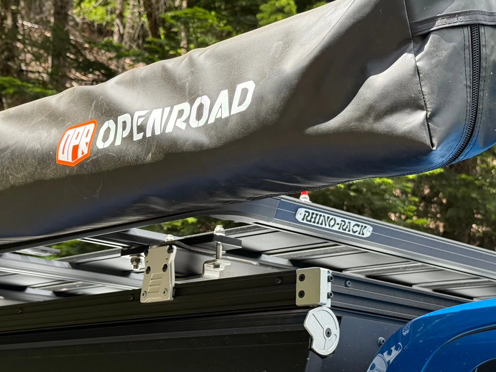

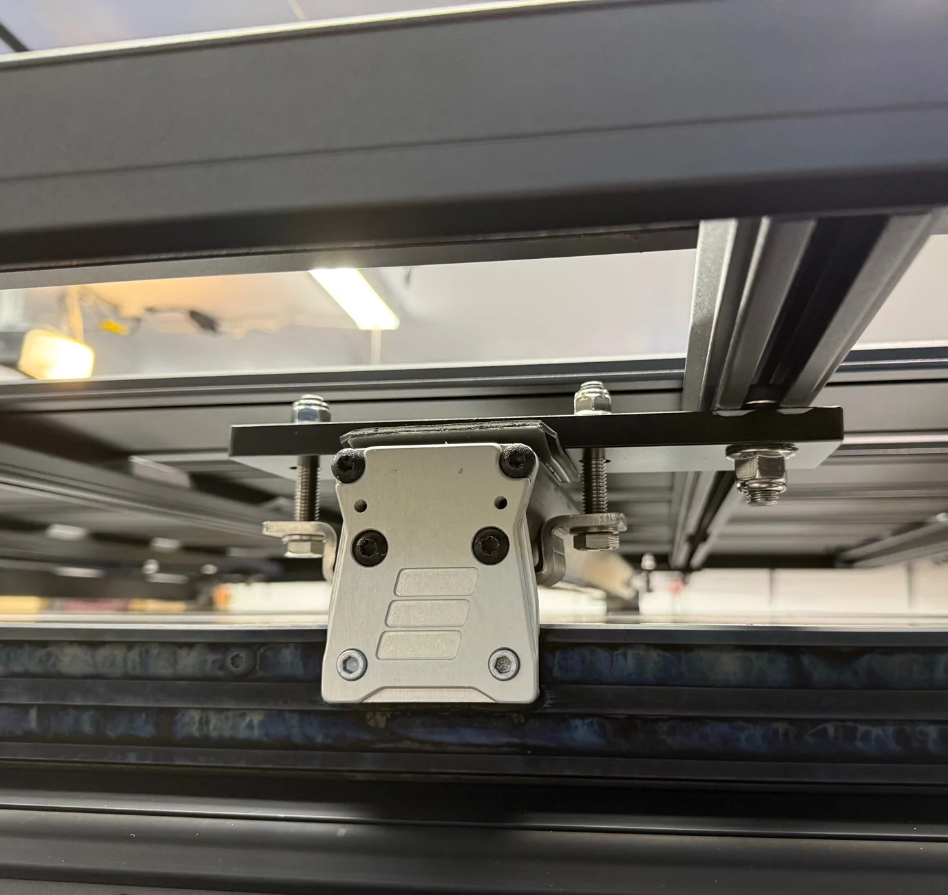

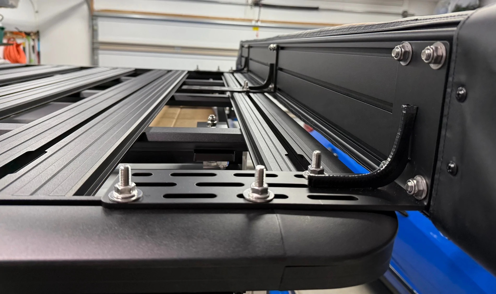

Custom mounts using the factory GFC Beef Bars (rated 200 pounds each) and Billie Bars heavy duty stainless u-clamps. The rack and awning can lift off as a unit with my ceiling hoist, after unfastening the four big 12mm hex nuts, leaving the mounts attached to the crossbars.
