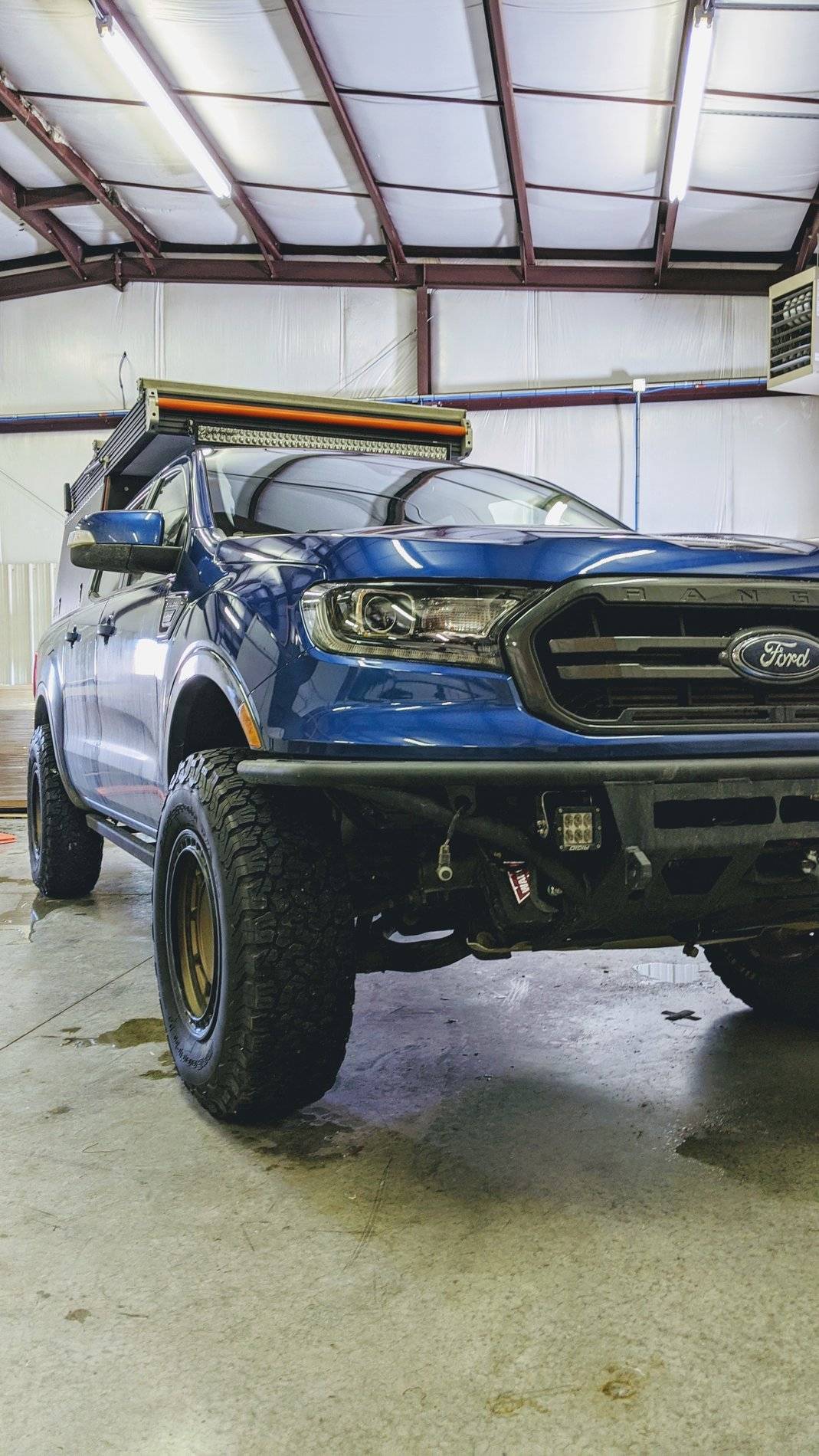

I wanted to share some initial images of my project Ranger, and share details of it. Hopefully this thread can serve as a home for discussion and suggestions, separate from our coverage of the vehicle.
Base vehicle: 2019 Ford Ranger SuperCrew Lariat FX4
Suspension: Icon Stage 2 w/billet upper control arms
Wheels: Fifteen52 Traverse HD 17x8.5 0 offset
Tires: 34x10.5-17 BFG K02s (fifth fits in stock location on factory spare rim)
Camper: Go Fast Campers
I'm also planning bumpers, sliders, lights, and a winch. I'll detail my solar/fridge/battery setup in another post in this thread. It gives me the ability have a large fridge/freezer running constantly, without cutting up the trucks' wiring harness, or relying on it for power at all.
The general idea here is to create the ultimate practical adventure vehicle. I wanted to start with a vehicle that balanced off-road capability with on-road manners, then take that capability to the next level without sacrificing either those manners, or its day to day practicality as a truck. I'm not an overlander who wants to build a truck just for car camping, I'm someone who needs a truck that can support a diverse array of outdoor activities and video shoots, and also just mundane tasks like hauling a thousand pounds of mulch home from Lowe's.
What say you so far?
Beautiful ride man! Many of us are dying to know how you fit 34" tires in the front wheel openings. Just the ICON kit? Crash bars removed, cut, replaced? - inquiring minds want to know. :like:
Yeah, had to cut those silly crash bars off with a grinding wheel. Other than that, it's just Icon Stage 2, plus the wheels with more offset. Rubs a tiny bit on the felt arch liners at full lock while reversing, but nothing to worry about at all.

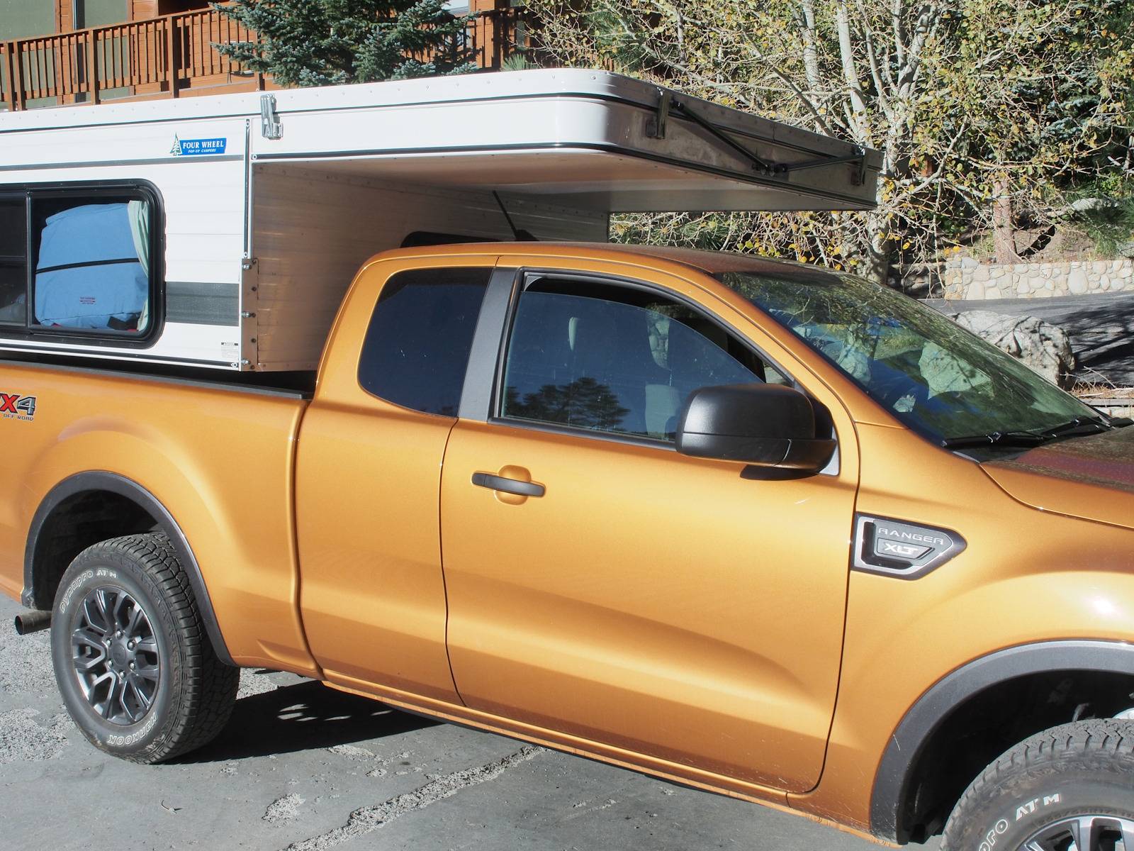

There's about two more inches of height between cab top and tent bottom than there should be. Mine was the first unit GFC made for the Ranger and there was a small error. It'll be corrected for production units. Honestly, I'm not mad at it either. Wind noise is there if you listen for it, but by no means intrusive. The awning we put on last night creates way more noise, and even that's not bad. Plus, I'm 6'2", and the extra height in the shell means I don't bump my head on the open panels or have to duck to stand under the awning. And that gap isn't really noticeable in person.

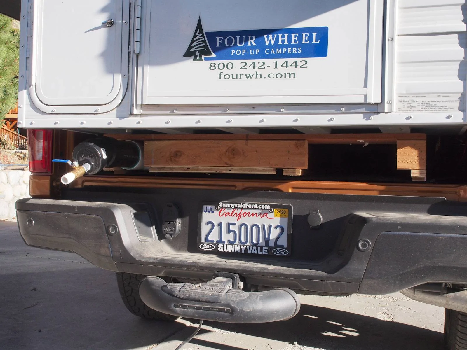

That gap is actually pretty tame! I'm in the process of adapting a 4WC camper that was made for our old Ranger to the new one. There are some small issues, like the tailgate catches have to come off for it to fit, but the biggest issue so far is that the new Ranger's box sides are so freakin' high compared to the old Ranger. Unlike the GFC, the 4WC overhangs the bed sides, and I've had to build a 4" high platform for the camper to sit on for the overhangs to clear the top of the bed sides.
It's all working so far, but the bed-to-cab-top distance didn't change much compared to the old Ranger, so now the cab-over is in the clouds! It's not on right now but the gap is probably 6-8" or so. Not sure yet what to do about it. I might try to build some sort of extension below the cab-over that could fill that gap and double as storage for lightweight items, but it would be a big project to make it look good. I'll probably just be putting up with it for a while. The only silver lining is that there is now room below the camper to build a modest gray water tank, and I might even be able to have the antenna on the truck, but I didn't actually try yet.

How's this for a gap ;) I'll have to put up with it short of trading in the camper. The problem is that it needs to be lifted so much to clear the higher sides of the 2019 compared to old Rangers.
