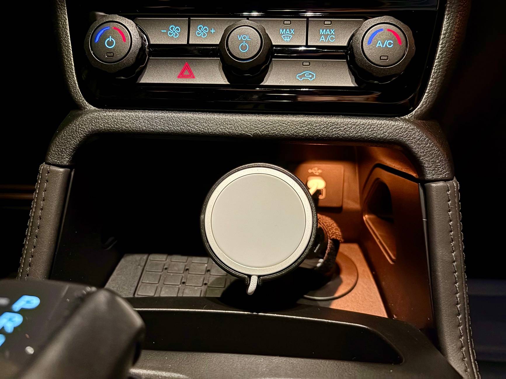

please send pics of your installation

Ford Ranger Phone charger IMG_0400
Ram Mount - RAM Flex adhesive double ball mount for Apple 25W MagSafe (15W option available too). I place the phone landscape orientation, and the angle matches the opening and the phone is easy to place/remove. Velcro used on the coiled excess cable length of the charger (1m). Rubber pad for this area removed. Pulled fuse for Qi pad so I can toss anything I want back there.
