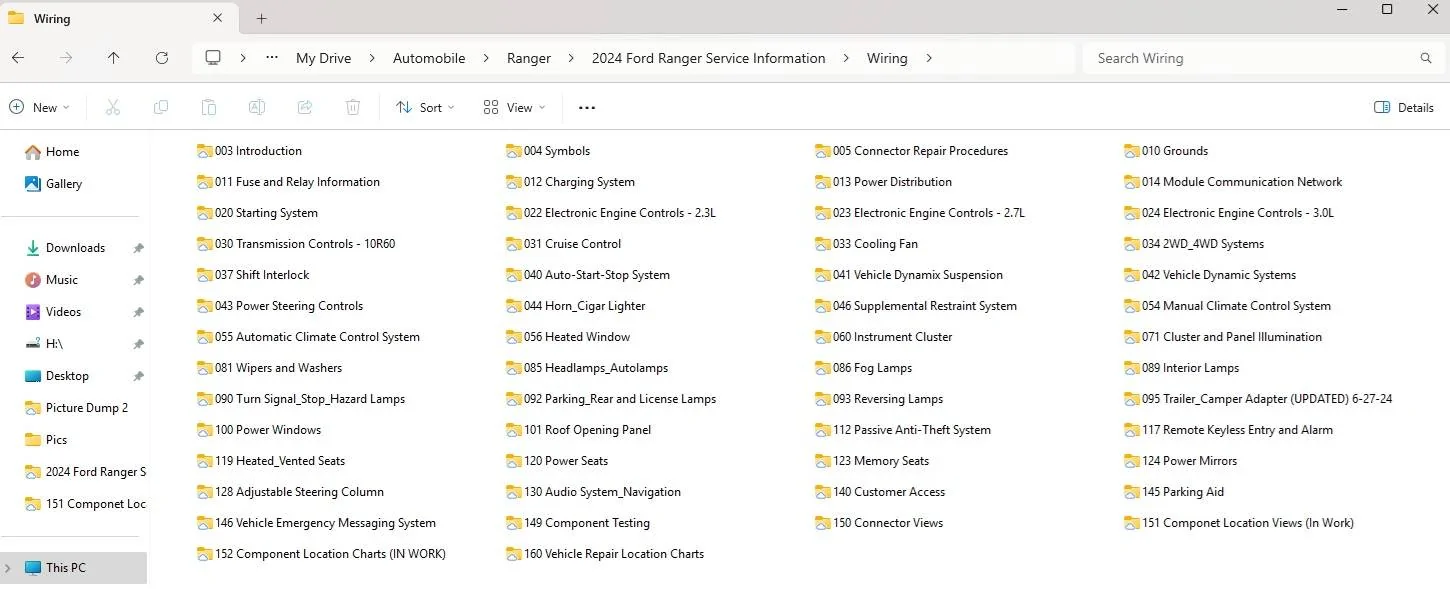

Hootbro, where can I get the wiring diagrams that you have? Are they part of the Ford service subscription as I've been thinking about looking at this but I don't really know what we get for our money.

I got mine from the Ford Subscription Service. I downloaded the full wiring diagram suite for the 2024 North American model Rangers. Currently working to get it into a workable collection that I will probably share at a later date on a Google Drive or similar. I had to do a lot of print to PDF and cleaning up those PDF's that is taking some time. It will include both the wiring diagrams and connector pinout sheets. It will also only be for the North American Petrol models and no Diesel models since they are not offered here.

You get the full service info that the dealership techs get. A simple 3 day ($26 USD) subscription will allow you to get plenty of info. Besides the wiring diagrams, I print to PDF quite a bit of the major service instructions work that I would ever expect to deal with in my vehicles lifetime. Anything I missed in the future, still way cheaper to get a 3 day subscription to get that info than waste stabbing in the dark trying to figure out or pay a dealership shop rate.
