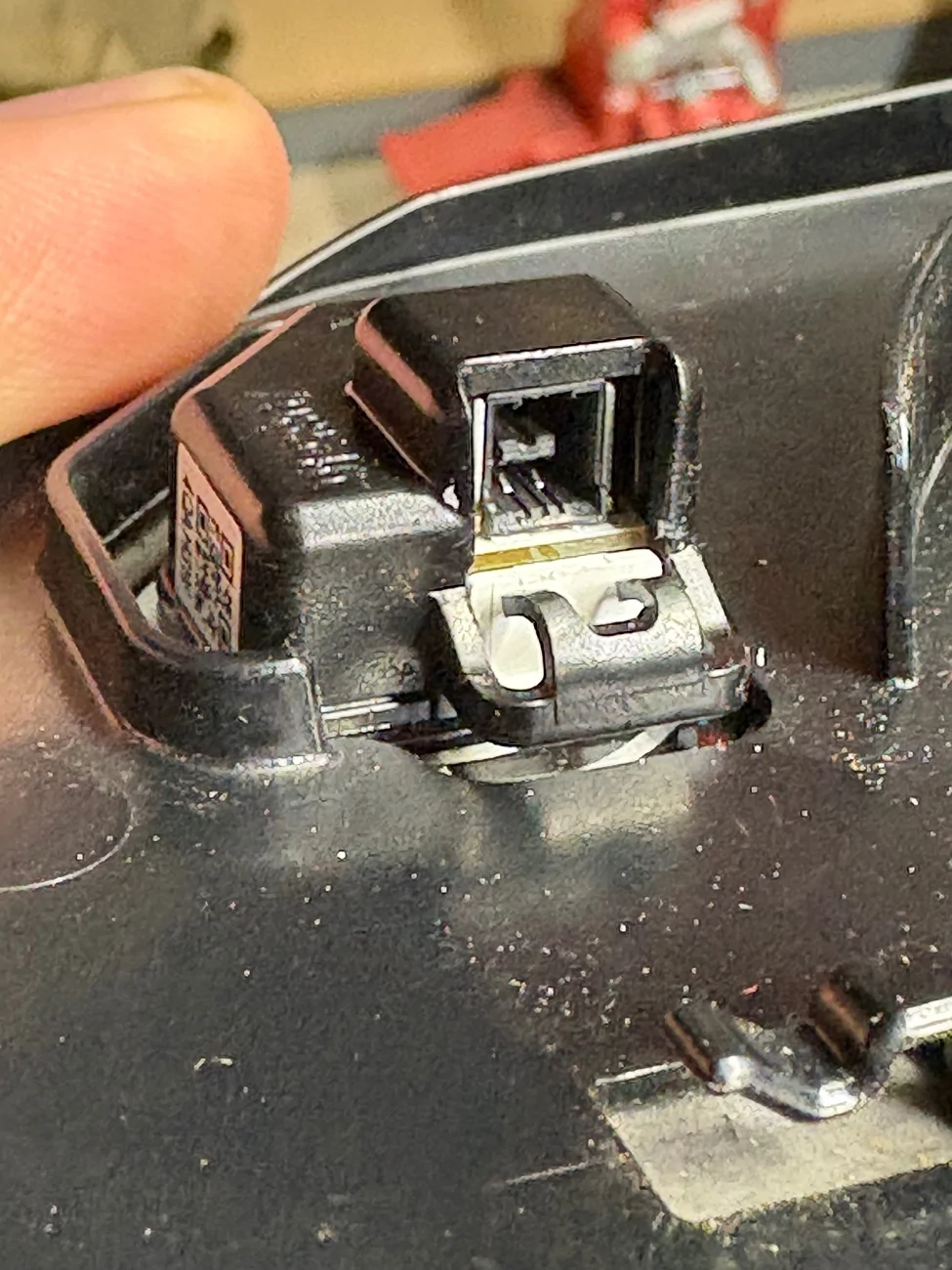

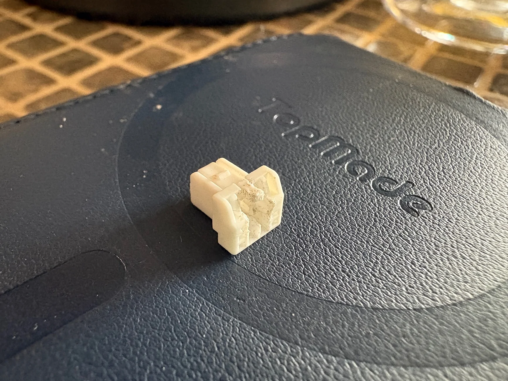

A bird flew into my passenger mirror while I was cruising at 75. Didn’t break the housing but did put multiple cracks in the mirror and tore up the plastic attachment plate where the mirror connects to the motor. Replaced both and it’s great… except one little part that goes to internal wiring. This piece got popped off two wires:
Ford Ranger Please Help me identify a wiring part for my passenger mirror IMG_0370
It plugged into the back of the mirror here:

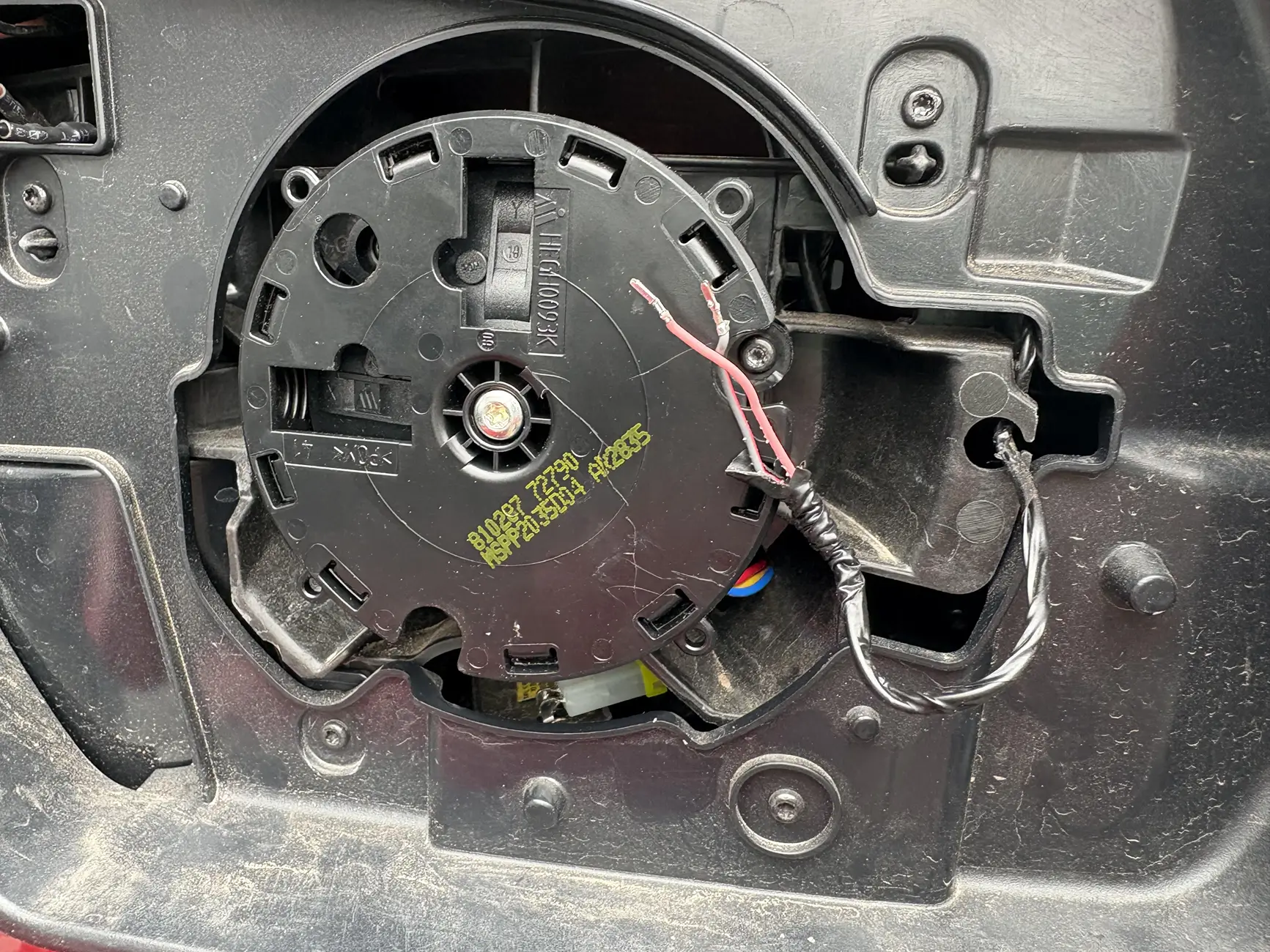

And is these two wires here shown hover above the cener plate:
Ford Ranger Please Help me identify a wiring part for my passenger mirror 1783892802660-e1
I keep generating Blind Spot errors and sensor detection issues soI assume it's the BLIS LED, which lines up from the other side of the mirror. But as hard as I search I cannot find a matching connector or pigtail replacement. I'm not very good at pinning connectors, so I kind of hope that there is a premade pigtail I can splice in. If not, I would gladly pay one of y'all who is good at this to wire a connector.

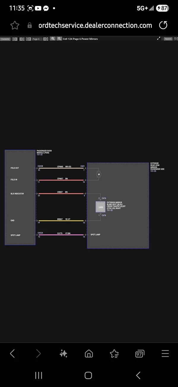

should have the pin hole numbers on the plug. however might need to get new pins for connector C676 if cant salvage the pins in the plug to splice back in. might get lucky and might be able to open the pin up if its stamp formed.
Ford Ranger Please Help me identify a wiring part for my passenger mirror Screenshot_20250515_113518_Samsung Internet
