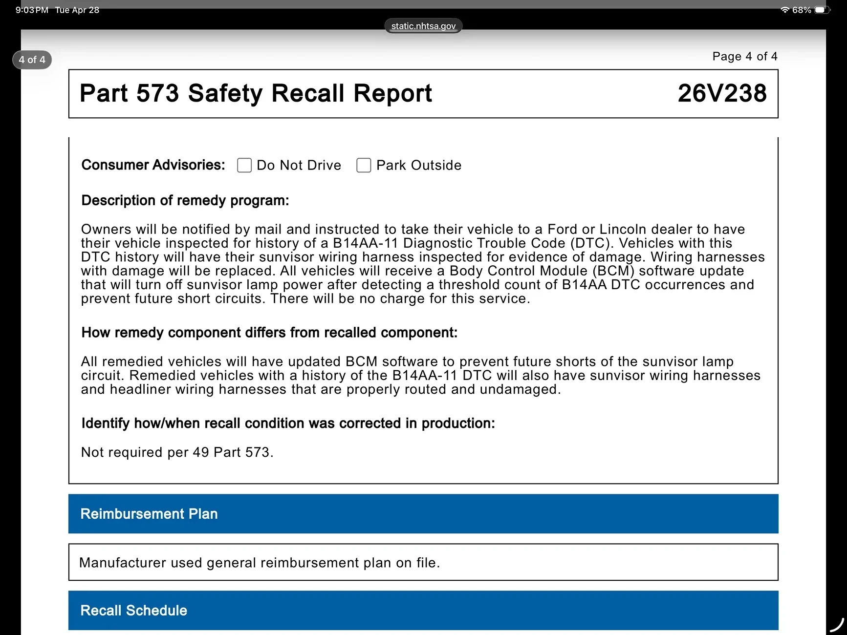

EXACTLY! All I am saying is try it... turn down the radio and at speeds over 45mph. It crackles in the headliner area - could be from the visor, who knows.
jimmymoped
Jimmy
Jun 30, 2025
Waterloo
2025 Ranger Lariat
teacher
I read no such advisory. The park outside box is not checked.
https://static.nhtsa.gov/odi/rcl/2026/RCLRPT-26V238-6269.pdf
"Ford Ranger stop-sale in the US, no impact for AustraliaFord has issued stop-sale orders and recalls for 2024–2026 Ford Ranger trucks due to serious safety issues. Key recalls include over 100,000 units for side curtain airbag failures (25C41/25V541) and over 140,000 units for fire risks linked to wiring faults in the A-pillar (26Sxx). Owners are advised to park outside and contact a dealer"
I read this on the Australian forum... it is for the US does not affect them. If it starts a fire, I would rather not burn my house down... do what you will.

Ii did find some news outlets saying don’t park inside. They seem to be misreading the NHTSA bulletin. I agree it is confusing.
but I can’t find a single place ford or the NHTSA say park outside.
if you feel safer with your truck outside, that is where it should be.
