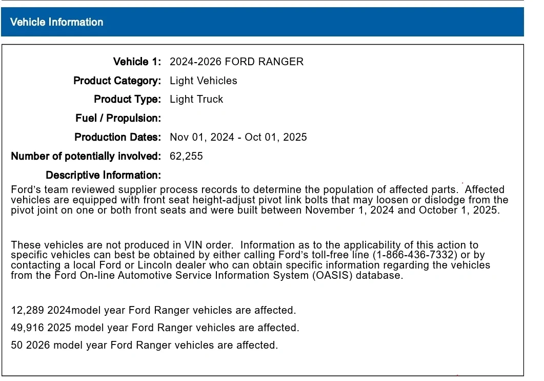

:LOL: I visited my ford dealer for an oil change and I've just found out I have another recall . I didnt even know about! Thats 3 recalls in 6 months. The latest was just sent out today
2026-05-01
Manufacturer Safety recall issued
NHTSA: #AWAITING
Recall: #26S30 FRONT SEAT HEIGHT-ADJUST PIVOT BOLT AND LINK INSPECTION
Status: Remedy Not Yet Available
Locate an authorized or call 866-436-7332 to obtain more information

The dates and model years make no sense.
I think both my 25 RRs were built after that. I don’t think 2026 Job 1 happened till early Jan 2026.
How the recall effected 50 2026 model yet the cutoff of the recall was 2 month prior to 2026 production starting. 🤷‍♂️
Ford will most likely end up expanding the recall. This recall is the exactly same as 25SB5 (NHTSA 25V721) to address a population of vehicles produced from 2020 to 2022 with front seat pivot bolts that may be loose. It's a production line issue versus being a supplier quality issue. My understanding is that a locking compound is applied to the pivot bolts, but in some cases the bolts were installed before the locking compound had fully cured resulting in it not holding properly. Supposedly this only affects a very limited number of vehicles, but since they don't know which bolts went where, they are required to inspect all of the potential vehicles. And Broncos got the same recall as Rangers.
