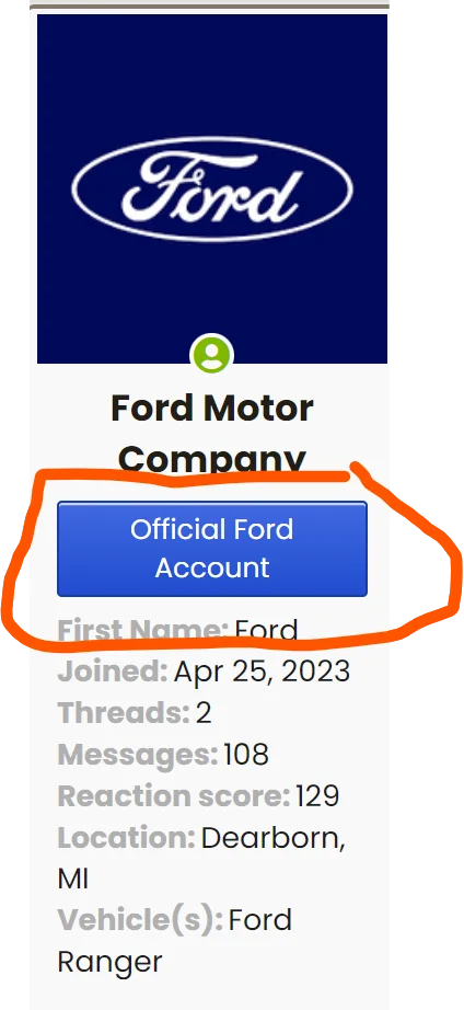

Update on this. Got a message from the Ford Social Media person on here. Just wondering if it’s legitimate. Asking for vin etc. I’m new here so I don’t want to give a bunch of info unless it’s legit obviously. Anyone have experience with that?
T-Rev
Jun 2, 2023
318
287
Is it from this account? If yes, it's legit. Rai helped with opening a case for my QC concerns and Ford has already contacted me. Have a dealer appt setup for next week that they will work with the dealer on.
